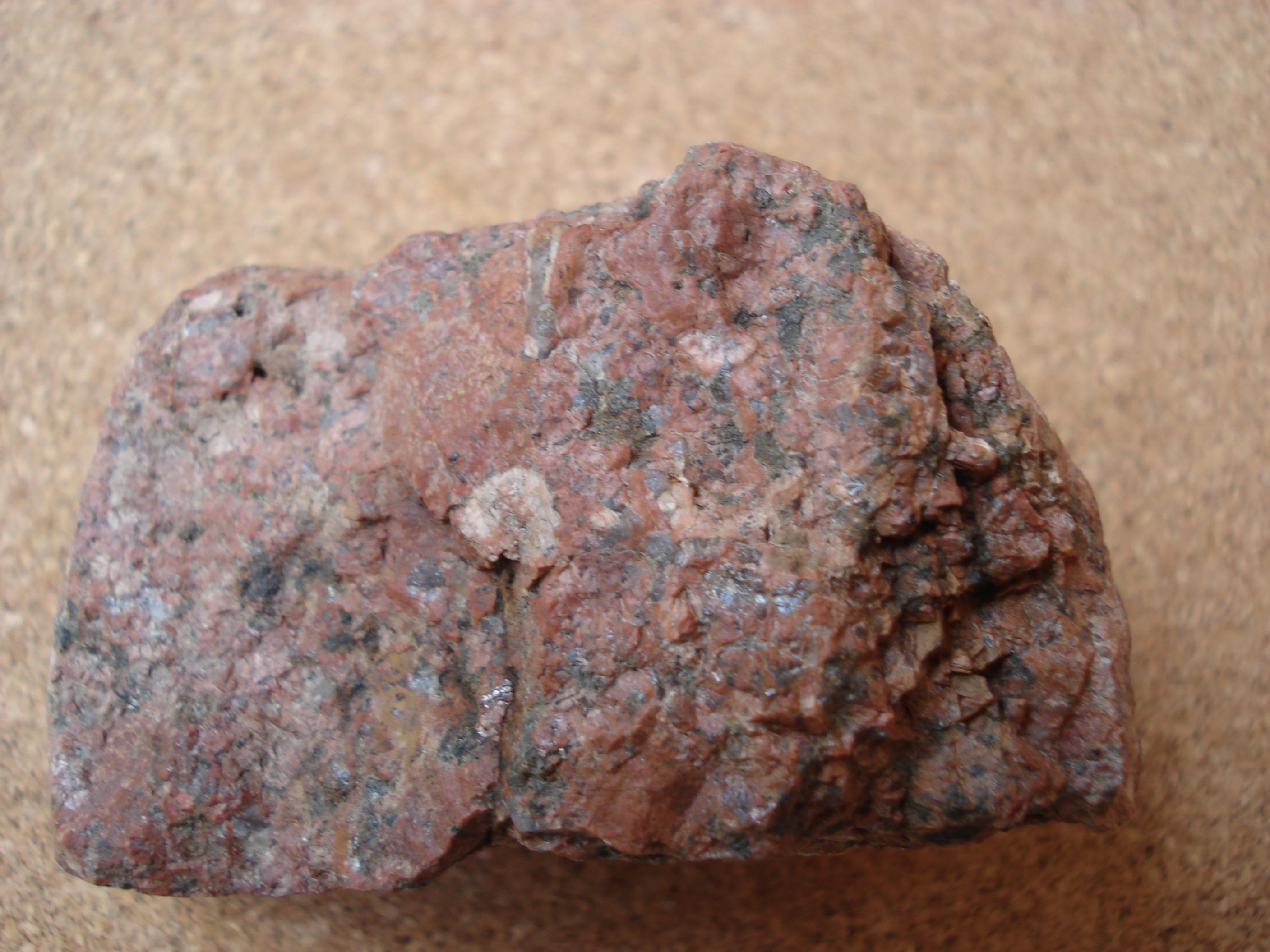

  • very nice video and VDI, could you show a picture of the magnetic stones that gives you +84? how do you shift X and Y by 90 degrees to see what the effect of the shifting is? SW3 only works when the vdi is idle, i.e. it won't work when it is busy e.g. near a target, and the backlight is only on for 0 < VDI < upper_limit i.e. all negative values are discarded in the firmware unless there is some interest of turning the backlight on for negative values... however it can be implemented since there is now plenty of space.
    I can upload a LCD firmware for the PIC18F25K22 if you already have the pcb to test if it works like the one you have with PIC16F886 and if so then test a glcd version (you can reuse the same pcb)...
    • photo of a stone that gives +84 reading ... it's easy to distinguish them from typical finds in static mode with zero ground is eliminated

      • I have some questions about the stone, do you know what mineral this rock has? does it act as a magnet when you approach a small piece of iron? and what is the VDI value you have for a silver and/or an aluminum coin?

          • I do not know what a stone is, what a mineral, but a strong magnet attracts it very poorly

                      • ok very good, I think this might be related to your modification of the shifting of XY channels by 90 degrees which I don't understand, I get the same vdi value (+86) with a silver coin of 34mm diameter and 2mm thickness as the stone you showed
