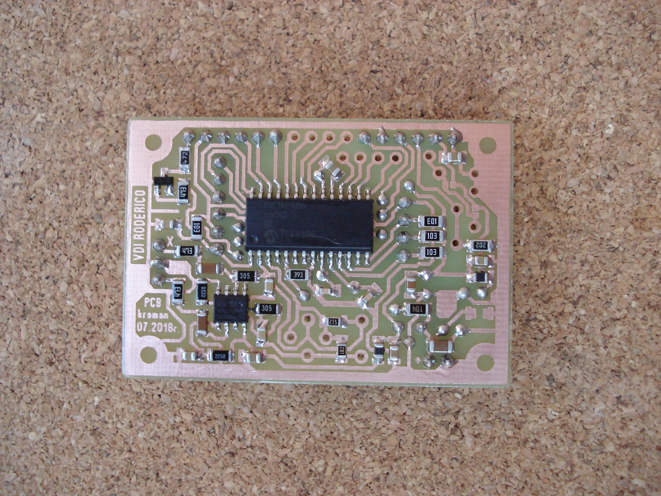

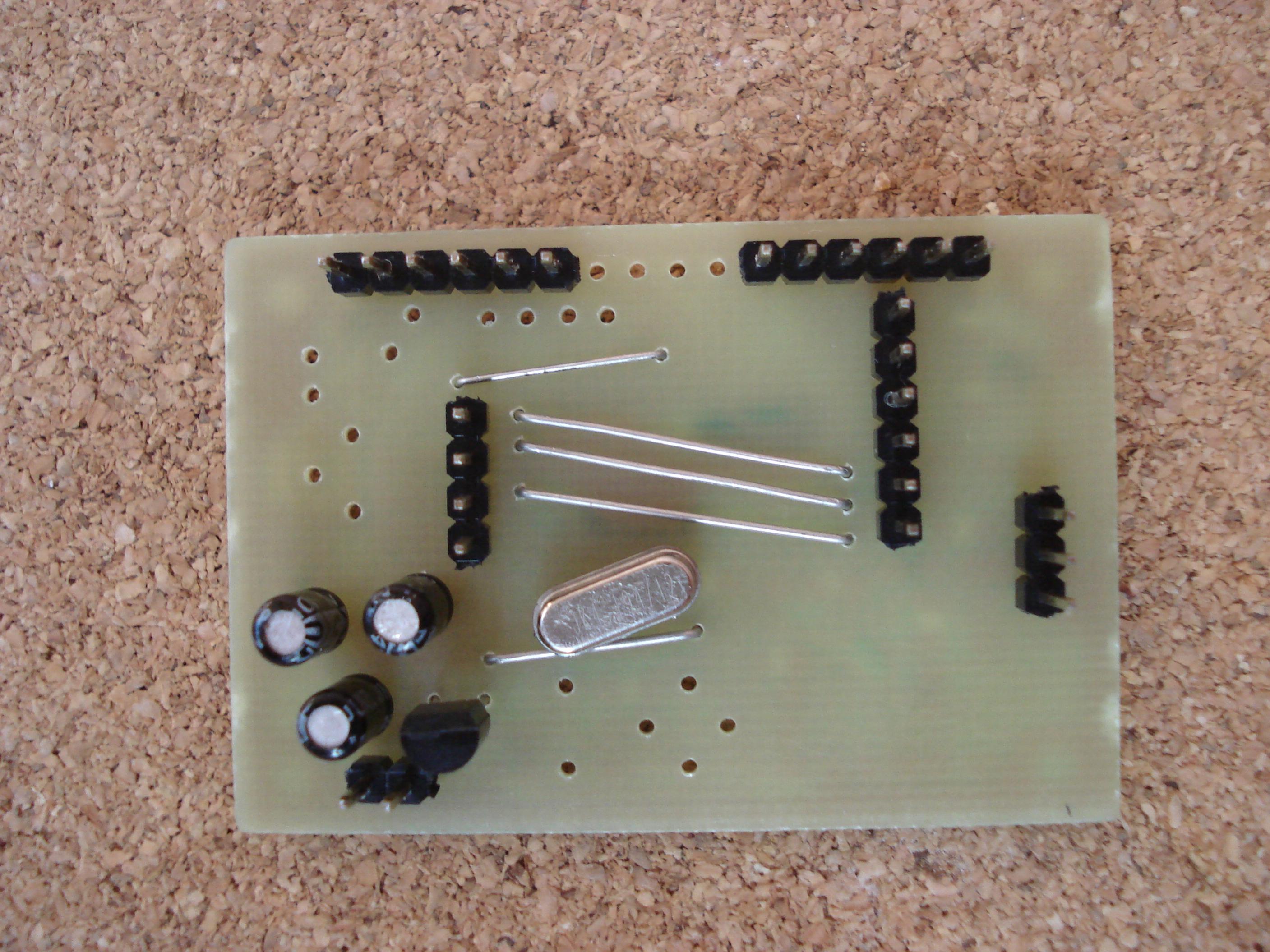

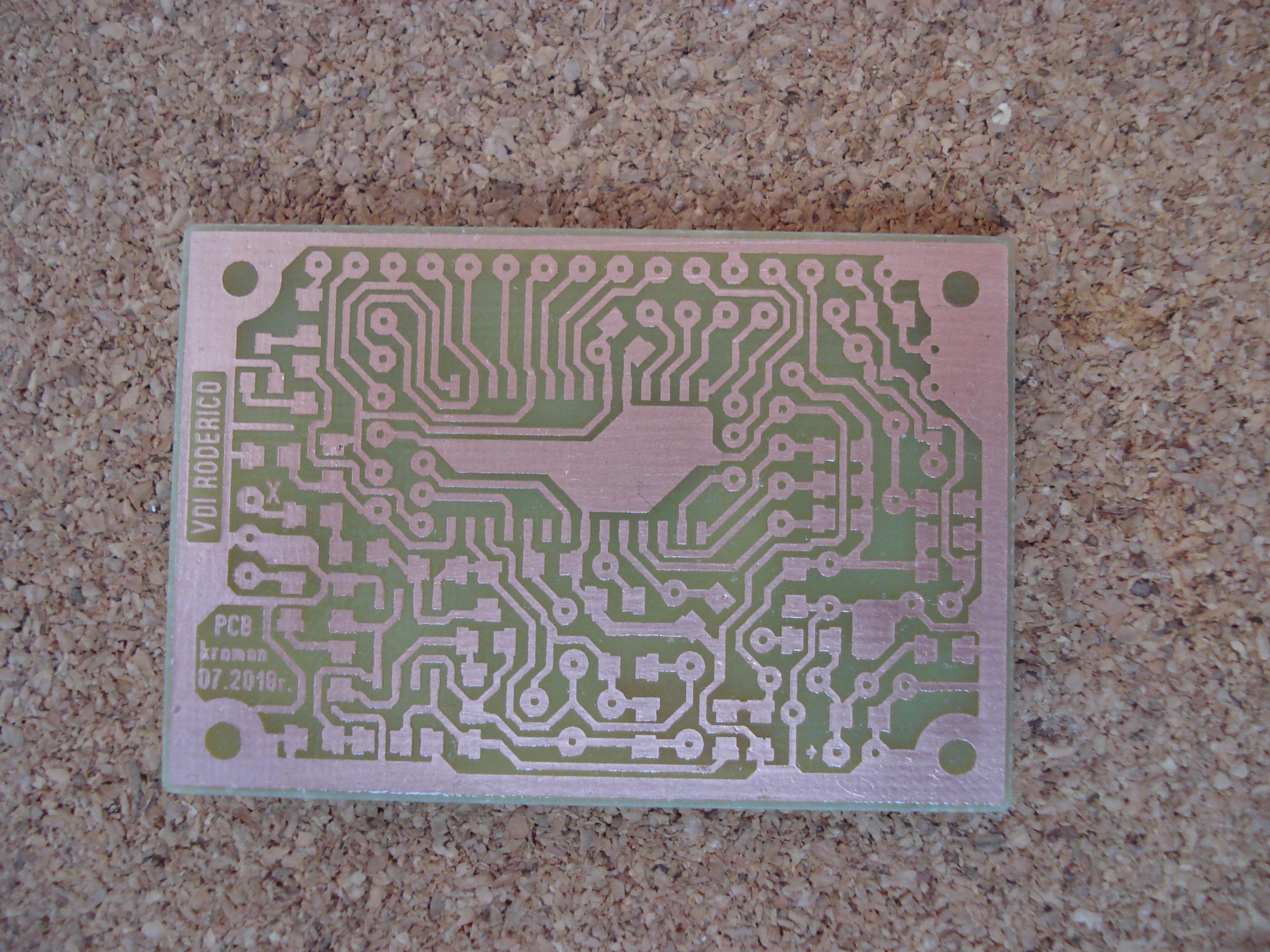

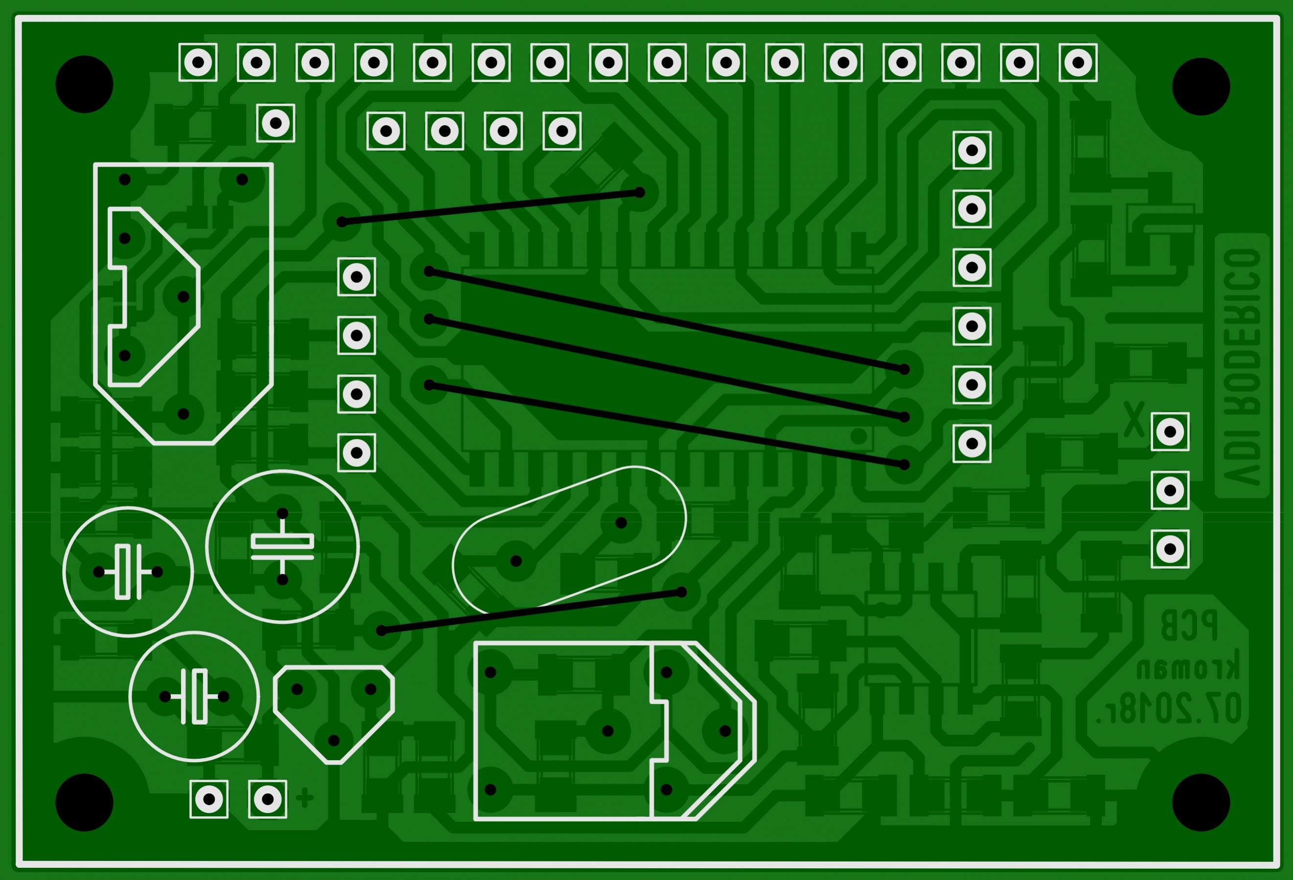

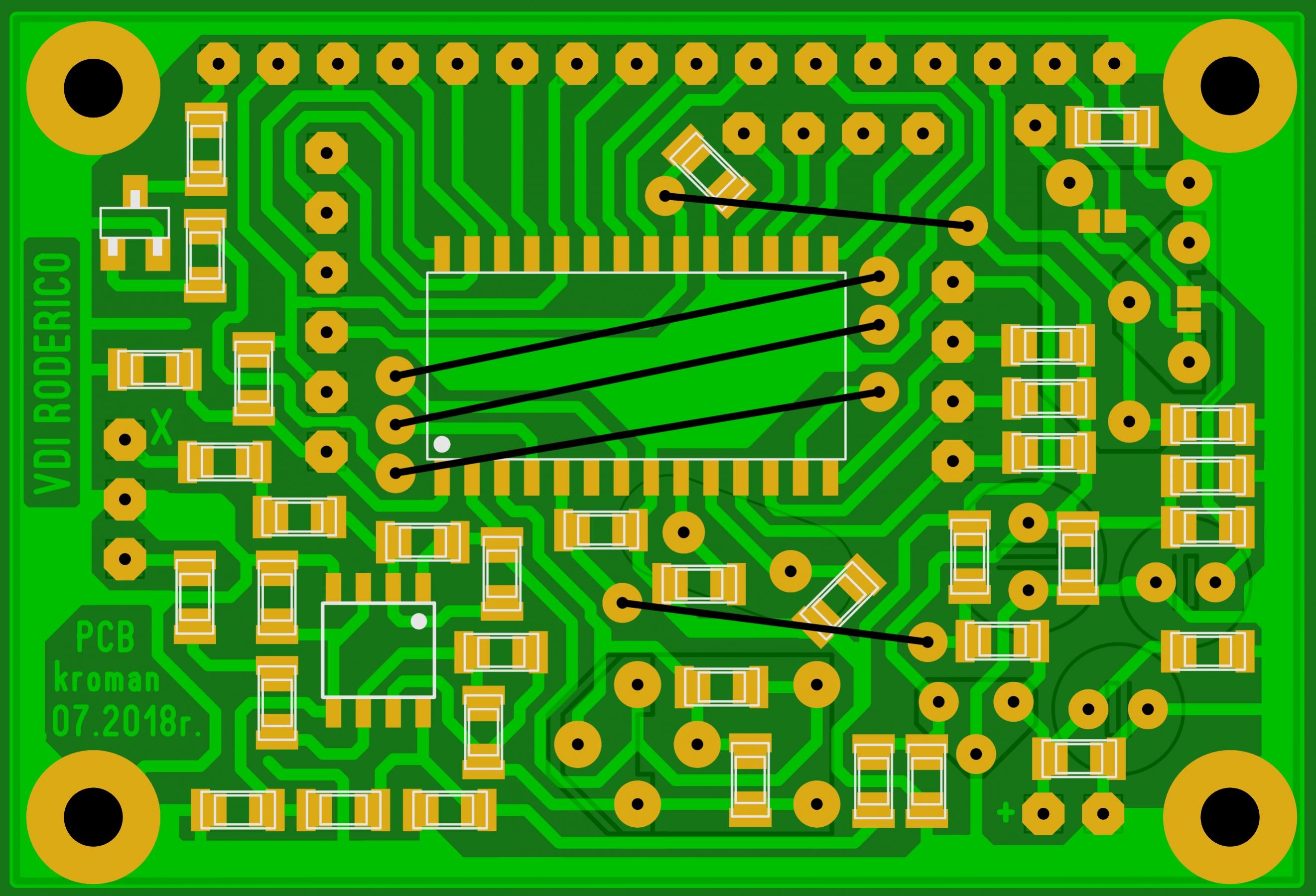

            • I will program it again ... this is what my PCB looks likeClick image for larger version

              • I programmed again using PICKIT3 and MPLAB IPE as well as JDM and WinPICPgm and each time the same ... you can see that it runs, but the lack of content on the screen I designed PCB based on the scheme may be an error in the diagram
                • very nice pcb, I guess the problem is related to the lcd connections (e.g. lcd contrast), you don't have any measurements in the external oscillator because it is not used (you could have saved the components but it won't stop the vdi for working), would it be possible for you to attach an image like VDI.jpg or VDI_.jpg but with the components labels, i.e. R1, R2, etc for an easier comparison with the schematics?

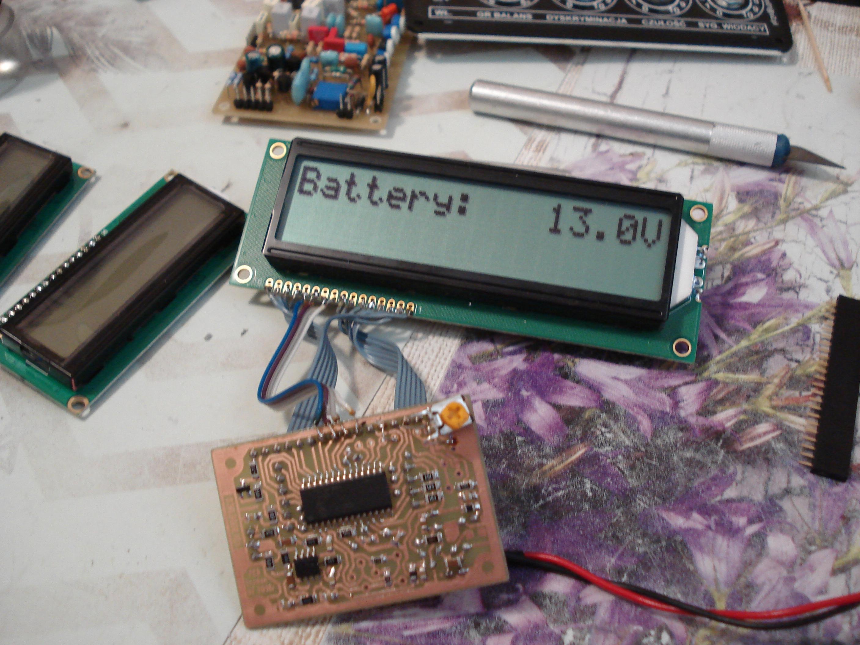

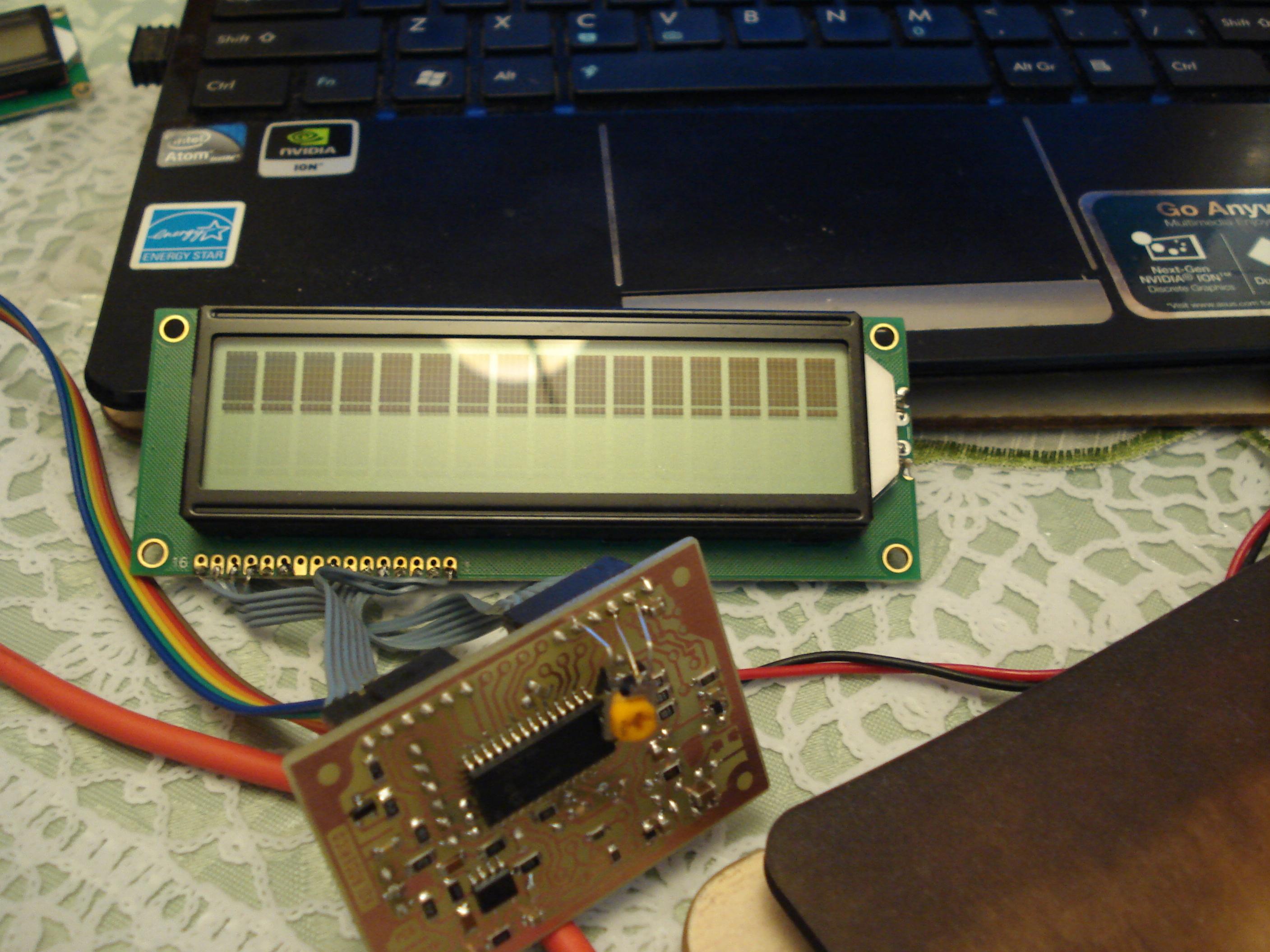

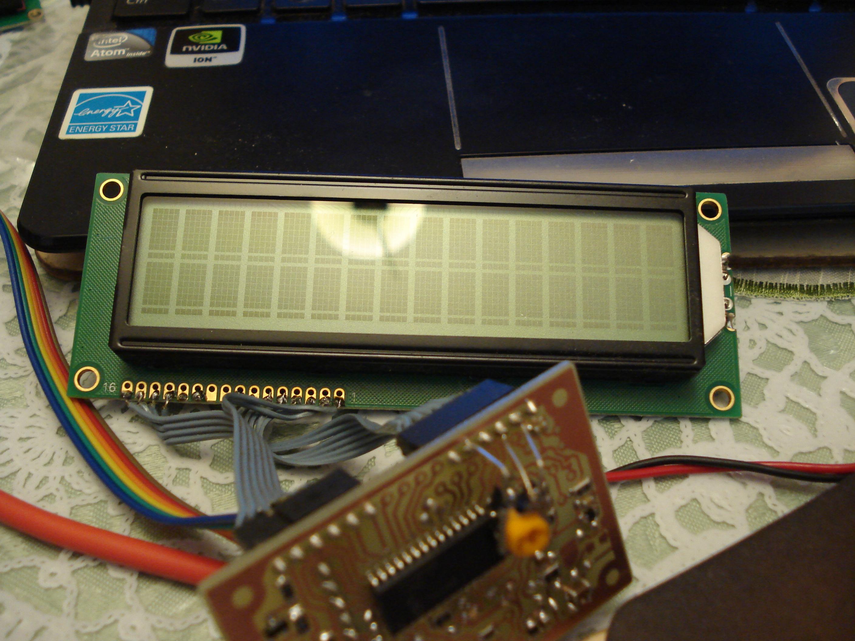

                  • LCDs that I have do not require RT1 enough one 2k resistor to GND .. but I connected RT1 to the contrast on the pins .. this display worked well with previous VDI on PIC16F690 .. on the pictures you can see when PIC16F886 clean and programmedClick image for larger version
Name:	not programmed.jpg
ID:	351991Click image for larger version
                    R1 and R2 have changed values, it is a voltage divider for measuring BAT voltage, such values have been checked in an earlier version of VDI on PIC16F690
                    • I see from the last two pictures that you do not connect all LCD pins as in the schematics, i.e. it looks like that there are some pins that are not connected to the pcb, if it is so it won't work becasue this version drives the LCD in 8-bit mode for lower latency since there was enoungh free pins in the pic16f886, could you connect all the pins of the LCD as in the schematics and try again?
                      • it works! After connecting to the LCD DB0-DB3 it was still necessary to connect the R / W on my PCB there is an error R / W is shorted to GND

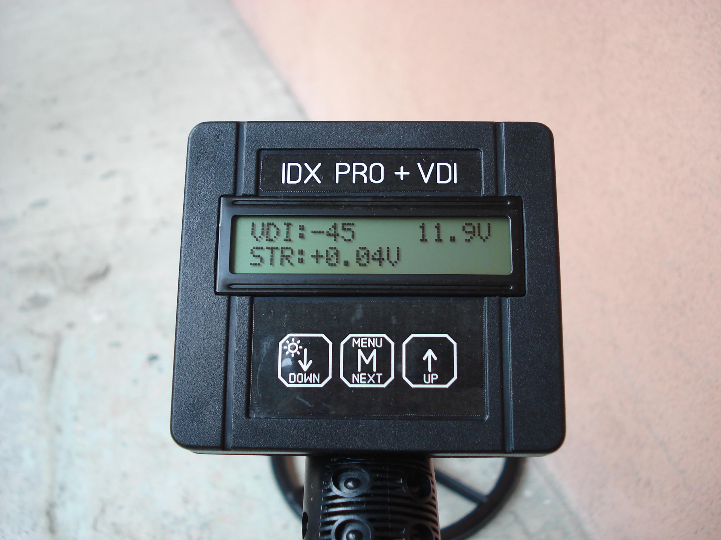

                        I will write tests how it works during the weekenClick image for larger version
                        great project .. words of appreciation .. LCD backlight works under SW3 just as I wanted

                            • VDI works like the previous version 1.4 .. good sensitivity in my system I increased the gain U1 R4 and R6 instead of 1M are 3M ... for the test I used IDX my modification with X and Y channels shifted by 90 degrees VDI calibrated on aluminum foil VDI: 0
                              money nickel + 8- + 12, gold rings +20, yellow coins +49, fine iron -37 <> -55, magnetic stones +84, detachment from the ground - 88, with this turn on the backlight SW3 will not always work sometimes after the third press but the interesting thing is that the VDI setting only shines on positive indications
