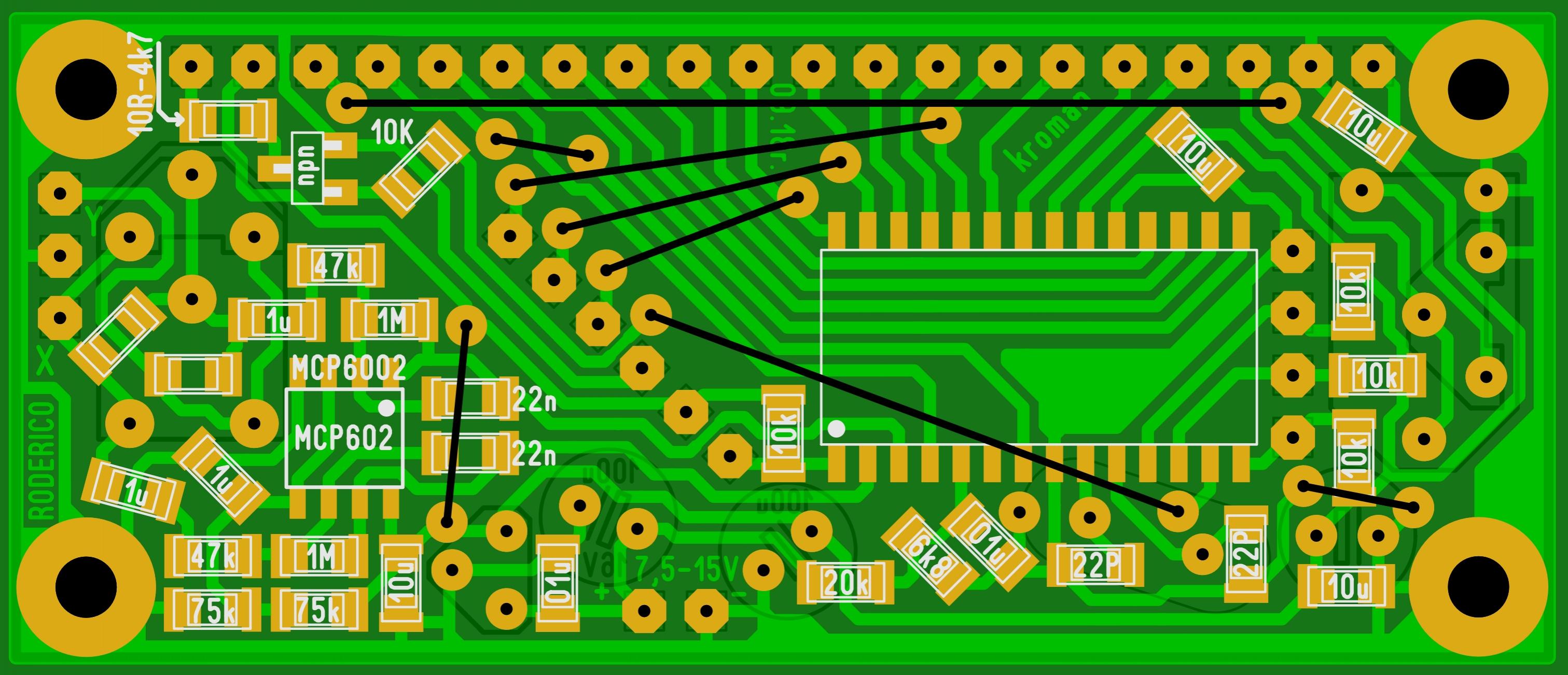

  • my designed PCB for GLCD on PIC18F25K22
    • this is the source code for version 2.0 released under the GPL license and including all the versions (LED, LCD and GLCD). I also backported the backlight control for PIC16F88/690 but the pcb is not backwards compatible anymore and it will not build with the XC8 compiler in free mode, so not recommended, consider PIC16F886 instead. PIC18Fxxxx firmwares can be built with the SDCC compiler but they are very slow compared with those of the Microchip XC8 compiler:

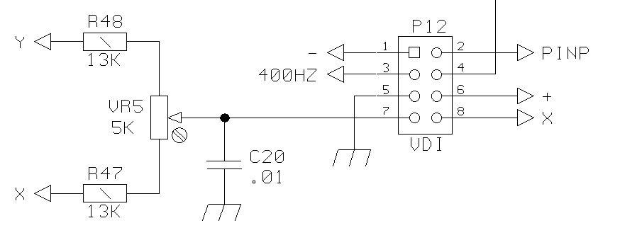

          • looking at the original IDX schematic http://www.geotech1.com/forums/attac...7&d=1313926126 I saw that the problem spotted by kroman01 (different saturation levels of XY) is not present in the original design as it can be seen in the VDI connector (P12). Maybe someone would like to test it, i.e. instead of using RT2 and R9 it might work much better to use R47, R48, VR5 and C20 of the original schematic (below). This is something similar to the U3 input through VR2 which is not in the idx pcb...

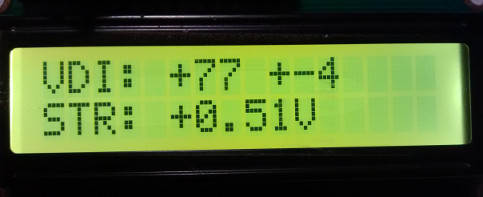

                      • ok very good, no problem, it would be good to see in the tests how the vdi changes with the soil, i.e. a test with an object in the air and the same or an identical object buried in the soil. If possible also a test with this version where the vdi is extracted from the histogram as the mean value. This version also shows an uncertainty estimated with the mean deviation (it can be hidden in the config menu). Big values of the deviation would indicate bad measurements of the vdi e.g. iron objects.
                        • I merged beta1&2 in beta3 for testing, now it is possible to select how the vdi is extracted, i.e. as max(x,y) equivalent to v2.0 or as the mean value. This latter might not work well when using a broad interval, e.g. [-90,180] or [-180,180] because you might have two peaks, but it works well in [-90,90]. I also backported the changes to the LCD version (see attached image). The uncertainty on the vdi helps to fix its value, i.e. you need to move the search coil until you get a small uncertainty then you will have a good vdi measurement.

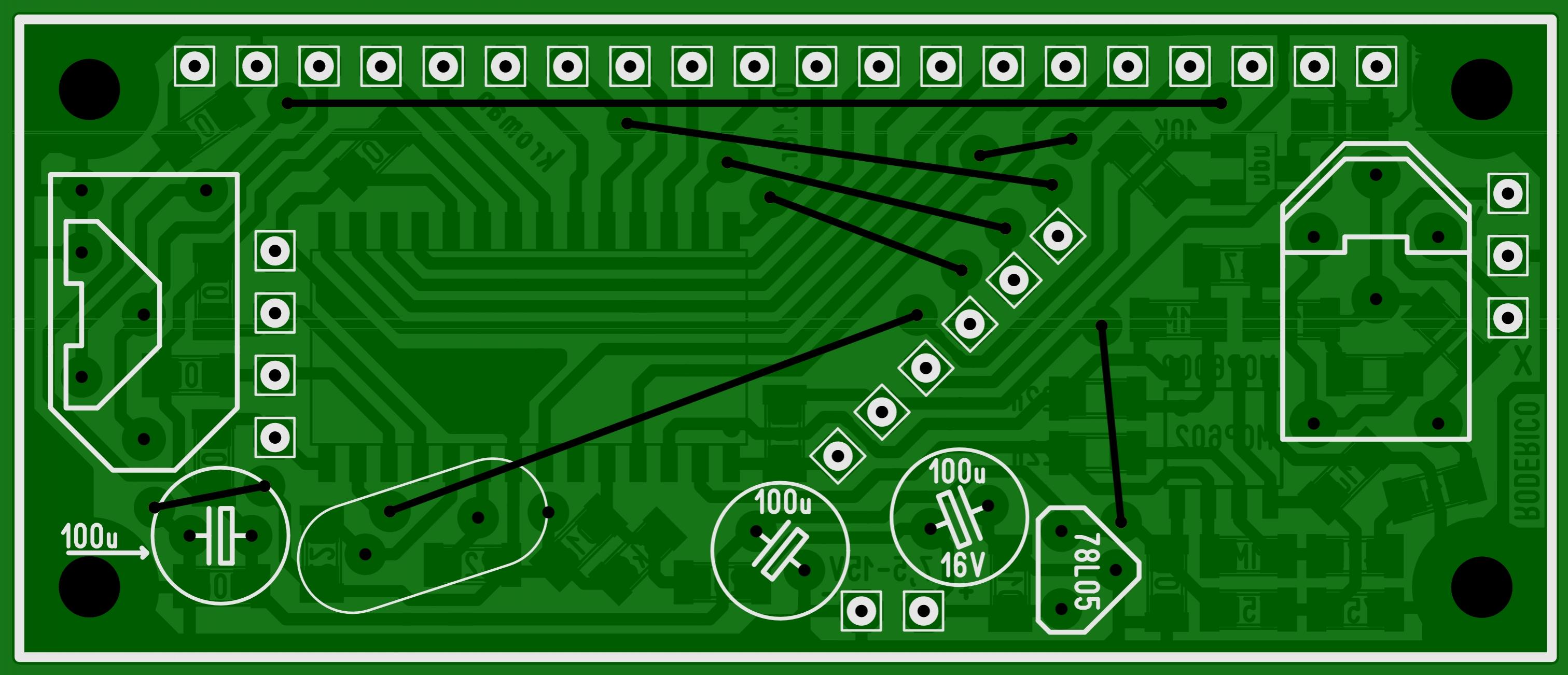

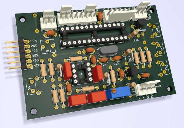

                            • I updated the old THT version of the pcb reorganizing some of the components and I have changed the values of C1, C2, R3, R4 and the like to more common values for testing. Larger values of RT2 and R9 more similar to the original IDX schematic also work well, e.g. 10K (RT2) and 22K (R9).
                              - R11 needs to be chosen to limit the current to the backlight e.g. 8-10mA
                              - R7 and R8 are 1%
                              - C12, C13 and crystal Y1 are not necessary for PIC18F25K22 and PIC16F886
                              - for a LCD display short R15, pins CS1, CS2, RST and VEE are not used
