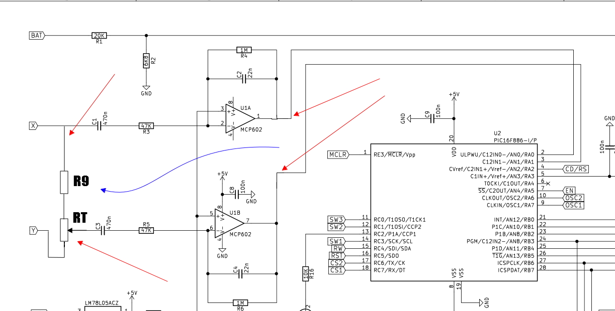

      • Hello! The circuit and the pcb are different. Have you changed the scheme? Thank!Click image for larger version
        • this avoids different saturation levels for channels X and Y after the MCP602, it was found by kroman01 after the first version of the pcb (2.0) but the pcb was never updated only the schematics, in any case the firmware should work well in both versions 2.0 and 2.1 (in version 2.0 you would have an earlier clipping in channel Y when the op-amp is in saturation)...
