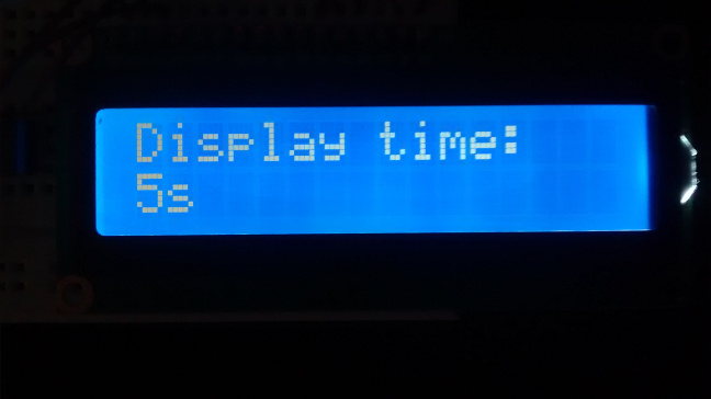

    well done ! You should also add adjustable display time. As in the previous version.
    Now the VDI number is displayed all the time and is not good.
    This was done on purpose for remembering what was the last target, however, since there is still some space left in the pic I will add another menu entry for adjusting the display time in the next version. As a workaround you only need to lower the VDI threshold below ~ -75 and the ground signal will clear the display as in the previous version...

          VDI LCD v1.2
          I added the VDI display time option and compiled a new version. The VDI value is displayed only for a few seconds (adjustable in the menu) if no metal object is near the coil. This is useful along with the VDI threshold as reported by perkun.

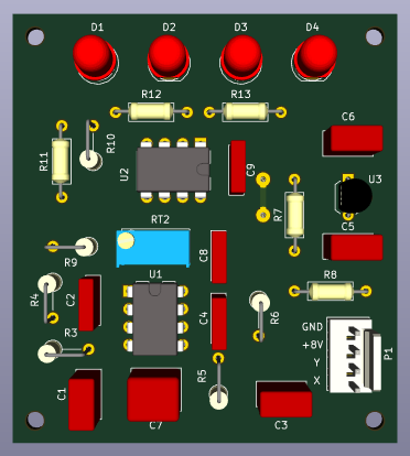

                            VDI LED v1.1
                            I compiled a new version removing the trigger delay for quicker response, reported by Artyom. I had to add a pull-up resistor of 10K between MCLR pin and Vdd because it added some noise to the A/D when turning off a led (even being disabled in the configuration). I also added up to 4 leds (perkun's idea), so you only need to replace the firmware (and/or some leds) to change between different versions.
                            2 led firmware:
                            D1 on for -60 < vdi < 0
                            D2 on for 0 <= vdi < 90
                            D1 and D2 on -> op-amp in saturation and alternating on/off for calibration
                            D3 and D4 not used (no need to be in the pcb)
                            4 led firmware:
                            D2 on for 0 <= vdi < 20
                            D3 on for 20 <= vdi < 45
                            D4 on for 45 <= vdi < 90
                            I tested both with a PIC16F88 but it should work with PIC12F683/675. In the attached files there is also an example pcb layout that could be used for this vdi:

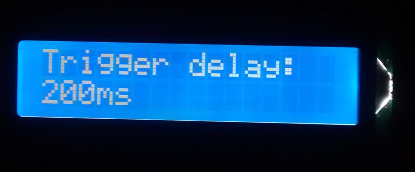

                              VDI LCD v1.3
                              Here it is the version with the trigger delay adjustable in the configuration menu to set a faster response. To remove the delay as in the led version you need to set it to 0ms and to recover the previous version value you need to set the delay to 500ms. This version also discards some cases where the sampling is incomplete and gives wrong vdi numbers (I'm using a 10k resistor between MCLR pin and Vdd in my vdi, however I haven't tested the firmware without the resistor while reducing the delay to 0).
                                This version has the default VDI interval in [-90,90], however, if you cannot see silver (i.e. vdi>90) then you need to change it back to [-90,180]
