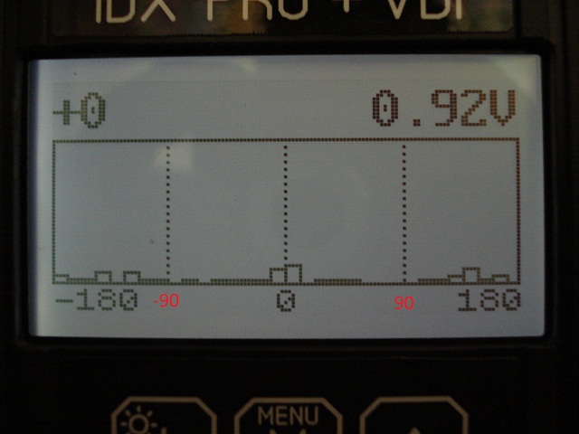

    • maybe you could use this updated version for the tests, you can change between the three views on the fly by pressing SW2 without going through the menus...
      • glcd_test5 works but I see SW1 swapped SW3 when I choose views
        • try this one instead, it should fix the problem...

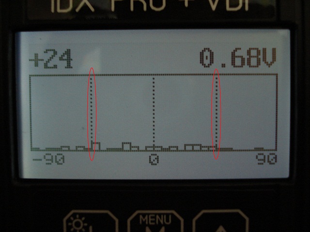

          • minor visual corrections in the histogram view -90/90 marked for deletion -180/180 none -90 90 I see that adding -90 will result in lack of space
            these corrections are not necessary

            i found the reasons for trimming negative indications, in the twist setting RT2 affects this effect, U1 works properly and enters saturation with the same levels for positive and negative waveforms, RT2 should be on the X Y input
            • ok very good, the mcu sees the voltage drop through RT2 and then two different saturation levels for X and Y channels. A possible way to implement this would be to estimate the new value for Y and use two different saturation levels to indicate the saturation due to channel Y. It might be good to remove -180/180 and use -90/90 instead but it might be better to leave the vertical lines for -45/45 since they help to find easily what the values of the bars are...
              • you do not have to change anything, the range 180,180 is to remain, the typical RT2 setting is 1/4 1/5 scale
