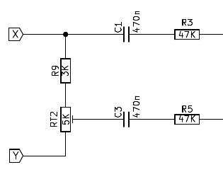

                  RT2 inserted before C1 and C3

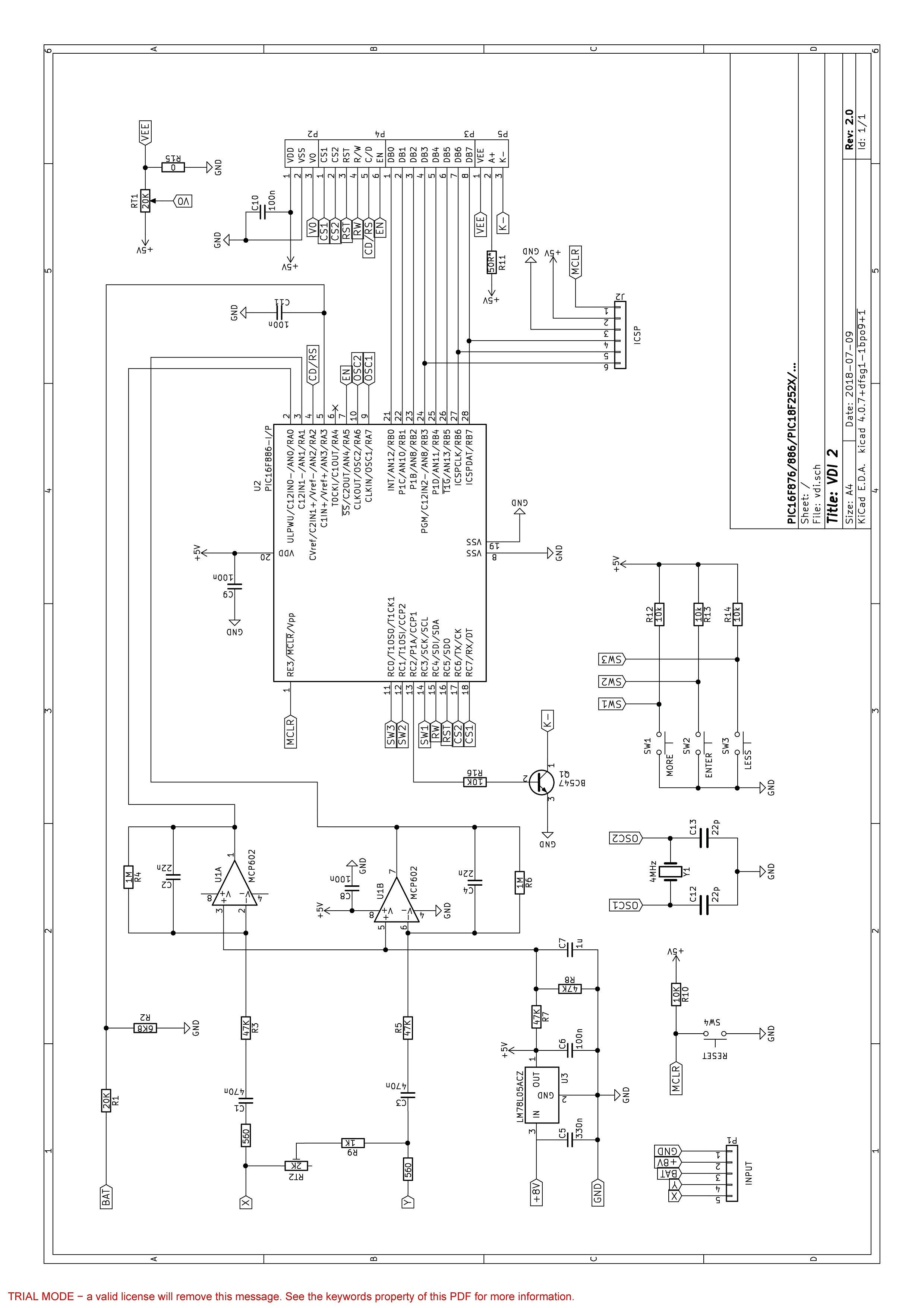

                  • very nice video, with your modification the saturation levels would be the same for both channels and it won't be necessary to change the code, could you post the schematics or a drawing with your modifications?
                    • my modification
Name:	vdi2-sch - mod.jpg
                      • this would avoid the problem of different saturation levels, would this introduce any side effect in the X Y signals of the idx?
                        I didn't do the preconditioning of the signal, but looking carefully at the schematics I see that the signals are filtered at 7.2Hz while in the scope view it can be seen that signals are typically 4-5Hz, so maybe this can be optimized using a wider pass band filter, e.g. from 2-7Hz. A simple way to test if there is an improvement would be just to change C1 and C3 to 1uF, allowing a band of frequencies from 3.4Hz to 7.2Hz
                        • the X Y signal from IDX comes from the outputs of the amplifiers
                          i will do a test by changing C1 and C3 to 1uF
                          • ok very good
                            • I tried kroman01's mod and it fixes the problem, there is no more clipping in Y channel, however I just moved RT2 and R9 before U1 keeping the original values and it is working fine for me, what is the reason to add additional resistors?
                              • there is no real reason to add additional resistors, the system will work with these two solutions, I still need to design a PCB compatible with the display for direct connection,
                                i have not tested with C1 and C3 1uF, there is not enough time
