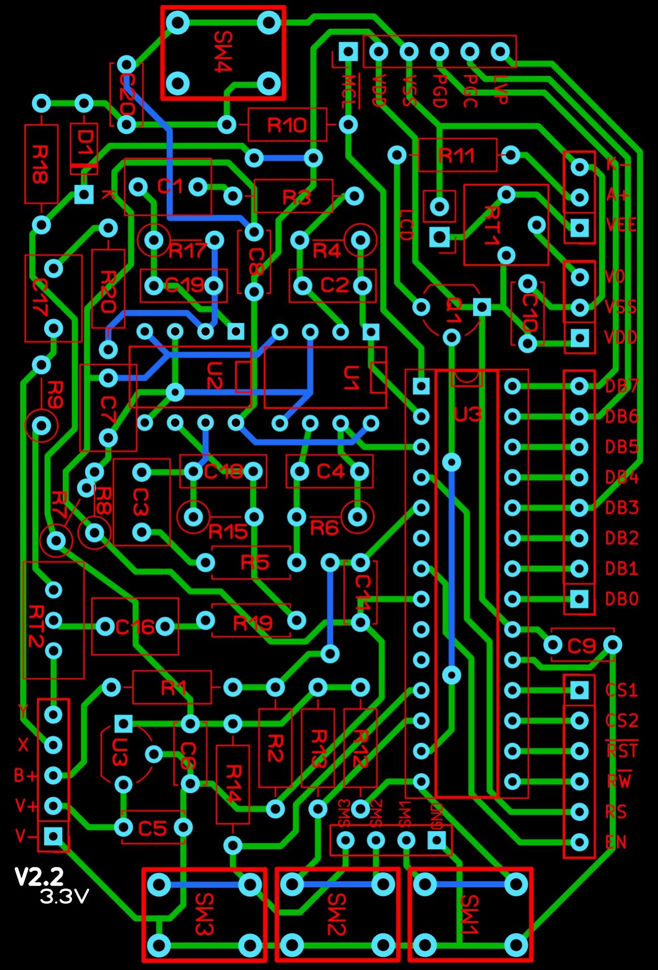

            • I did The sprint layout for roderico VDI 3.3V and two MCP602 instead of one MCP604. I added a SIP connector for switches if you want to put them on another board like the screen PCB with a more simple connection. I did the drilling to correspond to my IDX PCB to permit an easyest integration too.If someone could verify that there is no mistakes on PCB will be cool. Do not forget I'm new on this type of exercise. If it's good I will put the Gerber here for both IDX and 3.3V VDI.ThanksClick image for larger version

              • in principle it looks fine, however IMO is not a good idea to share C8 between U1 and U2, you should add a decoupling capacitor for each MCP602 and place them close to pin 8, check again U1, U2 connections just in case
                • Looked over the layout Albdelafar and beside what Rederico said I didn't see anything majorly wrong.
                  Hint: I have many times soldered a by-pass cap to the power pins on the bottom of the PCB. This way the cap is directly on the power pins. The way you have C8 it has a long trace to connect and this does not help kill high frequency noise or provide good by-pass of power to the op-amps.

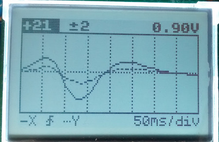

                    • when using MCP604 (or two MCP602) the input is in phase with the output, but 180 phase shift when using only the MCP602, so the trigger channel should be the opposite, i.e. if trigger channel was set on the rising edge in v2.1 then you would need to change it to the fallen edge for best performance, this can be seen in the scope view, the attached picture shows MCP604 version triggering on the rising edge of channel X this might be more stable but for weak signals it might be better to trigger on the fallen edge instead

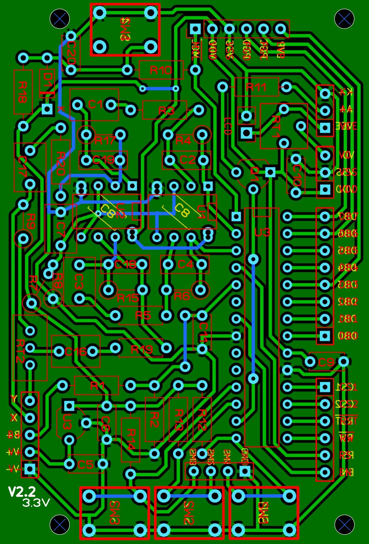

                          Do you think I can put C8 like this on the bottom side like waltr said ?

                          You use ceramic capacitor for by-pass right ?
                          • of course, waltr explained it better than me and he also has a working SDD1305/3.3V version, multilayer ceramic capacitors for C7 and C8 would work fine, see picture of v2.1 as an example https://www.geotech1.com/forums/atta...8&d=1562773837 , you can also make some room to place C8 capacitors close to power pins

                              Ceramic caps-yes.
                              I was not thinking of adding holes with the caps on the bottom. Nice idea.
                              I was thinking of simply soldering the caps to the op-amp pins that extend through the pcb. I like your idea.
                              The caps can be bent over to lay onto the pcb reduce the height below the pcb.
                              Having the caps directly on the op-amp pins is best as it reduces the amount of trace length which would add resistance and inductance.
