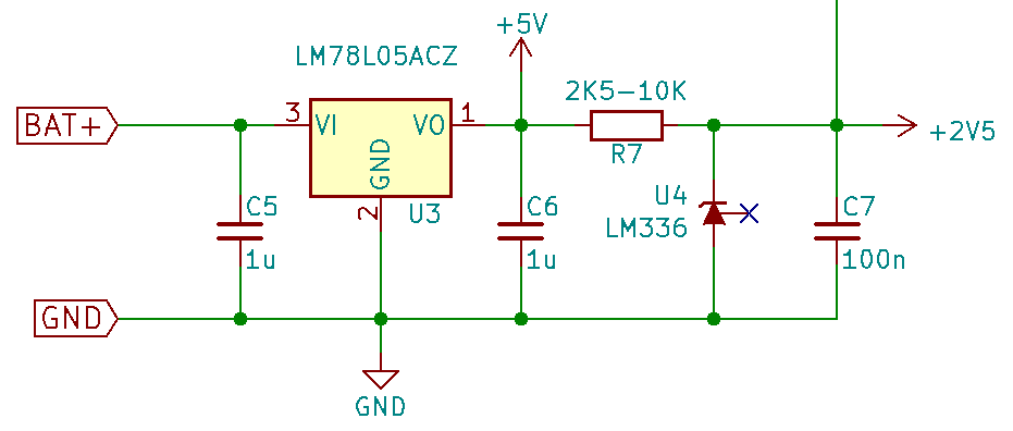

                    • I think you also need to fix the ADC offset, maybe just replacing R7 and R8 with another resistor + 2-2.5V zener diode, mine doesn't disappear by using only the internal Vref.

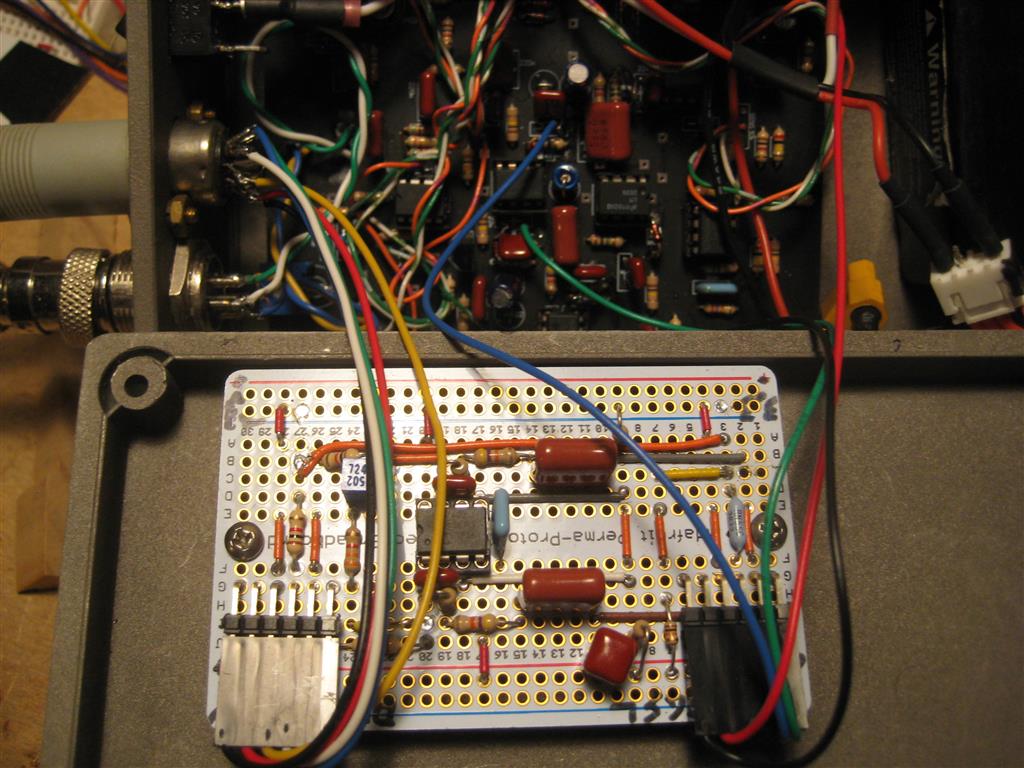

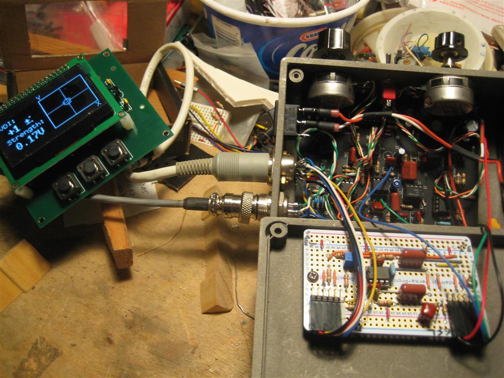

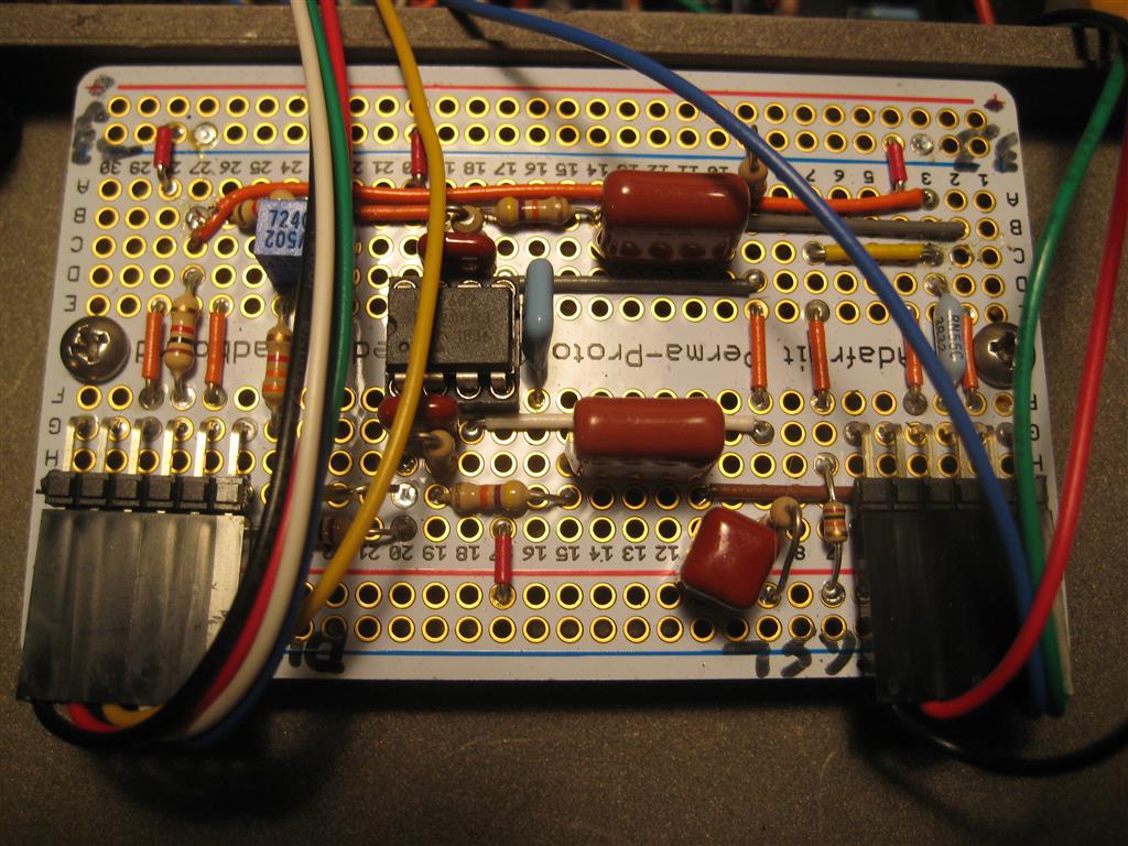

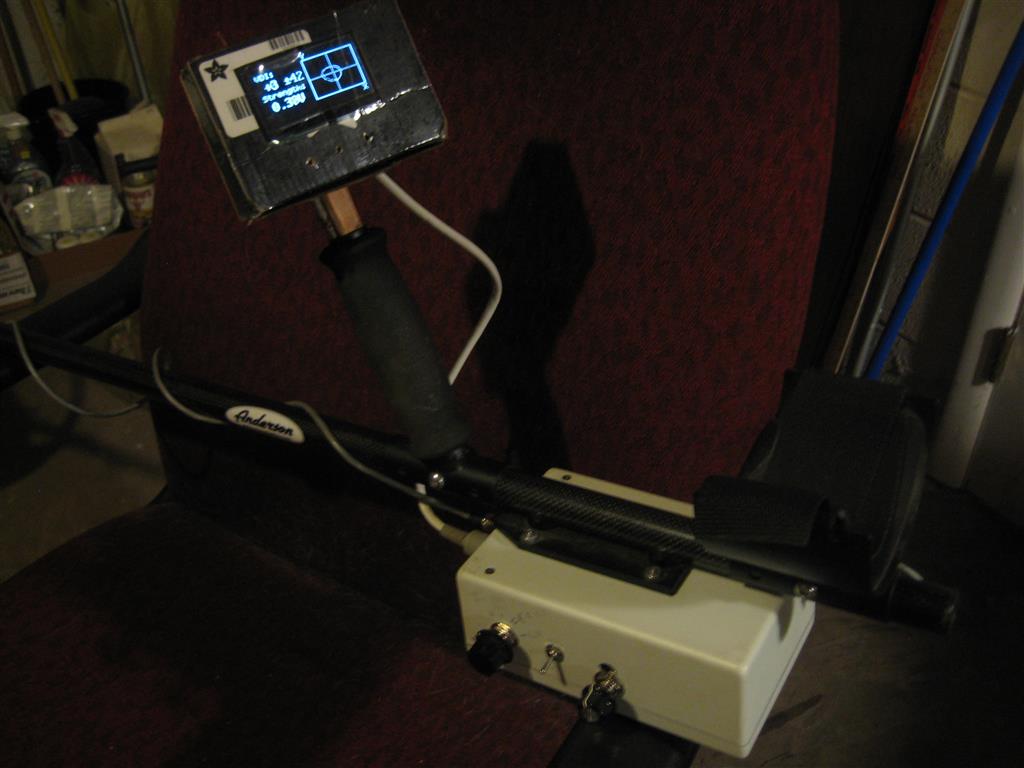

                      • Ok, finally some photos.
                        Note the circle on the X-Y graph from the AC Mains.
                        • this looks pure noise to me maybe because you are using very long unshielded wires before and after the MCP602 (more EMI/RFI), could you also post a picture of the scope view for the last picture (the one with a big circle) to see if this comes from the long wires or from the coil? You might also increase the trigger level e.g. to 15mV or 20mV (losing some depth)
                          • Originally posted by roderico View Post
                            It is coming into the Coil not the wires. As I pointed out this is completely due to EM interference in my work shop when the furnace and circulating pumps are running.
                            I was simply pointing out that EM interference does exist and the need to ensure one does not try troubleshooting non-existant issues and the need to test away from AC Mains and EM interference. In my workshop when none of the heating equipment is running the detector output is quiet and the sensitivity as well as the X-Y plot is good.
                            Further, when first building the TGSL it was difficult to determine if the circuit had a issue or if it is EM interference. Many people on the forum building detectors have issues with low sensitivity and excessive noise due to EM in their workshops. The VDI X-Y display is very helpful to 'see' what might be going on. On the X-Y plot a Circle is AC MAINS interference. This makes the VDI graphic display more useful than simply helping ID a target in the field.
                            The photos I posted are only to show construction.
                            • This clarifies very well the issue but I would like to see if possible the scope view to understand better how the circle is generated I guess they would be random values. As there is no much improvement using the internal voltage reference the other option was to test a 2.5V voltage reference for the ADC offset (both would be better), I took an example from the LM336 (https://www.ti.com/lit/ds/symlink/lm336-2.5-n.pdf)
