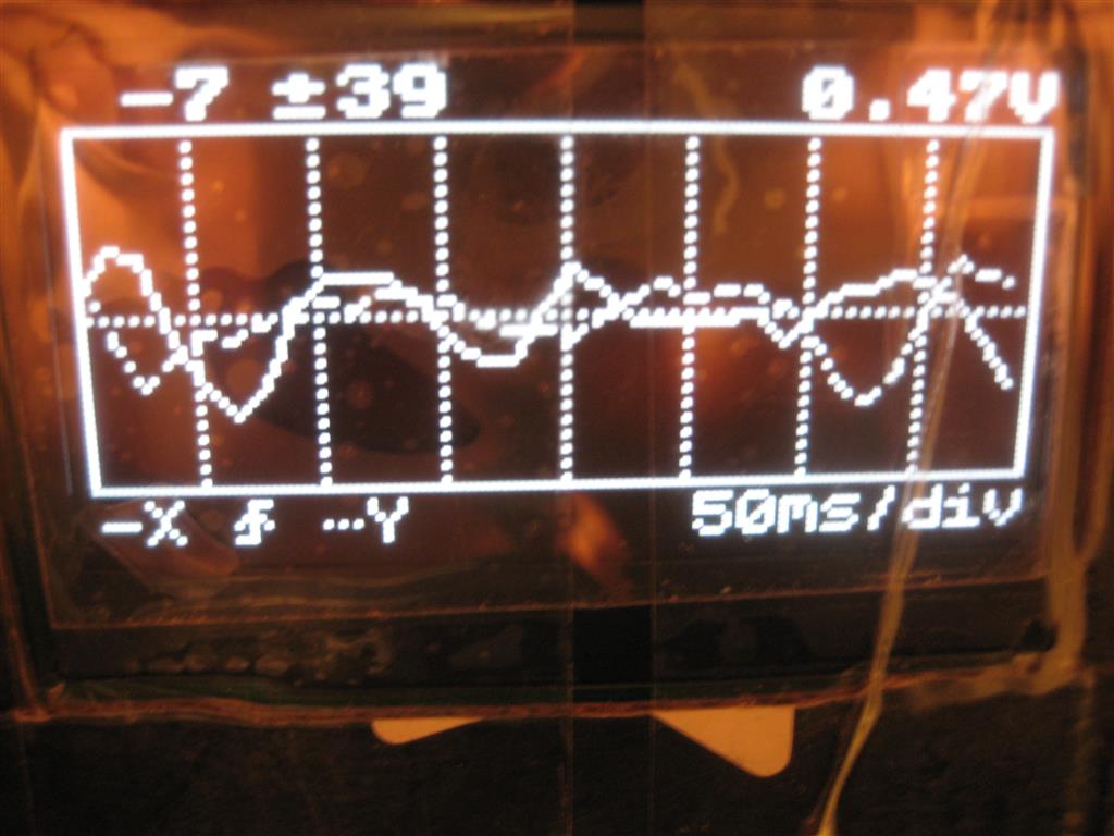

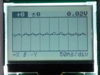

          • Roderico, Here is the Scope plot with the Furnace running. Also the X-Y plot when furnace is not running.

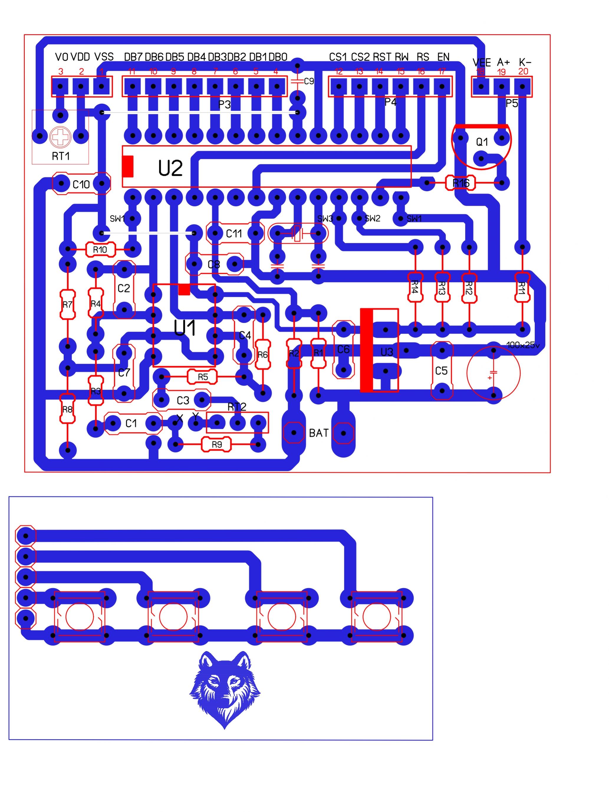

              • 128х64 ks0108.... PCB has already mocked up Click image for larger version
                  neither was the mains nor was it noise , X and Y have ~ the same amplitude, ~10Hz and are ~90 phase-shifted, so a Lissajous curve (circle for 90) produced by the furnace

                        SWL, if you have not already built your new pcb maybe it would be better to wait for the 2.5V voltage reference tests since it will replace R7 and R8. I don't have yet the MCP1525 or LM336 but maybe someone else could test it sooner...
                        • Yes, of course .. I?ll wait for the results .. ..

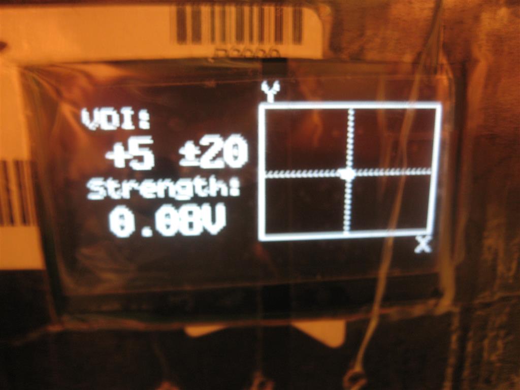

                              Did get out yesterday and away from AC Mains the ADC center values flicker about 5-6 counts. Maybe better ref, op amps, etc could reduce this but probably not worth the effort since the VDI does work rather well and has been very helpful addition to the TGSL especially in the Iron junk rich farm site.
                              Something I did play with is looking at the VDI numbers with varying the DISC control. At farm sites I keep the DISC nearly all the down and not DISC out foil whereas in Parks I turn the DISC up to remove foil. This does change the VDI numbers but makes sense when thinking about what the DISC does.
                              With the VDI one can leave the DISC below foil and note a low VDI number, ~10, is Foil. Or if turning the DISC up to eliminate foil the VDI numbers for other target decrease by about 10. Example is Brass gun shells that VDI around 38-45 drop to 28-35.

                                this can explain why it picked up the furnace (10Hz) and not the mains (50-60Hz), however if I remove the coil then mine picks up the AC mains (see picture)
