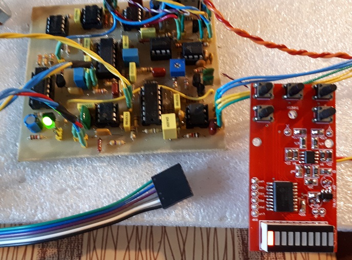

                    • Good day everyone! I soldered the indicator for 6 svd on the PIC16F819 flashing all the firmwares - for Thunderstorm, Tesoro, Whites - the result is the same, but the metal detector sees the target, but from the entire line only one last LED lights up. I also wait for black metal or non-ferrous metal. there is no difference. Why then sculpt this line of LEDs? leave one last one and let it blink like a star on a Christmas tree .... The meaning of this indicator ????I am waiting for the accessories on the indicator 3 of the SVD on the PIC12F683, if it works the same way, then collect it in a heap, paint it and throw it away. Maybe there is some setting to see the indicator "COLOR ONLY"? . Sorry for the funds spent, and most importantly TIME ...In the photo MD WhitesClick image for larger version

                        • Hi nikko10, you can see in the glcd or lcd version that for a given target there is a big error in vdi numbers, e.g. depending on the orientation of the coil, if you add many leds and the vdi separation for each led is less than the vdi error then they will be alternating for a single target, two leds should work best but at the vdi boundary between ferrous/non-ferrous (depending on your calibration) you will also have alternating leds, if your vdi error is small you could add more than 2 leds, (3 or 4) but it cannot be better than the glcd version that provides more information
                          • Hello roderico! Thanks for your reply. There is a ready-made indicator board for 6 LEDs, the brightness of the backlight is adjustable, and probably the sensitivity, judging by the alternating movement of the LEDs. How to calibrate or how else can you programmatically adjust this indicator? Or is it not worth wasting time and throwing away this design? thanks for the help
                            • I don't know about that board but I guess the alternating leds are due to the error in the vdi numbers. The version with pic12f683/675 might be more stable because it has only 3 leds (vdi+/vdi- and saturation) so the leds can only alternate when the target vdi is close to 0 (or the value that was set in the calibration). I think praktik_1974 was giving it a try, the advantage over the glcd version is that is smaller, cheaper and has less components but it cannot be better for target id than the glcd
