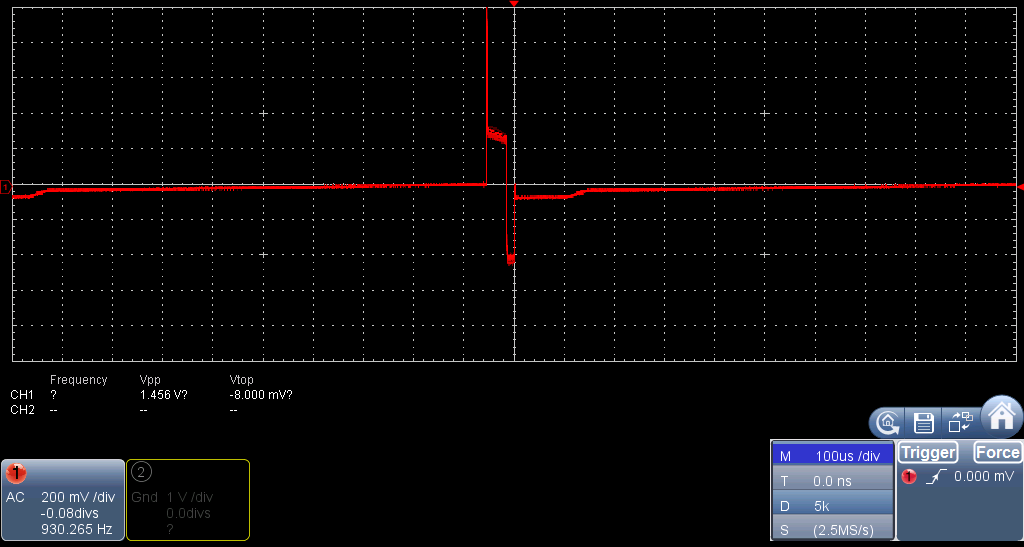

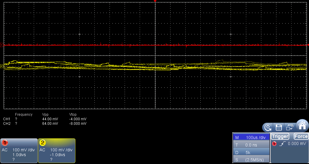

    It's the signal taken from PIN 1 of the LM358 after the 22k resistor (before the diode).
    Here's what it looks like: Click image for larger version
    That yellow line jumps up and down like crazy.
    This messes with my threshhold.
    It does not occur when coil is disconnected.
    What can be done about this?

      Oh, yes - I am wondering why the jitter is only on the top part of the yellow signal.

              Since it goes away when disconnecting the coil, try rotating the coil toward different directions. If it's external interference you will see it vary and probably can find a decent null point.

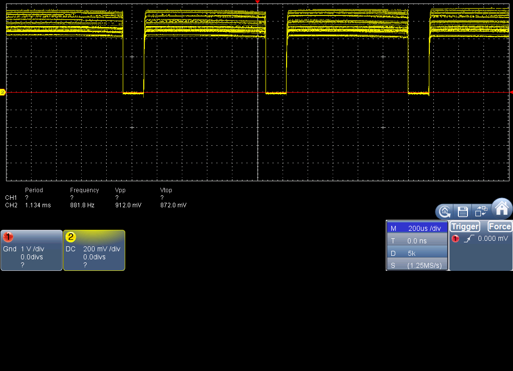

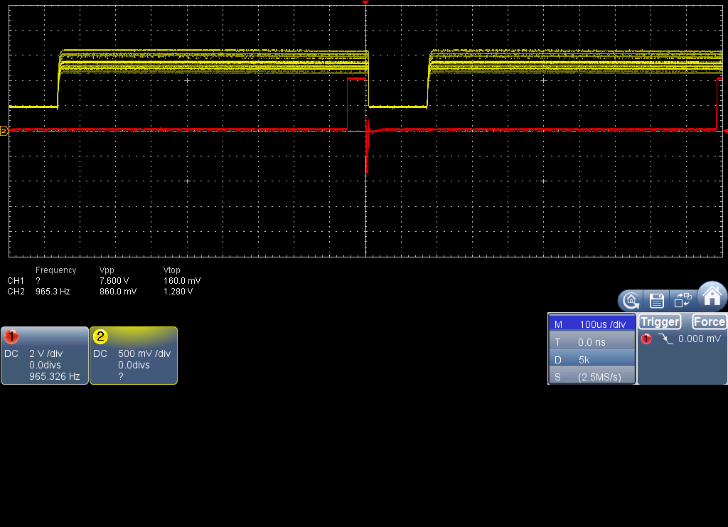

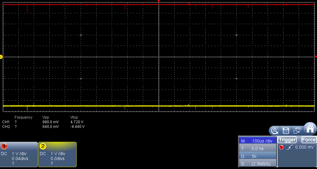

                Thanks for your reply Qiaozhi.
                The negative rail appears unstable - Pin 4 of LM358
                The positive rail appears to be ok. - Pin 8 of LM358
                Two screen shots in DC & AC mode:
Name:	Surf Pin 4 and 8 lm358 DC Mode WITH coil.png
Name:	Surf Pin 4 and 8 lm358 AC Mode NO coil.png
                Output pin 7 of lm358:
Name:	Surf Pin 7 lm358 NO Coil.png
                Perhaps you can make something of the screenshots.

                  OK - there's some switching noise on the negative power rail from the 7660 that's not synchronized with the TX oscillator, but it doesn't seem bad enough to be causing the problem. It looks to me like the noise is external to the circuit. I would try Carl's suggestion of repositioning the coil to see if you can identify the direction of the interference. You might also want to check that the screen to the coil is connected to GND (0V).

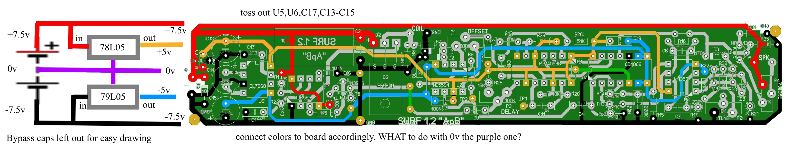

                      Before I follow through on all your EMI related hints, I'd like to implement a split power supply without the 7660S.
                      That's so I can see what is 7660S related and what is external EMI. Maybe it will help me sort out the problem.
                      Would the following work as a split PSU? Can I connect them like in the picture?
                      I still don't do well with pos/neg power rails and reference points, it jumbles my mind.
                      What to do with the 0v of the battery pack - is it equivalent to ground on PCB?
Name:	Surf PI Split Battery PSU.jpg
                      Cheers and with appreciation, Polymer

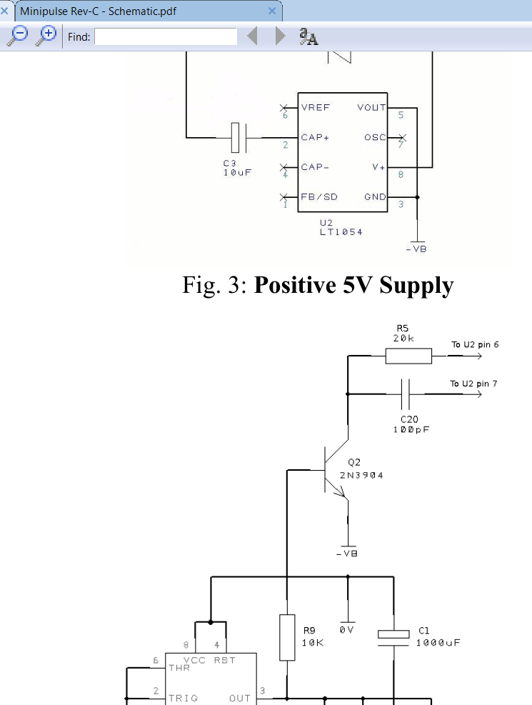

                        I would suggest having look at how the TX in the Minipulse Plus is synchronized to the voltage converter. The same idea should also work with the 7660.
                          Hmmm. Is it this what you mean:
Name:	Osc example mini p plus.png
                          What is the equivalent to the -VB on the Minipulse Plus in relationship to the voltage designations on the Surf PI?

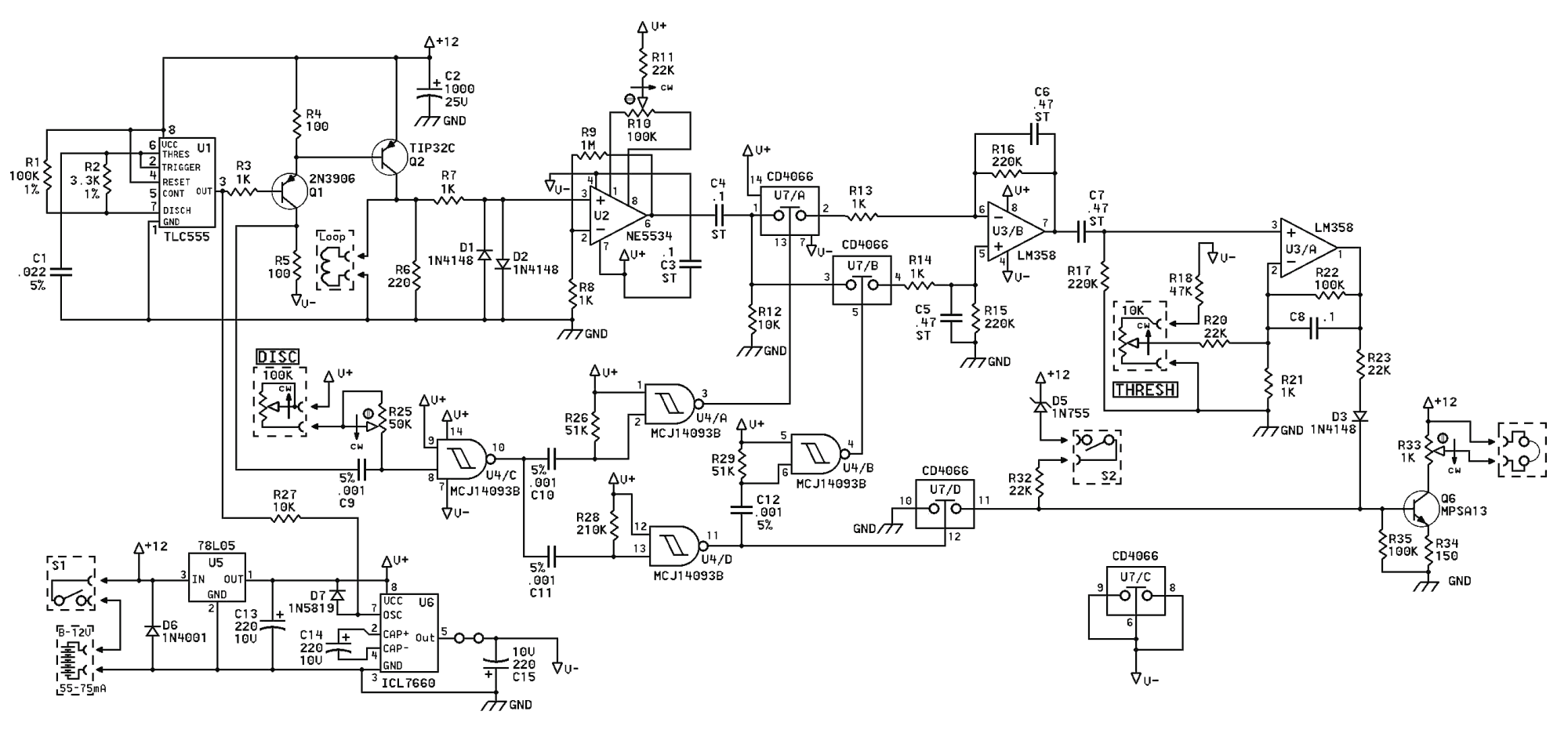

                            I've just noticed that ionut_mtb has posted an image of the original White's Surf-PI schematic, which does include synchronization of the 7660 with the TX OSC. Simply add D7 ( 1N4148 ) and R27 ( 10k ).
                              Quick feedback - this helped a great deal! YAY
                              Now to go about solving possible EMI issues ...
