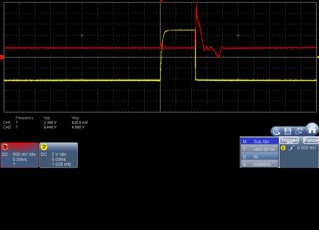

    What does the signal look like on pin 7 of the LM358?

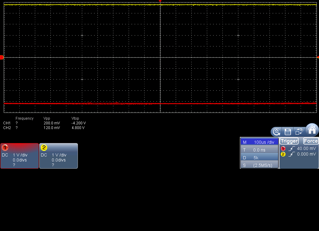

    I assume the voltages on pins 8 and 4 are stable?
    They look stable now. Is ist okay that -voltage is not quite as much as +voltage (-4.2v to +4.9v)?
    Screenshot of DC +- 5v Pin 4 +8 LM 358 Click image for larger version

    Signal Pin 7 of LM358: Click image for larger version
      Screenshot of DC +- 5v Pin 4 +8 LM 358 [ATTACH]40518[/ATTACH]
      Signal Pin 7 of LM358: [ATTACH]40519[/ATTACH]
      Original surf pi have same reading. my homemade surfpi, same. -4.2 +5v
          Thank you for the verification of the voltages ionut_mtb!
          Hope we don't both have it wrong
            Update:
            I found I somehow don't like the 7660's (had too many hassles with them on Baracuda & Surf),
            so I put in a LT1054 according to specs of datasheet
            using it as a Voltage Inverter/Regulator from 12v.
            It works well and I also have nice symmetrical +-5v rails now.
