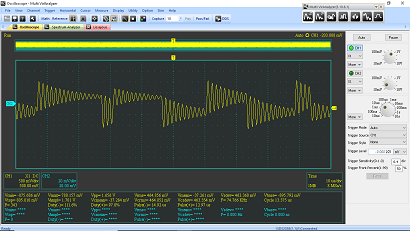

    just took left and right side of coil on muli all the other pic where centre of coil

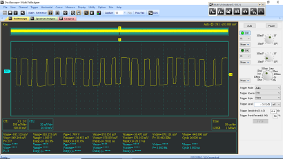

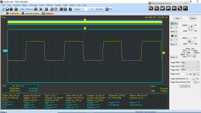

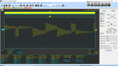

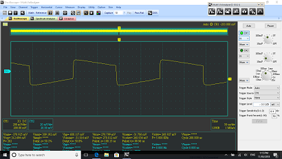

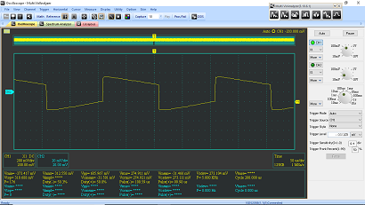

    • #92
      agree with taktyk. you see self resonance on your o-scope probe+input.
      Does the pickup coil need a damping resistor?
      Ahhh yea...pickup coil's self resonance!
      • #93
        I think Mr. Chiv needs some assistance.
        The 5kHz waveform is a square wave, with a period of 1/5000 sec = 200 microsecs. So choose a Timebase setting of 50 microsecs/div, so that one cycle appears as 4 divisions on the screen, and the total screen shows about 2.5 cycles.
        Similarly, to best see the 10KHz and 15KHz freqs, choose Timebase = 20 microsecs/div.
        The 20KHz and 40KHz would appear best with Timebase = 10 microsecs/div.
        Reference Post 30: This is what the 'Multi' waveform looks like. Square in shape, with differing widths to just about every transition. But the waveform does repeat. The lowest frequency component is 5KHz, so the repetition rate is 5KHz. That means the entire complicated waveform cycle takes 1/5000 sec = 200 microsecs. So to see this on a scope screen, you want the Timebase set to 20 microsecs/divn.
        Reference Post 74: All the high frequency oscillation ( 450KHz?) DOESN'T exist. It's not produced by the detector. It's entirely generated by your pickup coil, it's inductance and capacitance, and possibly a bit of the scope probe capacitance. A damping resistor across the pickup coil should get rid of the majority of it. A reasonable starting value to try is 200 Ohms, but it may need to be anywhere from 75R up to 500R. The simplest way to find this out is to set the machine in 5KHz mode, and adjust the resistor so on the scope screen the waveform appears 'the most square'.
        If you have success, the other outputs we'd like to see would be the gold prospecting mode ones, which may be a mix of 20K and 40K, or maybe 5K/20K and 10K/40K, we don't know.
        And do the beach modes produce anything different, compared to land mode?

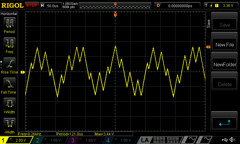

                And regarding your scope screen:
                The waveform appears to have a period of 380 usec, freq = 2.6kHz. Half what I would expect. Am I missing something?

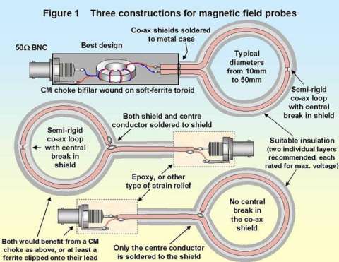

                      Fair enough criticism... however, I cheated. I didn't actually measure the coil current, I measured the TX magnetic field. Which happens to have the exact same waveform as the coil current. I used a magnetic field probe which I built...
                      Originally posted by Taktyk View Post
                      Ok. I also already see... What is the current Ipp?
                      ...as such I don't know the current Ipp.
                      BTW, Minelab already published the TX voltage waveform, from which you could construct the TX current waveform. I did this months ago. Today was the first time I actually looked at the real waveform, and it matches exactly what I expected.
                      • Originally posted by Skippy View Post
                        I've started a new thread on this, as a challenge. You guys are pretty smart, let's see what you come up with.
                        • something like this ?
                          • Much simpler... just a coil wrapped on small ferrite rod. Actually a surplus pinpointer coil from designing the F-Pulse.

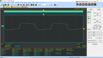

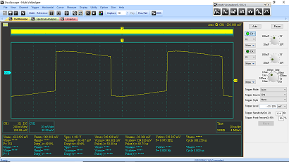

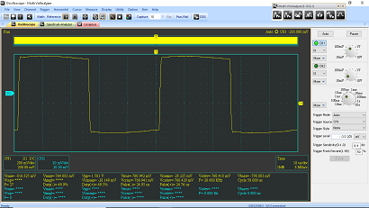

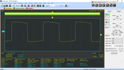

                                ok had a crack at this. thanks Skippy for explanation, ended up with680R to give me the best square as I could get.
Name:	5 with 200R.png
Name:	5 with 390R.png
Name:	5 with 680R.png
Name:	10 with 680R.png
Name:	15 with 680R.png
Name:	20 with 680R.png
Name:	40 with 680R.png

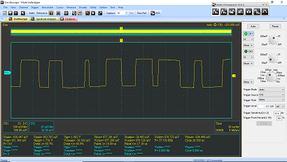

Name:	m with680R.png
Name:	m with 680R @50us.png
ID:	351237 P1 multi
