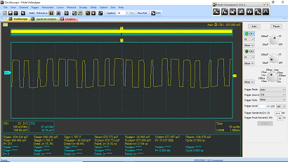

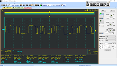

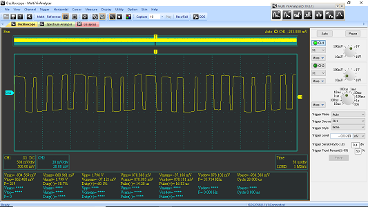

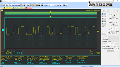

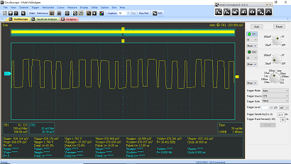

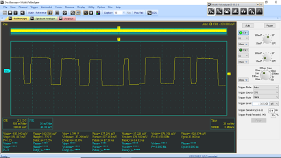

                  Take a closer look at Chiv's (tiny) screengrabs of Beach Mode, b1,b2 in Post 106. Clearly two frequencies, I think 3 cycles and 9 cycles in 385 usec, giving freqs of 7.8kHz and 23.4kHz.
                  Worth examining in more detail, perhaps when Chiv's got the Spectrum Analyser 'tuned up'.

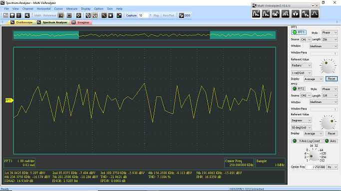

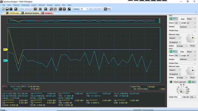

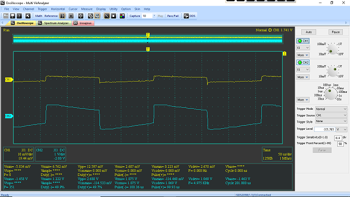

                      • ok I use your little hint guide Skippy, Blue ch 2 was coil from before and yellow is a tool made from the net EQ800 was set on p1 @5khz so attached two pic from each oscilloscope and spectrum, but real means nothing to me hope it in the right direction, emi are very high in my area

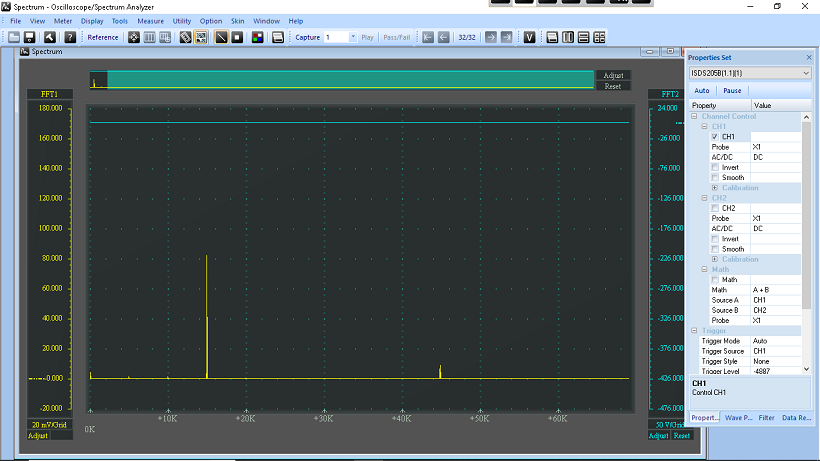

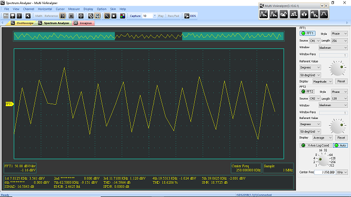

                        • Still trying to nut out this spectrum side of the scope still think its to slow for it, but cover coil and pick up in a lose sheet of ally for bit of a shield and seemed to help as have readings on the scope now. 1 pic park 1, second beach 1. now Am I heading in the right direction or just flogging a dead horse?

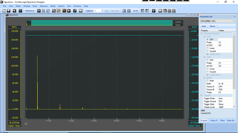

                          • Not heading in the right direction.
                            I guess I'm going to have to find a manual for your scope online and study it... I see you've now got some extra controls on the right-hand side, to adjust 'centre frequency'. That looks to be where your problem may be. We're interested in frequencies of below 50kHz, specifically we think the highest freq is likely to be 40kHz, and the lowest probably 5kHz. So the 'centre freq' needs adjusting so we see those frequencies on screen, not MHz stuff.
                            Try 5kHz single freq mode again. Then you would expect the spec analyser to show signals at 5kHz, and weaker ones at 15kHz (the third harmonic) and 25kHz (5th harm). If you can get that to look OK, then the multifreq modes should display OK, too.

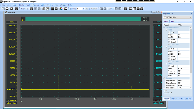

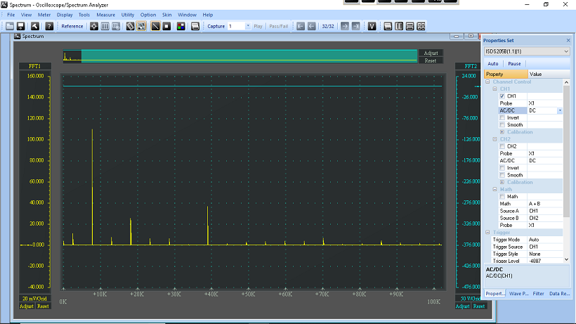

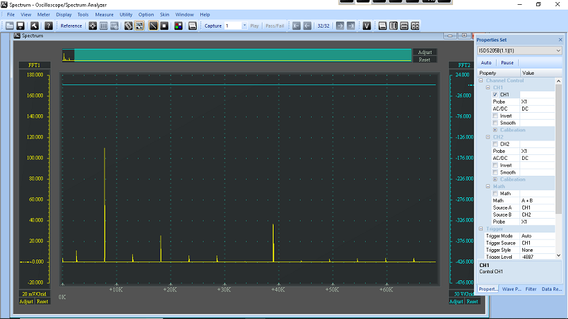

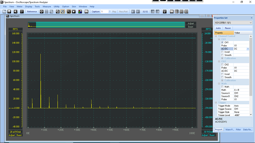

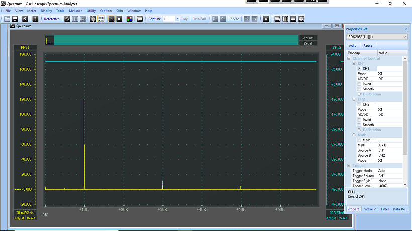

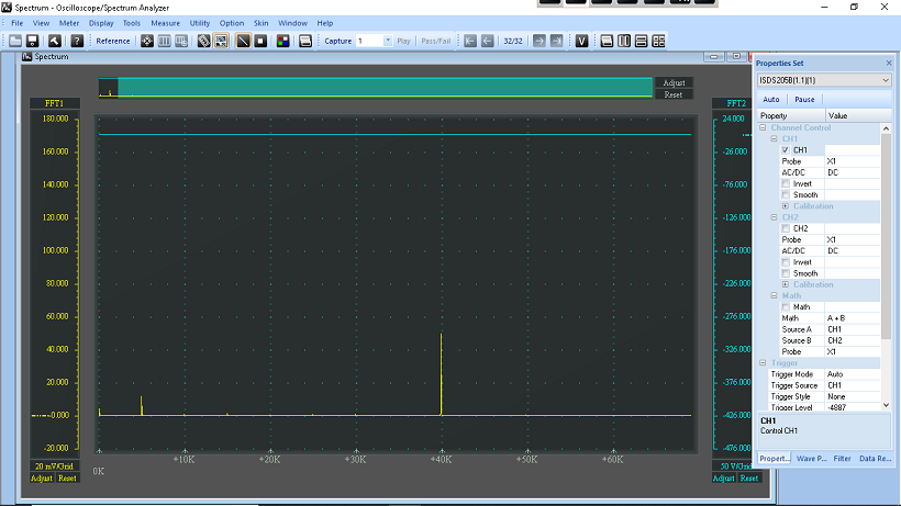

                            • I have had another crack at this,

                              • That's better, looks like you've tamed the beast now.
                                Your 'field multi' clearly matches the analysis that we did on the other 'challenge' thread, showing the three strongest frequencies of 7.8kHz, 18.2kHz and 39kHz. And residual bits of (n*2.6)kHz. I'm not sure why the signal level is lower at 39kHz than it is at the other two main freqs. If you look at the raw waveform, it clearly has a lot of 39KHz.
                                The 'beach multi' is obviously different. Could you re-do the raw square-wave beach-multi screengrab? (last time it was tiny in size)
                                It looks to have less 39k and more of the lower freqs.
