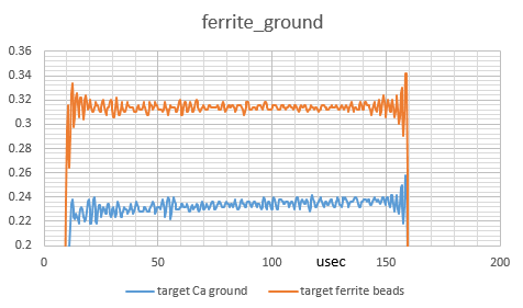

        I recorded amplifier out with a ferrite bead and some California ground using an IB coil and my bench PI awhile back. Tx 160usec constant rate(6250 amps/sec). Copied scope signal to Excel to see slope better, both looked flat on the scope trace. Been playing with spice today, constant rate pulse. 10uH parallel with .001 ohms(10,000usec time constant)gives a fairly flat signal during Tx. 1000usec TC has some decay slope. Something over 10,000usec should be flat. The ground signal is higher at the end of Tx. Ferrite doesn't show a R signal after Tx off delay, ground does.
        Added cr.zip, Rx(c)out
        Don't know how to simulate ground with spice but I think the Rx signal during Tx on time should be fairly flat with constant rate and an IB coil.
          If you find any slope, it should be from either viscosity or conductivity.

              The parallel resistor, inductor(time constant>10,000usec) target simulation matches what I get with my PI with ferrite beads, not ground(earth). 100,000use time constant is better. Seems to work with a VLF simulation if I did it right. Do you see something wrong with the simulations?

                    First, I am just trying to learn something. When I recorded a ferrite bead with a IB coil and a constant rate Tx the Rx signal was constant amplitude during Tx. I was thinking VLF Rx signal amplitude should be constant with frequency if the Tx amplitude is constant. Don't have a VLF detector so I was wondering if I could simulate with spice. (How to simulate a ferrite bead with spice?) Looked at VLF simulation again this morning, change L1 resistance to .1 ohms and the phase and amplitude stay constant with frequency so I'm thinking the parallel L R might be a good ferrite simulation. Don't know how to simulate the California ground with a positive slope during Tx. Any suggestions would be appreciated.
