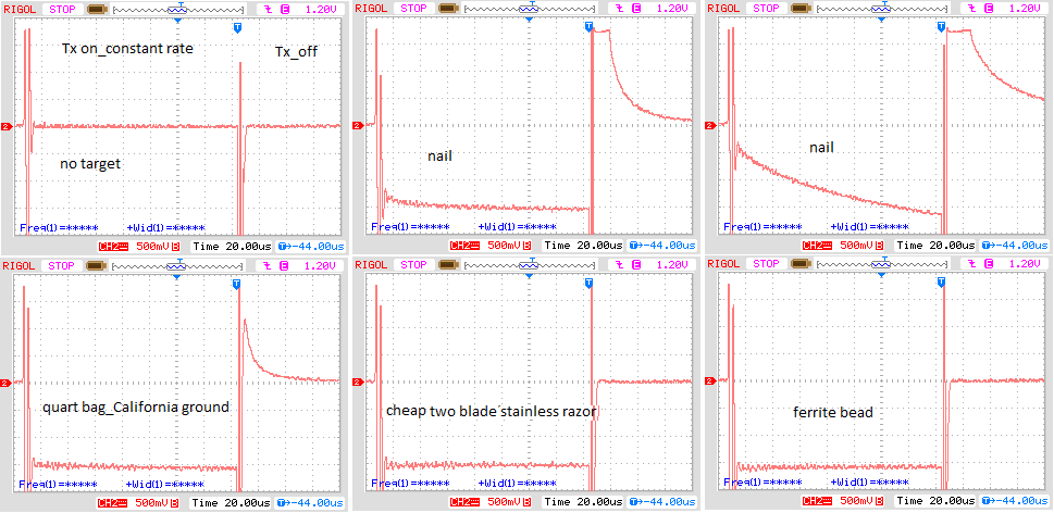

                    First, I am just trying to learn something. When I recorded a ferrite bead with a IB coil and a constant rate Tx the Rx signal was constant amplitude during Tx. I was thinking VLF Rx signal amplitude should be constant with frequency if the Tx amplitude is constant. Don't have a VLF detector so I was wondering if I could simulate with spice. (How to simulate a ferrite bead with spice?) Looked at VLF simulation again this morning, change L1 resistance to .1 ohms and the phase and amplitude stay constant with frequency so I'm thinking the parallel L R might be a good ferrite simulation. Don't know how to simulate the California ground with a positive slope during Tx. Any suggestions would be appreciated.
                    More targets. Some observations. The flatter the Rx signal during Tx the lower the signal after Tx off. The nail orientation was adjusted for the flattest and steepest Rx signal during Tx. The razor and ferrite bead look very close, would they act the same with a VLF detector? When I joined this site you could type what I knew about metal detectors on a postage stamp with 1inch letters. Hopefully you could use smaller letters now. For me, keeping the brain active in my old age, learning something about spice and metal detectors and making a PI detector are my goals.

                            I recorded amplifier out with a ferrite bead and some California ground using an IB coil and my bench PI awhile back. Tx 160usec constant rate(6250 amps/sec). Copied scope signal to Excel to see slope better, both looked flat on the scope trace. Been playing with spice today, constant rate pulse. 10uH parallel with .001 ohms(10,000usec time constant)gives a fairly flat signal during Tx. 1000usec TC has some decay slope. Something over 10,000usec should be flat. The ground signal is higher at the end of Tx. Ferrite doesn't show a R signal after Tx off delay, ground does.
                            Added cr.zip, Rx(c)out
                            Don't know how to simulate ground with spice but I think the Rx signal during Tx on time should be fairly flat with constant rate and an IB coil.
                            If I remove the ferrite bead on the bench the Rx signal with Tx on goes to zero. If I cut the target out of spice the Rx signal stays the same. One problem is I don't understand spice.
