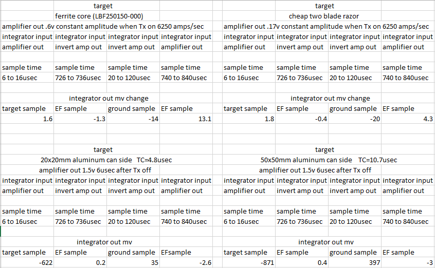

                            cr_2.zip seems to make more sense than cr.zip. A long time constant target(10000usec)is still the only way I've found to make the simulation look like the bench scope picture for a ferrite core. A 10000usec target should have very little decay after Tx off. Charted some data looking at integrator out. Integrator gain, X1 for 10usec sample or X10 for 100usec sample. Amplifier gain about X450. Integrator out amplitude is fairly constant with decay time with the ferrite core. Not perfect, but with 100uv integrator out resolution, integrator gain X1/450 amplifier gain(.22uv resolution at coil) maybe close enough. Charted change in integrator out amplitude, target minus no target looking at one sample with other samples disabled. The stainless razor looked flat on the scope with constant rate Tx on but isn't as flat as the ferrite core after Tx off, so maybe long time constant target still questionable.

                                Tried sampling 1x1inch aluminum foil at 740 to 840usec after Tx off. Get a change in reading about minus 1/10 the ferrite core. Think there should be no change for such a short TC target. No change if I disable Tx driver command. Change increases if I increase the 1x1inch foil layers(1,2,3,4 or 5). Any suggestions why I get change in integrator output or something to try.
