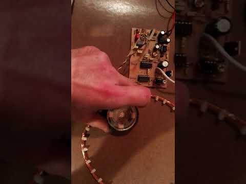

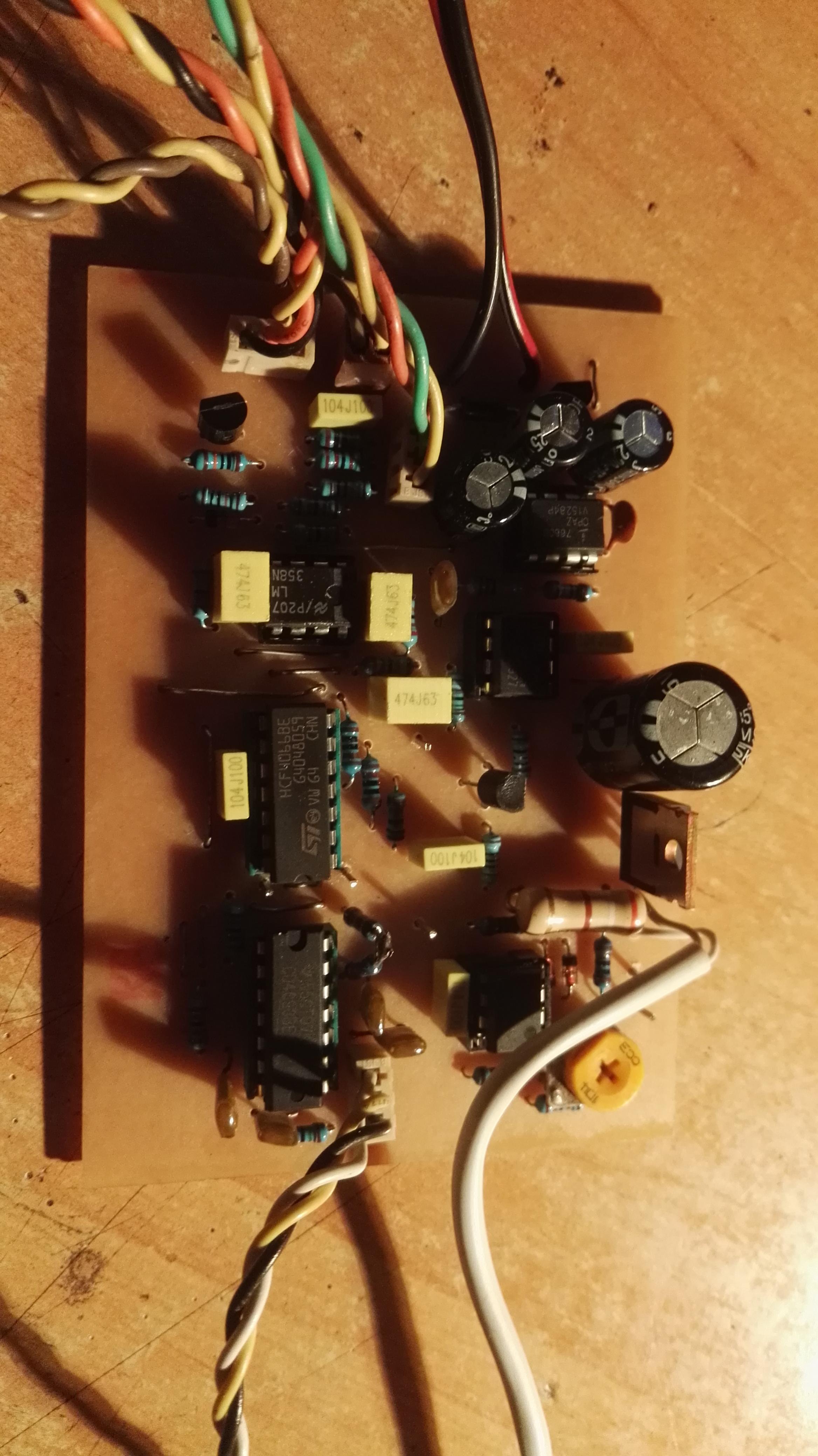

        Hello everyone. I just replaced the bc337 with a mpsa13, taking into account the reversal of pines of course, and here I get a low and continuous sound, when I try to set the offset to zero, nothing moves and I am about 2 volts and some, I am a little lost in all that. do you have a little idea about the problem, I am grateful in advance. Thank you.Click image for larger version
          inferno yup? Twilight Zone?
          can you read my opus BEFORE to make the pics?
          http://www.geotech1.com/forums/showt...here-share-out
          thank you for involving
            Oops, sorry, I'll do better photos next time, thank you for your precious help. good night
              Hello
              This is the symptoms.
              Best regards.
                try replacing ne5534. Make sure you have all components correctly soldered, check orientation of transistor legs, make sure these are correct, transistors with 2N are always ebc, while others are ecb. check orientation of ic's, check proper orientation of diodes and electrolytic caps, measure your power supply rails,+5v and-5v.
                  And you must, take better pics of top and bottom side of pcb so that if there is an obvious error on board, it can be easily spotted.

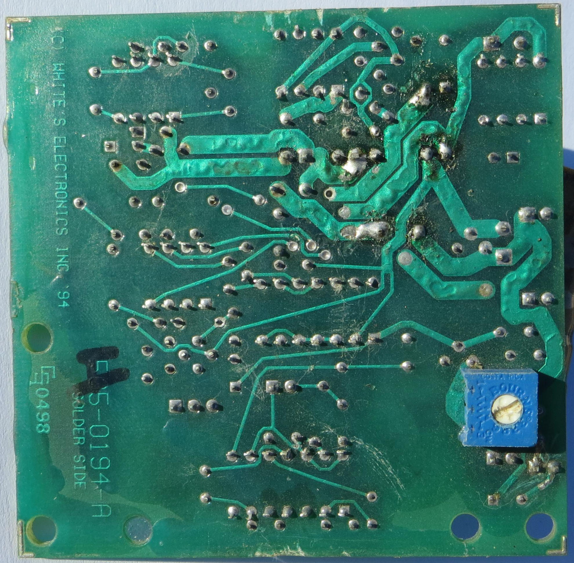

                    i ask again to send me original faulty whites board for desoldering and making a batch for all getting insult guys. what i show now
                    is absoliutely waste your time and our nerves.
                    i did that for Bara guys and i will do that for Surf guys. i see the guys take trash board pics from global net and
                    overload the forum by the hyperactivity nonsence. just they did not see original whites layout in their lifes never.
                      Good morning and thanks for your help. I will try to replace the NE5534 as you advised me dbanner.
                      kt315, I do not seek to insult anyone on this forum, I have great respect for those who bring me their help, that's why I'm going to do the necessary to make beautiful photos, exploitable to be able to better diagnose the failure. To make the necessary measurements also, this scheme has already been realized again and again and given as being functional, so I do not understand why I would not be able to realize it, now, it is true that it is not the original from White's!

                        original board is virtuozzo professionally traced board. believe me now. i am constructor and
                        i see those boards are TOP OF ART. you - like dummies - sorry for english - are not able
                        to see be cause YOUR BASIC in the electronics is very small. WE MUST DO BETTER layout than
                        Whites does!
                        THAT ALL I TRY TO TELL YOU. trash is only trash! no issue no chance to mod soviet LADA

                          Hello!
                          Your coil is to close to the circuit. Keep the coil at least 1 meter away of any metal. To adjust offset you need oscilloscope, or use forum search to find out more about setting opamp zero volt. Play with threshold pot, need to be on the edge of sound, almost silent. Play also with delay pot, if to low, lower than your coil can go will have poor response or none! if too large will not be sensitive to coins.
