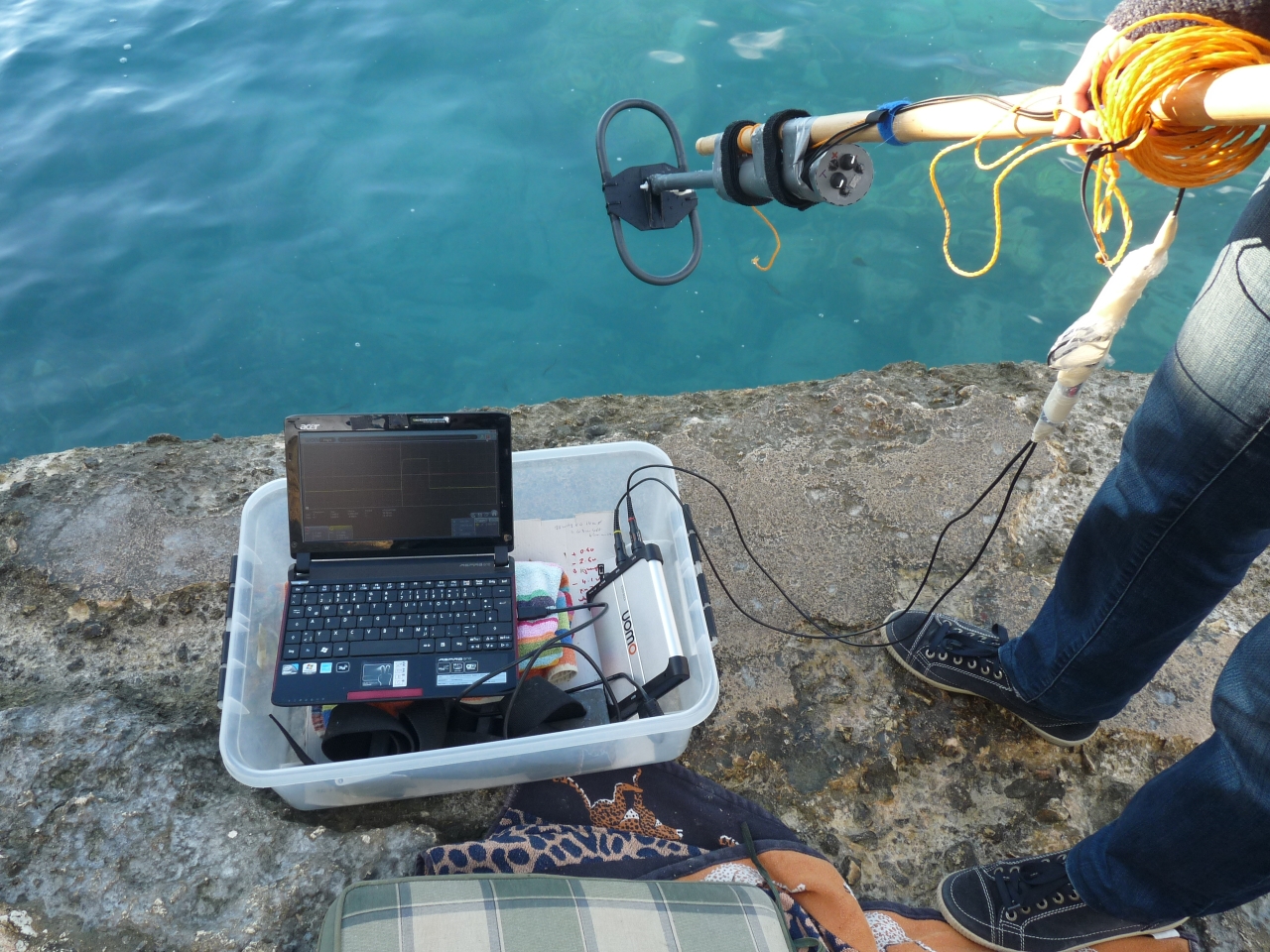

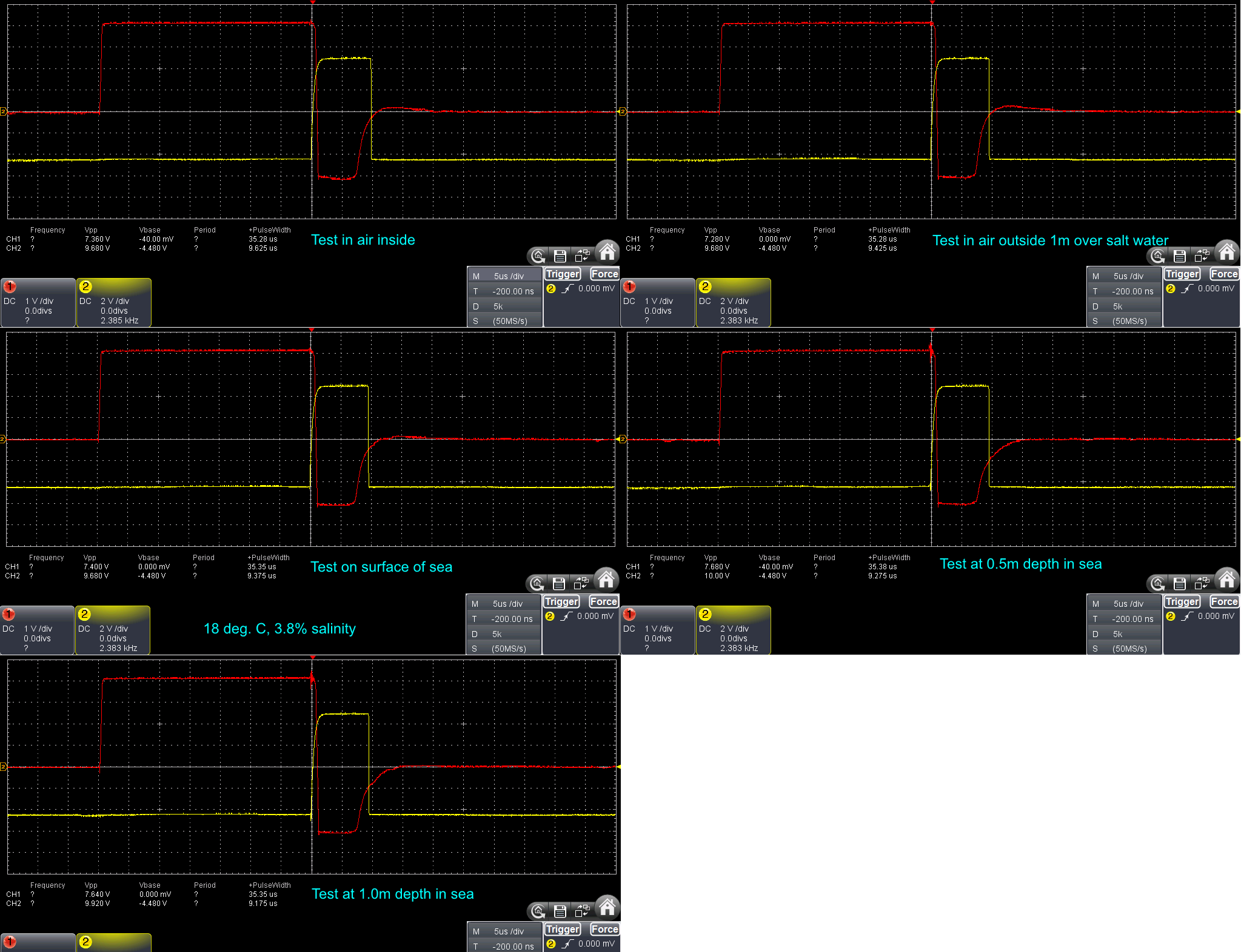

    The swell was finally low today, so I wrapped everthing up and went to the sea.
    I've been building a snorkelling Surf Pi and wanted to see what happens to the curves
    when it gets in the water.
    The results actually amazed me and the signals were not as "influenced" as I feared they might be.
    If there are other things to measure in the water or I missed something, ask, I might just do it ...
    Anyway here my results (I only took one photo of the setup and I'm even happy about that, cause taking photos distracts me):

    I would say that you have a good shield with these results. But, from the picture of the coil, i don't know if you have one...

      Thanks good pictures, haven't got my detector to the beach yet. Looks like you have about .8v change at 10usec and maybe a visible change out close to 20usec. More than I was hoping. Was expecting the decay to be much faster.

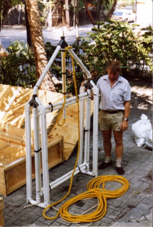

                Although sea water is a very poor conductor relative to metal objects, it is the spherical volume that the search coil energises that accounts for the length of the decay. Small coils will energise less volume and give a faster decay. Large coils, such as the 42 inch square coil mounted on a sled, in 50ft of water will have a decay reaching out to 200uS. This coil was used to locate 70 pound silver bars which have a decay of their own out to 8 milliseconds, so the late sampling of 250uS did not matter.
                Eric.Click image for larger version

                    I'd love to, but don't know which details to start with. Give me some pointers please.
                    Anyway the top,mid,bottom (coil) sections are separately sealed, so if a section goes leaky, it can't spread to the rest.
                    Still figuring out which wax to drown the pcb in once I've thoroughly end-cleaned it.

                      Nope, no shield - I hope that's not a "uh oh".
                      I went the next night to test if the annoying EMI I have on it is still there when coil is in salt water.
                      It was still there. So I figure it's gotta be something on the pcb. Grrrr...
                      The ambient temperature was 10 degrees lower this time and was notable on the decay curve or perhaps it was because of battery voltage lower.

                          try increase pps

                              I have tried this going up to about 4.5 k pps. Same results.
