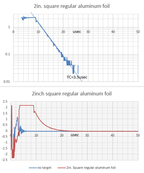

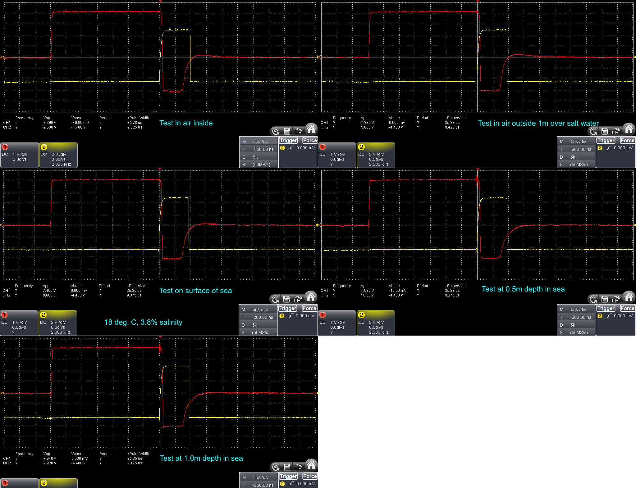

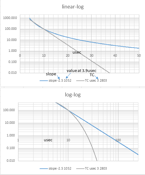

Comparing charts, .5M under vs 1M over sea. Looks like at 10usec .5M under maybe 1v difference, at 20usec .5M under maybe .05v difference. http://www.geotech1.com/forums/attac...8&d=1545261608 shows a similar change. No way could see straight line decay at 200usec delay unless amplifier was saturated for over 150usec. Been trying to generate a power slope with similar volts at 10 and 20usec that could see at 200usec. No success. Is there something other than signal increase causing saturation or slope changing to see salt water at 200usec delay? Any thoughts on what I'm missing?
