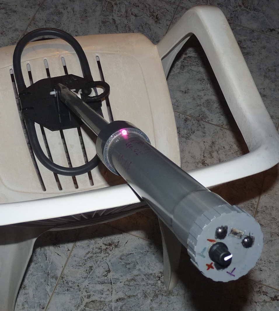

      @Polymer
      Where did you place the indicating LED?
      The LED is near the switches but I am also not happy with it’s visibility.

      I think the visibility of it decreases in water because the rounded end is a lens and this no longer focusses the light into a narrow beam when submerged.
      This is probably due to the refractive indices of the plastic lens and water being very similar so the light simply radiates over 180 degrees from the point source (chip).
      In his underwater Pickini Bernard used an internal loud piezo buzzer in conjunction with a simple driver transistor circuit. I guess there was sufficient sound transmission through his waterproof case to make it audible under water but it would probably be fairly ‘heavy’ on batteries.
      Also, the thicker PVC pipe housing you and I have used may attenuate the sound more than his case.

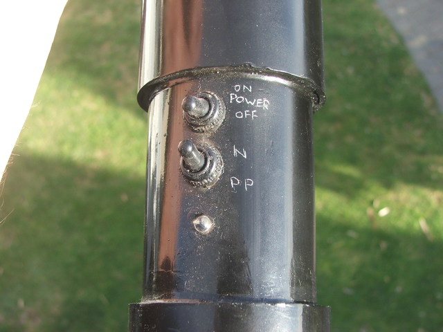

        Thanks for the picture. Looks like you have a PP mode aka static mode on the switch?
        My LED is bright enough and I filed it to around 45 degress so it faces to me.

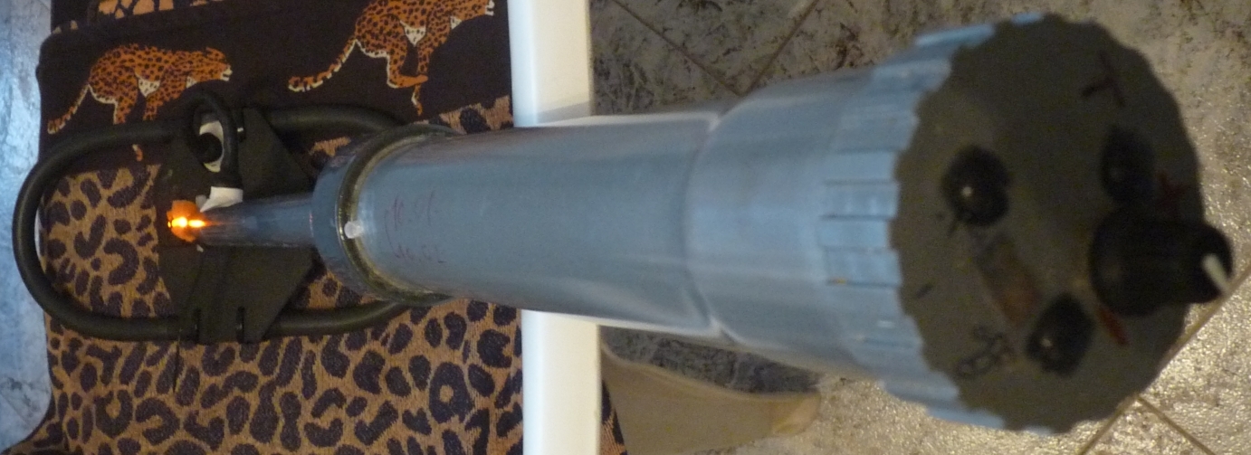

        Here two pics of my LED:
          Yep! - works well as long as I remember to switch back to 'motion' when I continue searching. This SOB (silly old b...) tends to be a bit forgetful in his old age!

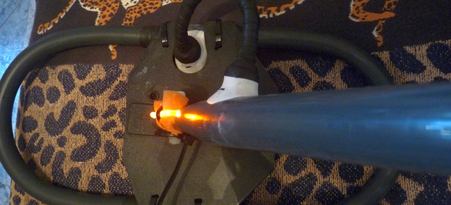

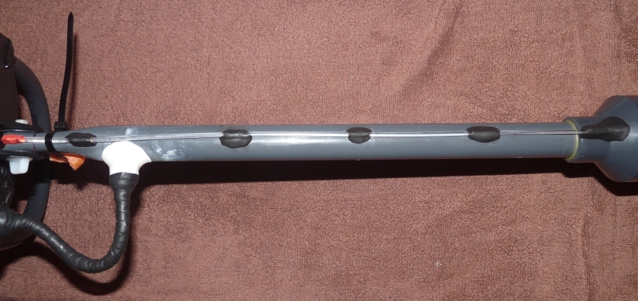

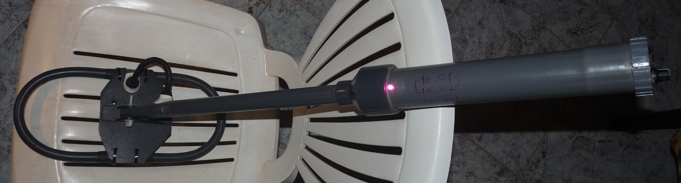

            The fibre went well and is much better than the LED postion before, because the light indicator has roughly the same optical depth as the coil now.
            It was a quick job and has survived 5 hrs now with a hefty swell coming in the last hour and the detector and me getting thrown often. Went bodysurfing later on with the Misses.
            I am more confident now in the watertightness of my design after that beating. I am still not happy with the "holding" ergonomics though, got sore hands. Pipe to thick.
            Here's some pics of the fibreoptic. Wanted bright blue, but I drilled a little to deep into the led for the fibreoptic (dia. 3mm) and destroyed that one. Have to get new LEDS.
            I might get sheathed fibre next time. This one you can bend with heat, it's PMMA. Here some pics:
Name:	Fibreoptic front side.jpg
Name:	Fibreoptic front side_close.jpg
Name:	Fibreoptic back side.jpg

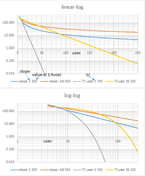

                  No discussion. Made a couple charts comparing decay slopes. Straight line linear-log and straight line log-log to show why it would make more sense if salt decayed straight line log-log if signal can be seen at 200usec. Not saying it does, sure would like to see a salt decay curve out to 200usec+.

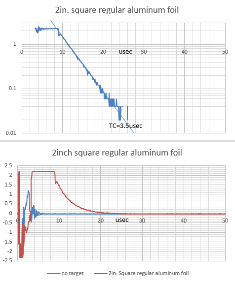

                      Polymer, Reply #1 you recorded some good traces. Have you tried subtracting the air trace from the water trace in a program like Excel and charting the result linear-log and log-log?

                        No, I havn't. I think my oscilloscope can store values numerically. I would have to read up on this.

                            Excel accepts csv which my scope has. Record a no target and a target recording with scope. Copy recordings to Excel. Subtract no target from target recording and chart XY. Depends on no or very little circuit drift between recordings. I try to keep time between recordings to a minimum. scope scale, .5v/div seems to be best with my scope. Both recordings need same trigger at Tx off, your scope recordings reply#1 look like they do. I use Excel because that's what I have, probably other programs that would work. Any questions, ask.

                              Hell yes, my oscilloscope can save the current values as data files! Four different types actually. It does 5000 values per file @ 1us/div, 20 divs.
                              So if I divide this correctly that would mean 250 data points per 1us, or one per 4ns. Is that correct?
                              Here are my test file examples: dang ... could not upload any of the four test files .bin .csv .txt .xls.
                              The .txt file is supposedly too big to be uploaded (ca. 168k) and the others are "invalid". Dunno what to do about that.
                              Anyways, I did manage to get the data into openoffice and make some curves. The graphs are quite lumpy for my taste though.
                              I have downloaded scilab and will try and get along with that to get some finer detail curves.
                              Recording with no target in the sea (just decay in saltwater) is relatively easy. Can do that.
                              Measuring with a target looks like a challenge at say 4m max. depth and keeping the distance equal for all
                              measurements at say 0.5m depth increments. Any ideas or does it not matter?

                                The sea is the target, no target would be away from the sea in the air. Charting a target on the bench is first, was thinking a 2inch square of regular aluminum foil would be a good place to start. Sample at 5usec/div for the foil. Maybe you could post a picture of your chart with 2inch square regular srength aluminum foil.
                                You need to be able chart linear-log and maybe log-log if the target doesn't chart straight line linear-log with sea as target. Just my thoughts maybe some knows what the slope is and if it changes with depth.
