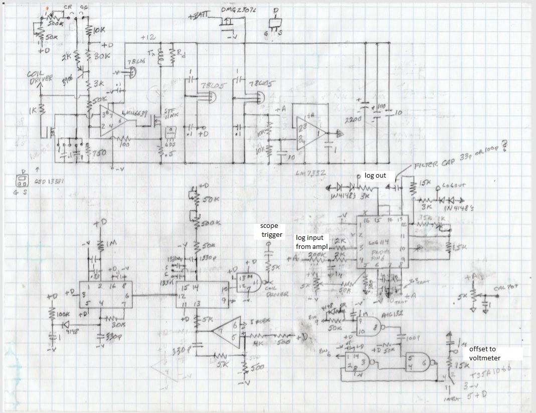

        Including the schematic of the TRT tester that was posted in another thread. I labeled the output off pin 14, am using output off pin 12. Schematic doesn't show Rx(2 round coils connected figure eight) and differential amplifier(Rx damping resistor connected across input)
        Tx(on schematic surrounds Rx). The coil is balanced for zero signal at amplifier out when Tx on and off. Recorded the signal during Tx on and off. Normally don't record during Tx on, noisier and a PI uses decay Tx off.
        • Looking at schematic reply#168. Doesn't show MUR460 diode in series with Tx coil. Tried it both ways, ended with it included. Tx in a constant current loop or constant rate loop. Wasn't thinking about effect Tx(Rd) has on constant rate coil current. Need to determine if a problem.

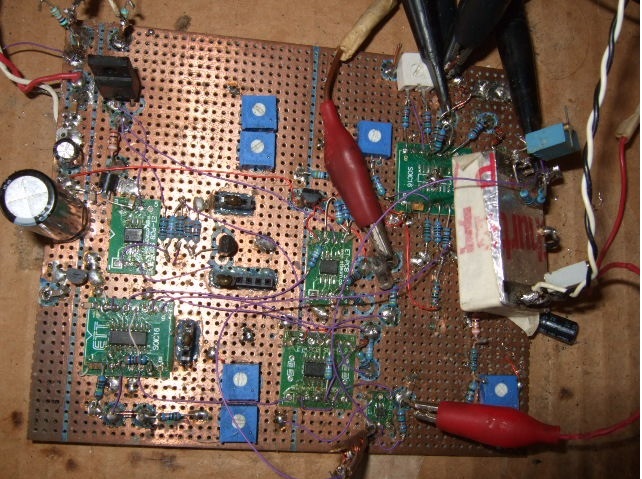

              Including photo of board.

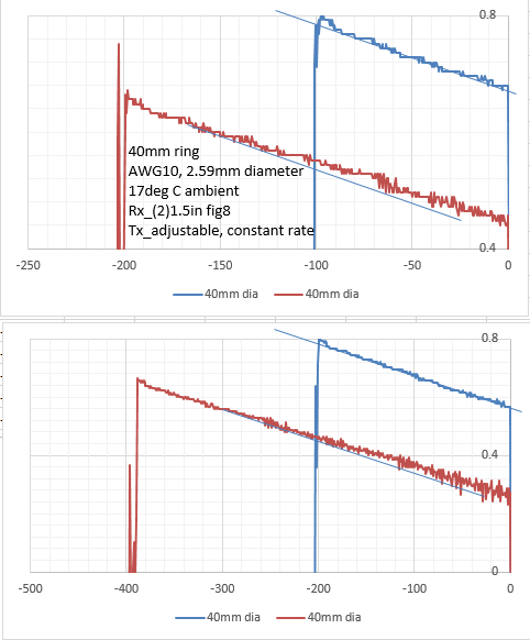

              Another test, Tx on with AWG10 40mm ring. Tx time 100us, adjusted space(target to coil)for near full scale reading. Recorded data 100 and 200us Tx, target not moved.
              Then adjusted space(target to coil)for near full scale reading at 200us Tx. Recorded data 200 and 400us Tx, target not moved. Charted data. Inserted a line parallel to the shorter Tx, added a second line same slope and positioned it near the longer Tx. Appears the shorter the Tx the steeper the decay slope(shorter TC). Could skin effect be the cause?
              Forgot to add, Y axis, log scale .4V/decade, 25mV in=0V out to chart.
              12V battery
              board, copper both sides, top three sections, left (12V), middle digital (5V), right (analog common), bottom(-battery)

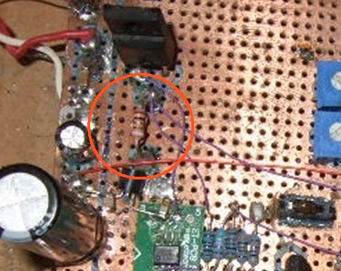

              • Oh! That's ... a work in progress. It raises a number of questions ... is that why you have noise concerns ? Is that why you get odd, inconsistent data?.
                More specifically: long leads flapping around when there's a high-current pulse generator nearby isn't good. And the general spread-out nature of it raises issues about the quality of the ground(s) and the power supplies.
                And all the advice about power supply connection, decoupling connection, having the star point at the 0.5R ( I assume it's two 1R0's on top of each other?), needs implementing.
                And re: my idea of there being too much coupling between target and Rx/Tx coils, I've just taken a fresh look at some charts you posted a few days ago:
                ..and noticed that targets on top of the coil gave slightly lower TC's than those 16mm away, which supports my thinking. Though it is only a slight change.
                Seeing as the 40mm test coils are very similar in size to half of your 1.5" 8-coil, I wonder if they show this effect more strongly? Just an idea, I guess too close and you'll just get overloaded RX amp problems?
                And re: the latest 100/200/400us slope, I found it hard to work out which was which at first. The shortest transmit time results in the biggest response from the target? This is related to the business of 'optimum' TX time being 4 times longer than the target TC ? But this is a 200 us target, so why doesn't 400 us give a bigger response.? Non-expert here, don't forget.

                  Amplitude is proportional to rate, Tx on. One half the Tx time, twice the rate(1A peak). Should be twice the signal. Close to 3divisions near start of decay(3divisions=twice the signal). Same with your VLF, double Tx amplitude doubles Rx signal?
                  Noise is lower with Rx input shorted. Coil pickup causing a lot of the noise, some coming from the scope.
                  ( I assume it's two 1R0's on top of each other?)1RO's? I used one board, copper both sides?
                  • Two 1R0's means two one Ohm resistors. It's common engineering practice to replace the easily-lost decimal point with the multiplier, example 2K2, 1M5, 4R7, R22 for: 2.2K, 1.5M, 4.7R, 0.22R.
                    These fellows, one hiding under the other:
