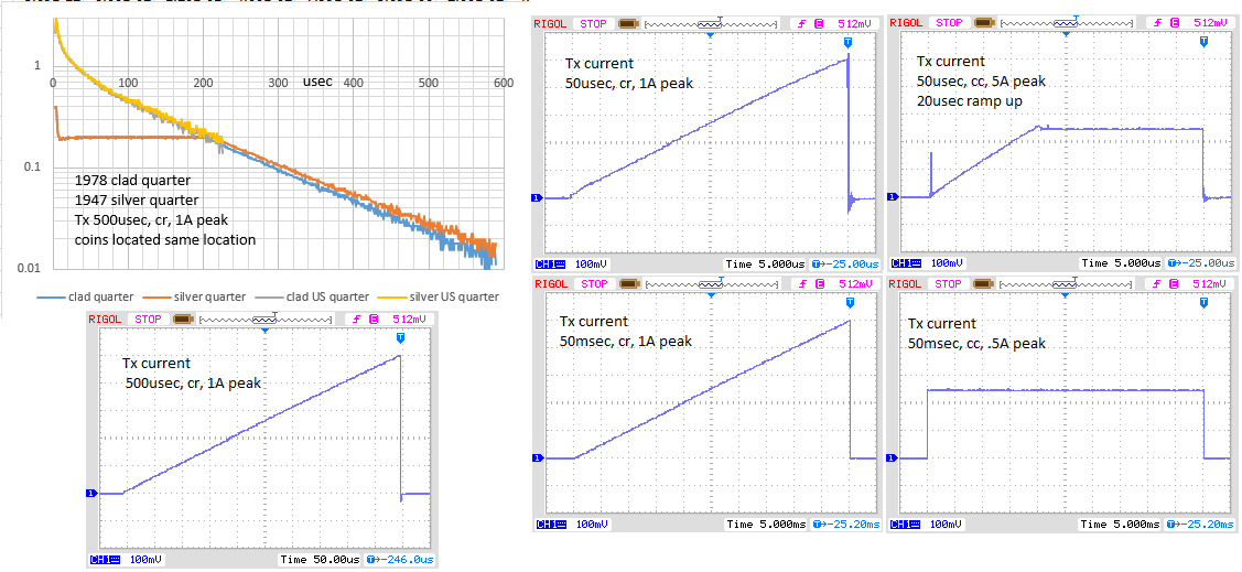

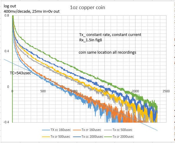

      500usec Tx width used for the 1oz copper coin is longer than I use with my detector. Recorded constant rate and constant current at 160usec Tx width that I normally use and charted with the 500 and 2000usec Tx width's.

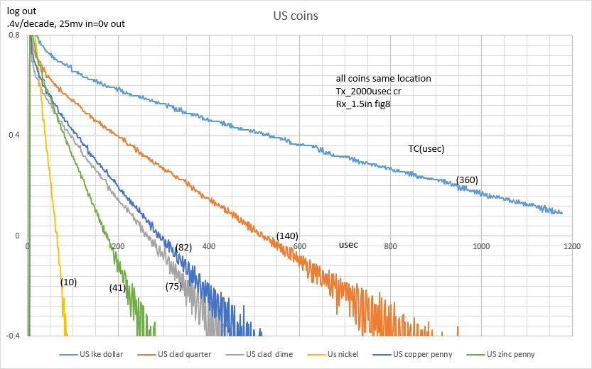

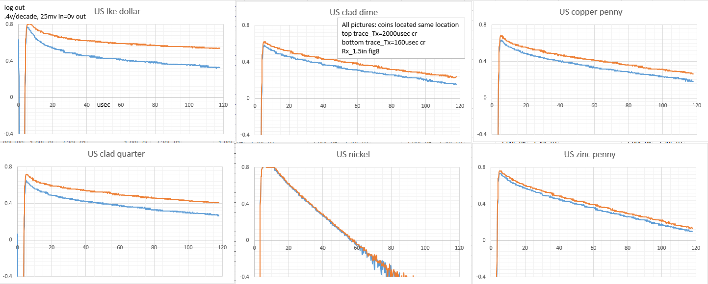

        Test with some US coins. Recorded at 160usec Tx width and 2000usec Tx width to show increase in signal if Tx width was 4 or 5 times target TC vs 160usec Tx width I normally use. Another chart with Tx=2000usec to get target TC.

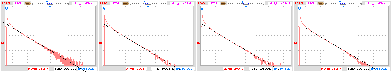

          Tried storing scope data with average sample and normal sample(clad quarter). I was thinking it only effected the scope screen. Averaging helped copied data to Excel also. I see I forgot to label pictures. First is normal sample, second is 2 averages, third is 4 averages and forth is 8 averages. Looks like 2 averages cleans up some of the noise and is probably as good or better than the others. Average trace good to maybe 300mv below zero where the noise would cause the signal to go below zero volts.

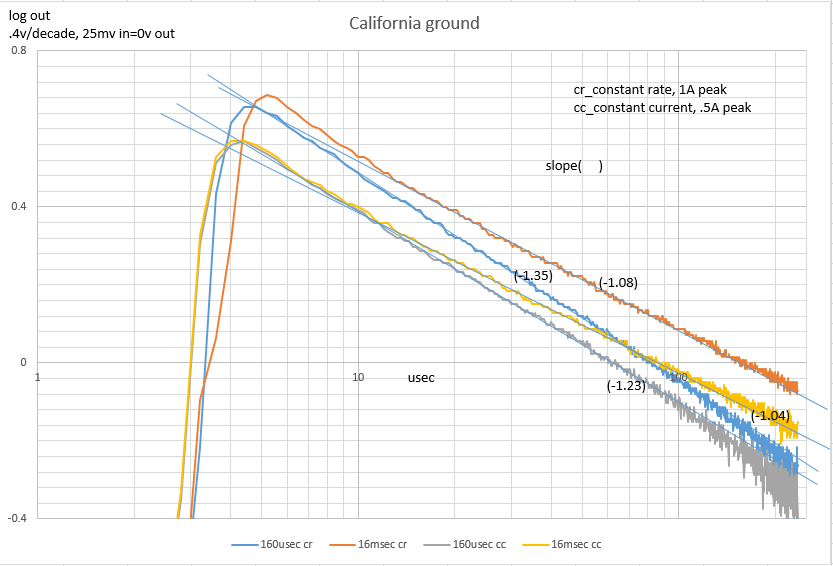

                Good to hear you are getting better. I'm happy with the LOG114 amplifier, can get 4decades with capacitor discharging into input. My PI amplifier noise is limiting me to maybe 2 octaves over 2decades.I always get a ground decay slope greater than -1 with my normal Tx width's. Got -1 with 16msec Tx awhile back with the method of charting data I was using. Tried today with 160usec and 16msec cr and cc TX. Close to -1 with 16msec Tx. Interested in what you get for ground when you finish your test setup.

                  Was looking at ground chart TRT_21 reply #82. Noticed 160usec Tx has a straight line decay back to <6usec. The 16msec Tx is less steep back to a little over 10usec where it has a slope similar to the 160usec Tx. Any thoughts why this would be?

                    I think you are in uncharted water if you use pulse shapes other than rectangular cc. A paper by Dabas, Jolivet and Tabbagh, 'Magnetic susceptibility and viscosity of soils in a a weak time varying field', state 'Between 5 and 180uS a best fitting power law of -0.99 has been derived taking into account the finite rising time and decay time of the transmitter pulse. Trials with slightly different pulse shapes and pulse durations exhibit a calculated scatter in the power law ranging from -0.8 to -1.4.' The pulse used to obtain -0.99 was 370uS wide of which 320uS was cc and a switch off time of 2uS.

                      Including a chart posted earlier showing current profile for my tester. The constant current has a 20usec ramp up to constant current. Would that be considered constant current or would the time to get to constant current need to be a lot shorter? I added a constant rate pulse to simulate a low resistance coil where Tx width was less than the coil time constant. I have two reasons for charting the ground decay. #1, how accurate can I chart the decay. #2, what is the decay slope and what variables effect the decay. The log amplifier has made the decay trace cleaner and I see things that I didn't see before. Tx width and shape effect decay slope. Wanting to see what decay slope you get when you add the log amplifier to your circuit.

                          Current is in a control loop. Constant current commands .5 amp(.25v to control loop) but it takes about 20usec to get the current to .5amps where it levels off at .5amp. Tx width adjustable from 50usec to 50000usec.
                          Or is this just due to the time scale of the scope trace, the rise is not seen since it is rises in useconds. If this is true then are you limiting the current rise in thegraph before this?
                          Yes, can't see 20usec rise with 5000usec/div. The scope is measuring the volts across a .5 ohm feedback resistor in series with mosfet source with scope trigger sensing Tx off. Yes, constant rate command to the control loop, is charging a capacitor with an adjustable current source. Capacitor charge adjustable from 10vsec to 10000v/sec.

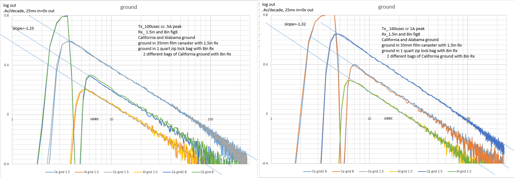

                              • #90
                                Some ground comparison charts using the log amp. Two bags of California ground, one measures about 1.25 inches thick laying flat and the other about 1 inch thick recorded with 8inch fig8 Rx coil. Some ground from the back yard compared with some California ground in 35mm film canisters with the 1.5 inch fig8 Rx coil. The recordings were done in sequence at bottom of chart to check repeatability. The Alabama and California ground chart the same slope but it would be hard to tell if they GEB at the same settings. Recordings are amplifier out, integrator in. The integrator filters the signal a lot, can easily detect a signal change 2 decades below the 0 line(25mv). Both did GB at the same settings with my bench circuit before I zapped it. Coil size and sample size didn't seem to effect decay slope.
