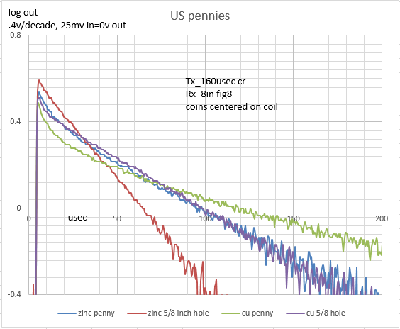

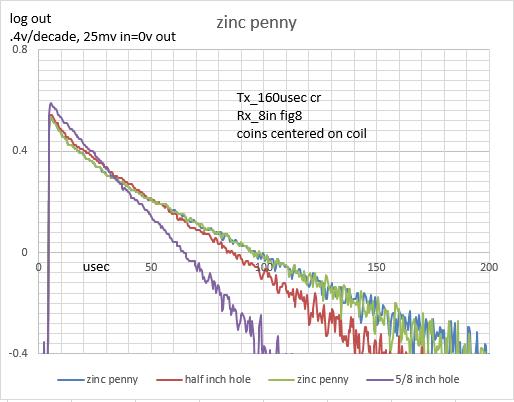

    I used a zinc penny because that is what ITMD used when they compared a solid coin with one with a 5/8 inch hole. Think it's not a bad target because it has little skin effect. Carved the 1/2 inch hole out to near 5/8, not perfect but real close. Added another penny recording and the 5/8 inch hole recording to the chart.

        ITMD copy right 2012. My error, page 53 says 2 pre-zinc US Lincoln cents. I missed the pre when I read it.

          • Chart with zinc and pre zinc US penny.

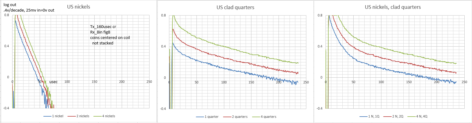

            • More charts. Did some awhile back with 1,2,3 4 and 5 coins. Doubling number of coins doubled Rx signal so this time just did 1, 2 and 4 coins. Coins side by side doesn't seem to effect decay TC so using more coins is another way to improve S/N. Still don't know if charting linear-log or log-log is better and if 250usec is long enough. 250usec isn't long enough to get true TC for some targets but does it matter unless looking for silver bars?

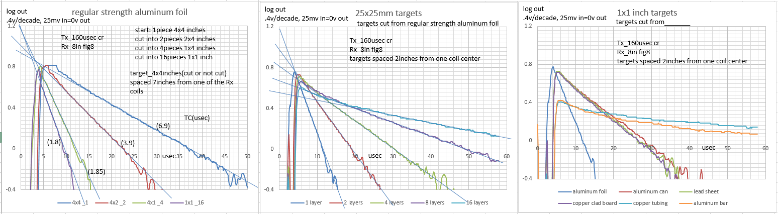

                  • Some charts, some observations. First chart started with a 4x4inch piece of aluminum foil and cut into pieces. Example time constant is controlled by width not length, 1x4inch almost the same TC as 1x1inch targets. Second chart, shorter TC targets project higher amplitude at Tx off. Appears doubling TC reduces projected amplitude about half at Tx off. Does anyone know what should happen with same width targets when TC is changed? Third chart, aluminum can, lead sheet and copper clad board chart almost he same.

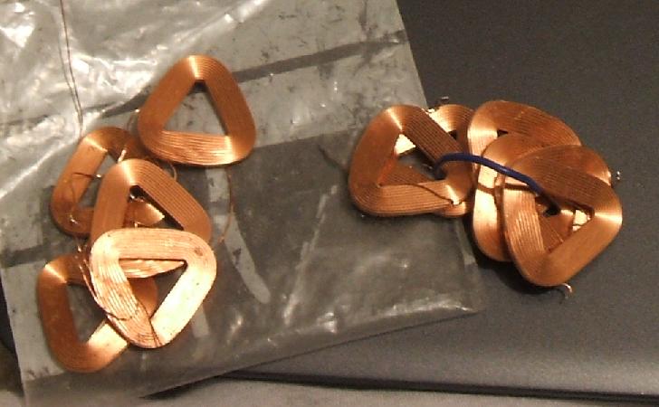

                      I have successfully used a synthetic test target made from a machine-wound self-bonded coil, salvaged from a 3.5" floppy disk drive spindle motor.
                      Picture attached.
                      There's 6 in a drive, all identical, I was going to send you two of them. L was 880 uH, R = 6.2 Ohms, so shorted out, they can mimic close to silver Dollar, and as short a TC as you want with a resistor on the ends.

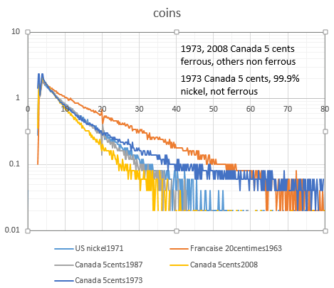

                            Some where I had some coins from European countries, was stationed in Europe 1960, 1961, and 1962. A chart posted awhile back with some other coins I got when doing some testing in Canada, should have some from Europe also. I'll try to find the other coins. We had some jars with US coins and some silver dollars but a thief got those.

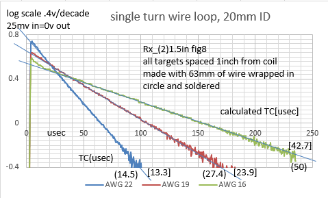

                              • Tested some single turn wire loops awhile back with AWG19 wire, 20 40 and 80mm diameter. Don't know where I posted the data. Measured TC was higher than calculated. Tested 20mm diameter loop with AWG22, 19 and 16 that I've been playing with. They measured a higher TC than calculated also. When I first made them I thought the solder joint would make total resistance higher which would make measured TC lower than calculated(TC=L/R). Maybe I'm doing something wrong? Looks like a way to make higher TC targets with close to straight line linear-log decay at low delay times.
                                Don't know if it makes sense. Single loop has a TC about 10 times straight wire.
