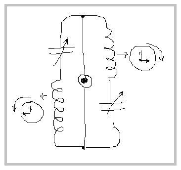

            Best ideja NIKOLA TESLA
            Wotch
