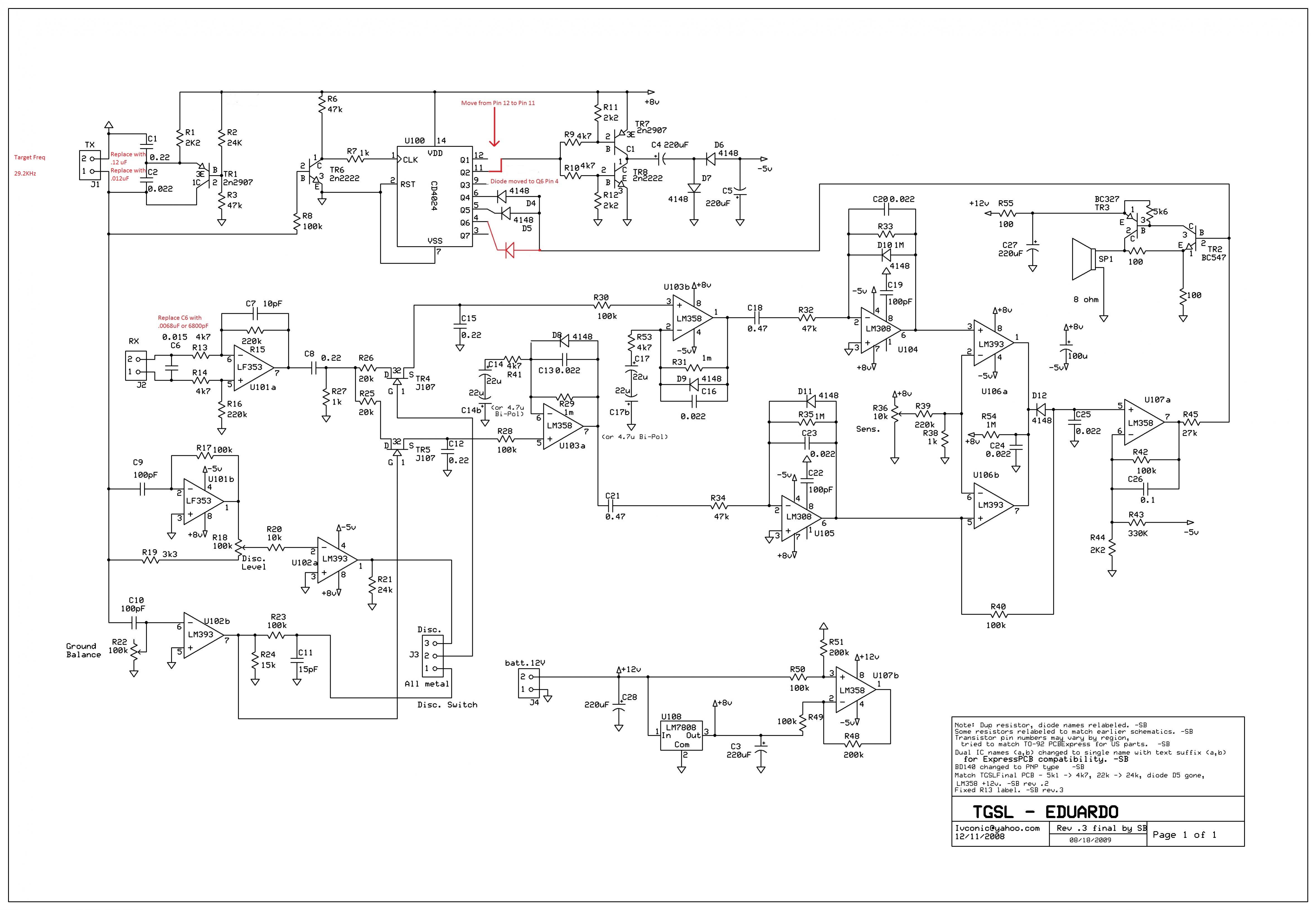

                      • In my some day box I have a few TGSL PCB's from SilverDog. I'm going to see if I can get one to run at 29Khz. Just messing I came up with this so far. Click image for larger version
                        • so I just finished testing. I built a 28 cm coil. I dropped the highest frequency at 14 kHz and the other is the original frequency at 6.6. I have not managed to do a perfect and identical nulling for each frequency if it is good for 14 kHz then it is not for 6.6 and vice versa. .... For the IDX I think the maximum frequency for the discri and the GB works perfectly, must be between 12 and 14 khz max .. At 18 and 20, the gb and the discri did not walk properly. my dual frequency disc does not work. here I will therefore make a coil adapted to each frequency desired 6.6, 12 or 14 .. Max .. So I return to my first question: what machine to detect @ 18 or 20khz.?
