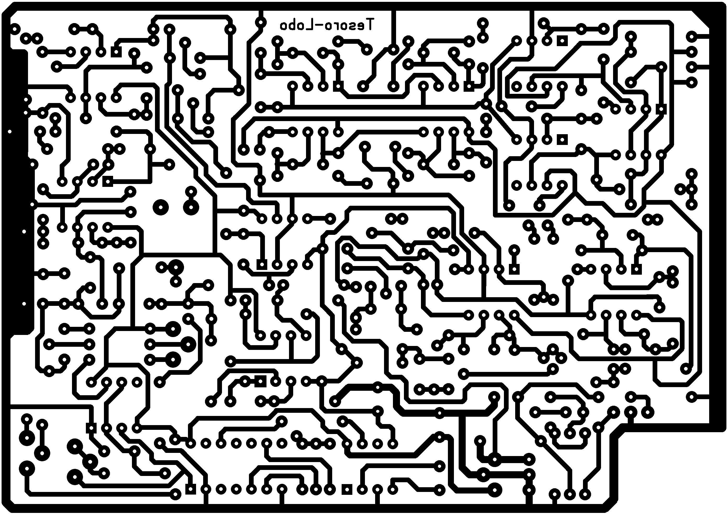

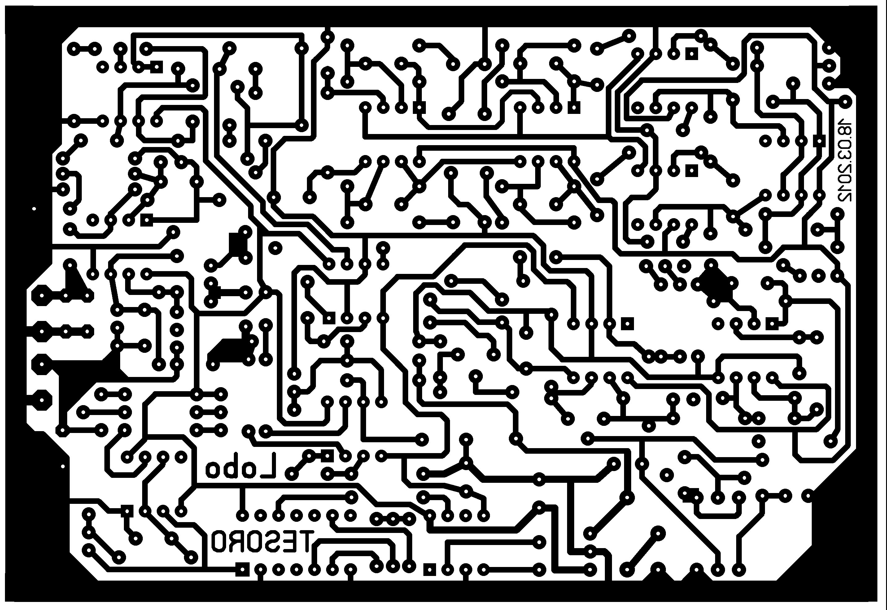

    • Original lobo works at 20khz, so says owners manual from tesoro website. I will upload the lay files, and a PDF of the PCB.
      • Now you have several layout to choose from

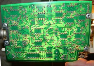

          I just ordered a Tesoro LOBO PCB board, its said to be running at 18khz

                        • I have a pcb from
                          https://www.ebay.ca/itm/Metal-Detect...YAAOSwE~xa9d77
                          But seem there are same errors.
                          One track missing around lm393
                          the treshold variable resistor have swapped pin so it do a short from +8 to -8 . central contat reversed.
                          Sameone have found more error?
