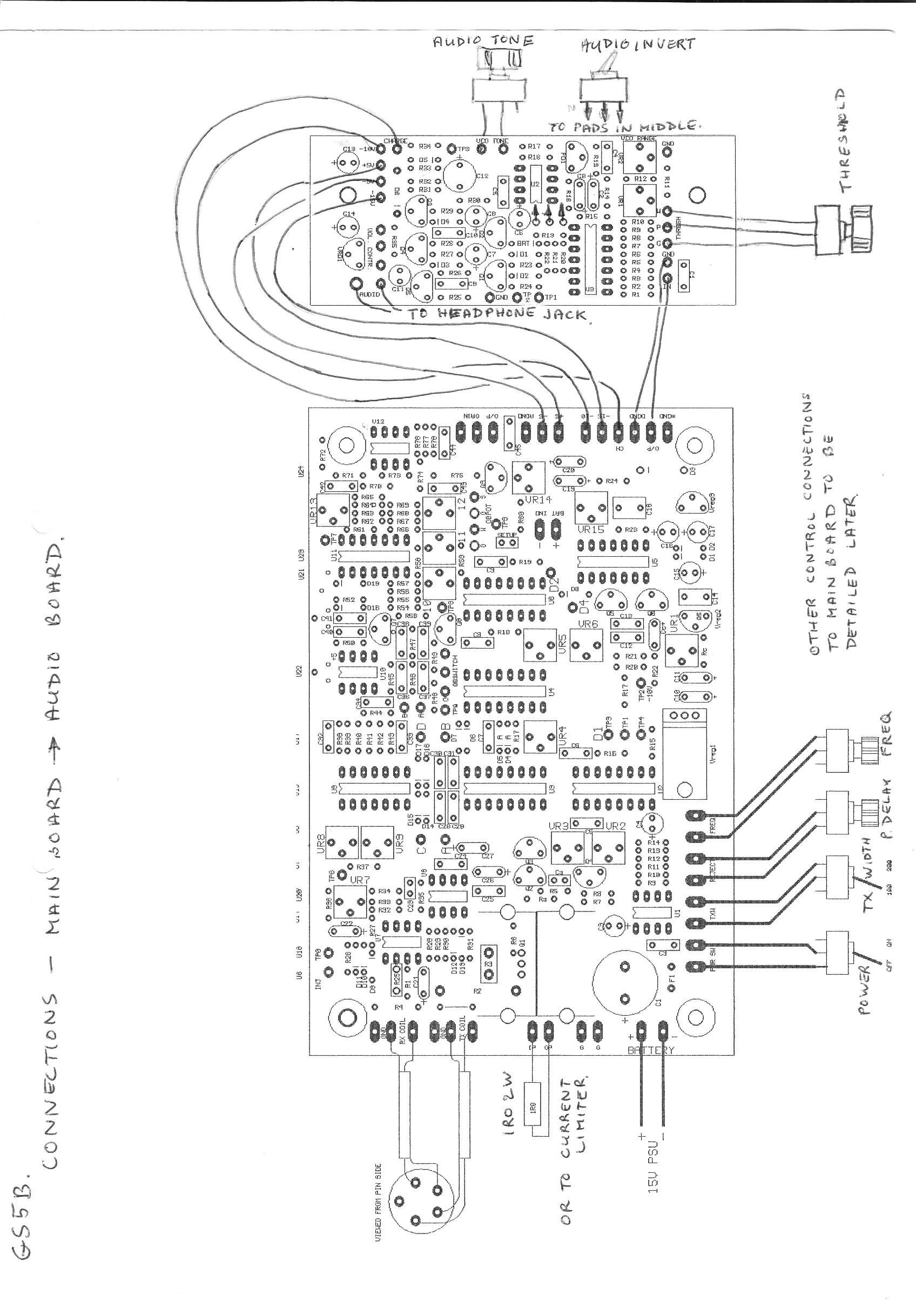

              The audio oscillator is the AD654 and the TX timer is a LMC555. Check that yours is not a standard 555 as these create a larger ripple current at the transitions. If the background tone varies when the TX frequency is changed, then it is definitely the TX that you are hearing. I have had this problem from time to time and it usually comes down to grounding. You have only got to get a small millivolt ripple on the headphone ground track for this to be audible.
              At the output end of the main board there are 3 ground pads. One is marked A gnd. which is for the analogue circuitry but on the far left end is*gnd and Dgnd, both come together at the 4700uF capacitor. The *gnd is not used and the attached diagram shows all the connections. This arrangement had no audio background that I recall. Whichever audio ground you are using, you could try the other one and see if it is better or worse.
              Eric.
                Hi Eric...I changed over the ground connection of the screened cable that go's from the end of the main pcb to the vco pcb and no change....the tx oscillator IC is a 7555 which is soldered directly into the pcb so it must be the original...the noise changes pitch when the freq control is rotated...the 1000 uF has reduced the noise but still present at low volume.

                          Maybe the TX ripple is on the -12V supply to the BC184 audio transistors. Try increasing the value of C12 (470uF) on the audio board. this and a 100ohm resistor decouple the supply to the transistors that feed the phones.
                          Eric.

                              Hi Dave,
                              Eric.
                              Hi Eric....ok will try and increase the value of C12.
                                Hi Eric....I put a 1000 uF capacitor across the 470 uF but didnt make much difference...so ive resigned myself now to using the detector has it is for now.
