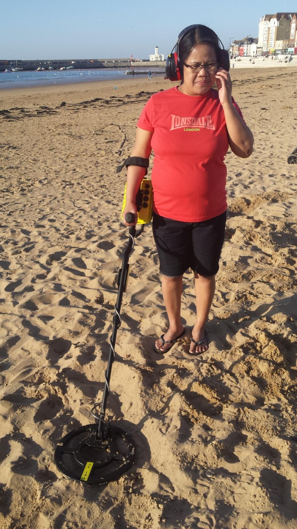

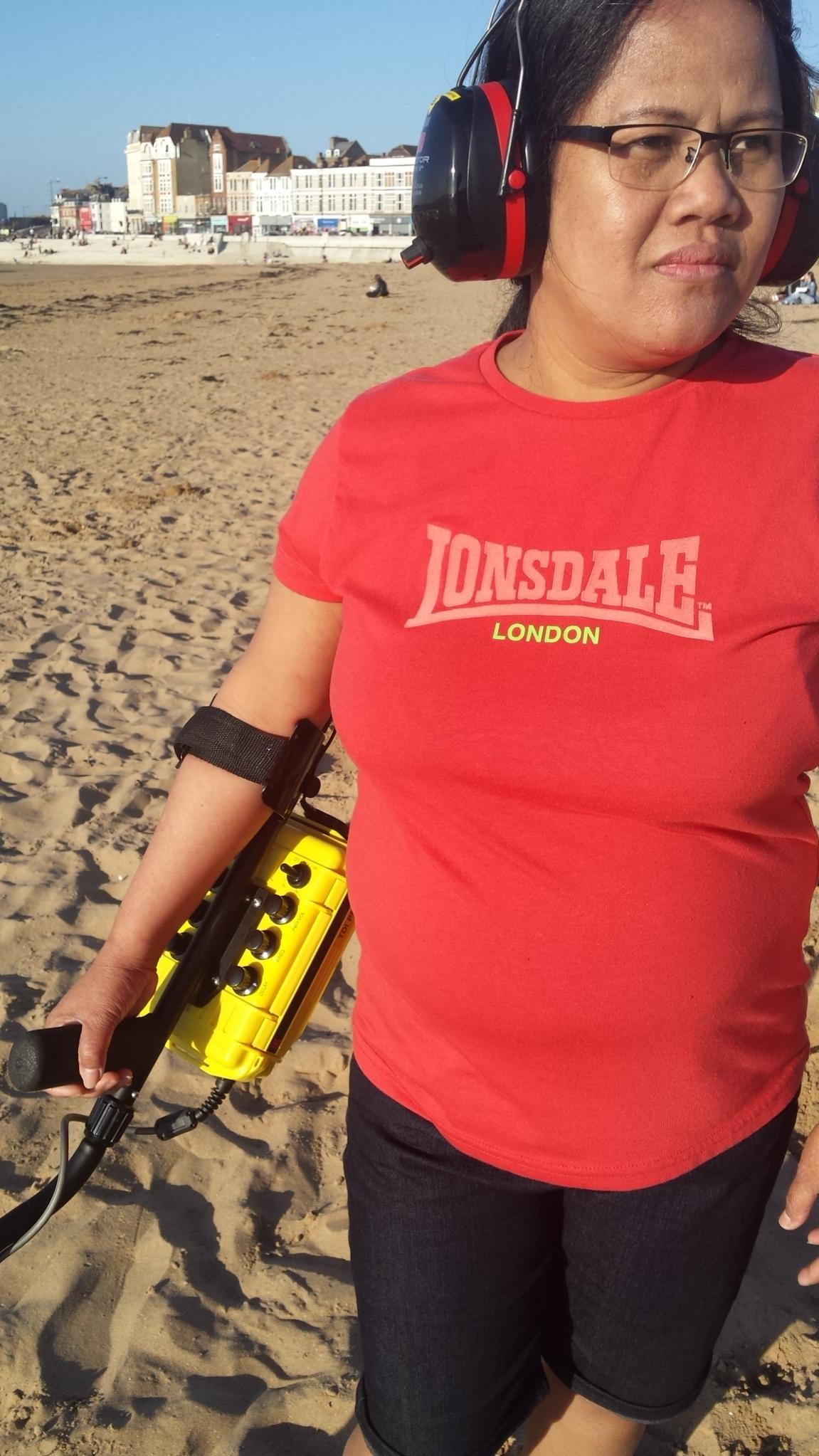

ID:	351198 took the pulsescan for its first outing to the beach a few hours ago and found some coins...my wife in the photos with the pulsescan.
      one simple thing to try daverave, I saw this on another forum somewhere, try running the coil cord straight up the stem until about half way before wrapping around stem. Its worth a try?

                      You mentioned Bluetooth headset, I'm assuming the transmitter has its own supply, or are you powered from detector supply? I would like to try this on one of my machines. The sound you described, is it a hum or is it a tic tic sort of sound? I also noticed your plastic box. Did you do this yourself. Have you promised someone not to post photos of pcb?

                        yes blue tooth transmitter and receiver headphones have their own power supply....the plastic box i bought secondhand some years ago and never used it until now...i have made it weather and surf wet sand proof...when i scoped the power supplies i can see the tx pulse train..but its reduced now by the extra capacitor.
