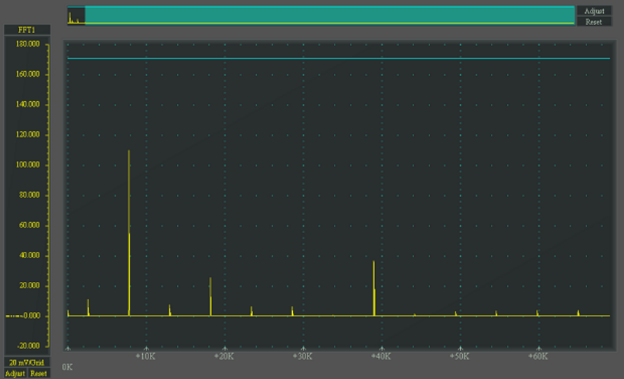

          Chiv has got the spectrum analyser function on his USB 'scope sorted out, and has measured the 'field multi' waveform. It matches the freqs we've discovered, 7.8, 18.2, 39kHz, though the amplitudes don't match, I'm not sure why. He's using a pickup loop with resistive damping to calm the self-resonance. The traces he gets are a mimic of the Transmit voltage, ie. the square wave, not the triangle current/mag field response.

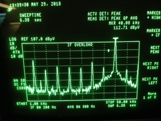

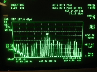

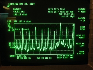

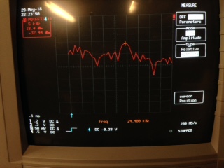

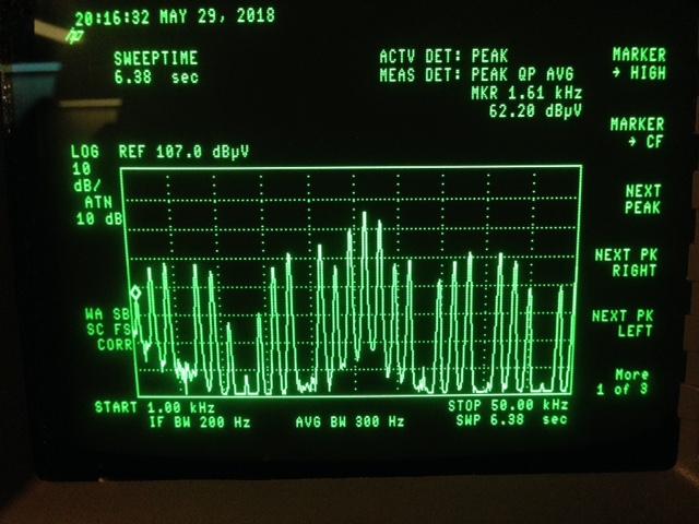

                                I started playing with the FFT function on my LeCroy LC574AL vs my HP8594EM spectrum analyzer. I used a coil of wire used for pi detector testing as the pickup coil. I first just sat the test detector right on it and later put them a couple feet apart. The FFT on the Lecroy looks pretty flakey but does show a fundamental of the HP image - just the HP has much more detail and accuracy. I really don't know FFT stuff and never had training on using it - perhaps I have it setup wrong? I would expect more stable displays on the lower frequencies with the LeCroy than I am getting. Should they be better?
                                I have an EQ800, a CTX, and an Excal II.
                                I started taking a lot of data and then I realized Noise Cancel comes into play... The EQ800 NC routine (where it counts up in 8 seconds) shuts off the TX signal the whole time. The CTX shifts the whole TX content up and down during its routine. The CTX TX signature stays the same - just everything shifts. The EQ800 TX signature will shift up or down based on what NC value is set as a result of the test or manual entry of a number. For example, the highest amplitude frequency was 37.75 KHz at setting 9 and 40.08 KHz at setting -9.
                                I took a bunch of TX measurements but messed with NC sometimes so I really need to take all the data all over again. I haven't used the HP in years so I have typical user setup issues too - like how to set KHz per graticule right. I had set start freq 1KHz and stop freq 50Khz. I am attaching some photos and am open to advice on setting parameters. I tried to attach a spreadsheet file with frequencies (not much good without photos) but it failed to upload with the photo files.
