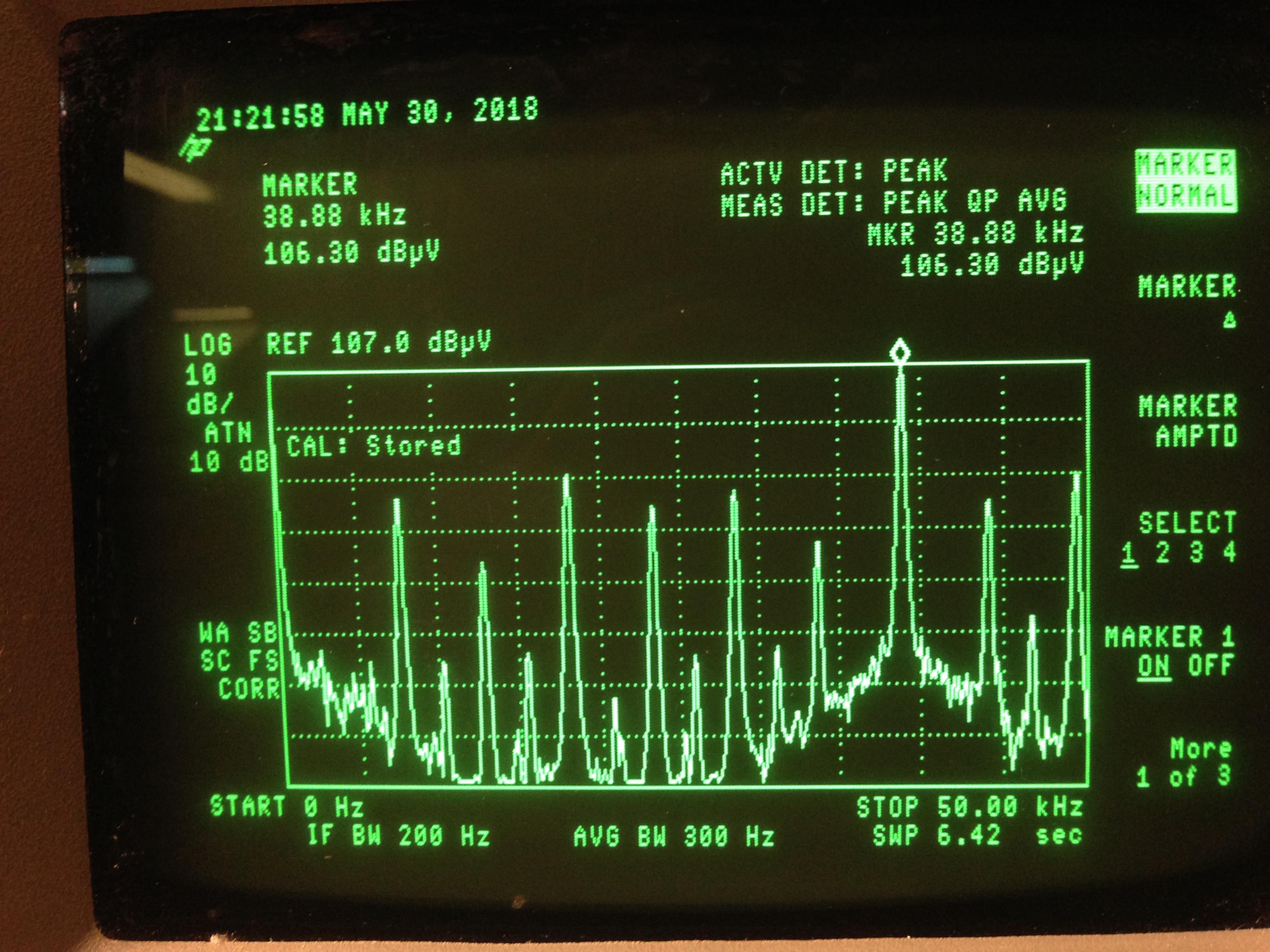

          Better photo Park1
          Here's a shot of Park1. I started with 0Khz so the graticule display makes sense.
          Frequencies of peaks: 7.75, 10.25, 12.88, 15.50, 18.133, 20.63, 23.25, 25.88, 28.50, 31.13, 33.63, 38.88 (highest), 44.13, 46.63, 49.25
          There is ringing in the pickup coil signal - do I need to dampen it or is this info basically ok?
          • #65
            Your pickup coil should be damped, though I'm not sure how much it would affect the spectrum analysis. It may put a general 'skew' on the amplitudes of the various frequencies, it looks like the higher freqs are picked up stronger with the undamped coil. You may get less noise with damping added, too.
            I don't know what equipment you have, but the simplest way to work out a reasonable damping resistor value is trial-and-error. Look at the pickup signal on a scope, (set timebase to 100 microsec/divn, maybe) and choose a resistor that makes the waveform appear the 'most square' , not much obvious over-shoot and ringing, but not so over-damped that the square edges become rounded-off. Likely R value would be 1000 Ohms to 100 Ohms.
            Failing that, it's possible to calculate an R value based on coil inductance and self-resonant frequency. The spectrum analyser will tell you the self-res freq, it will show up as a strong peak, probably in the 100kHz - 1MHz range.
            Your latest spectrum looks pretty good, though. It compares well with the one I posted earlier in the thread, with the 39kHz the strongest. We are both effectively measuring the transmit coil voltage.
