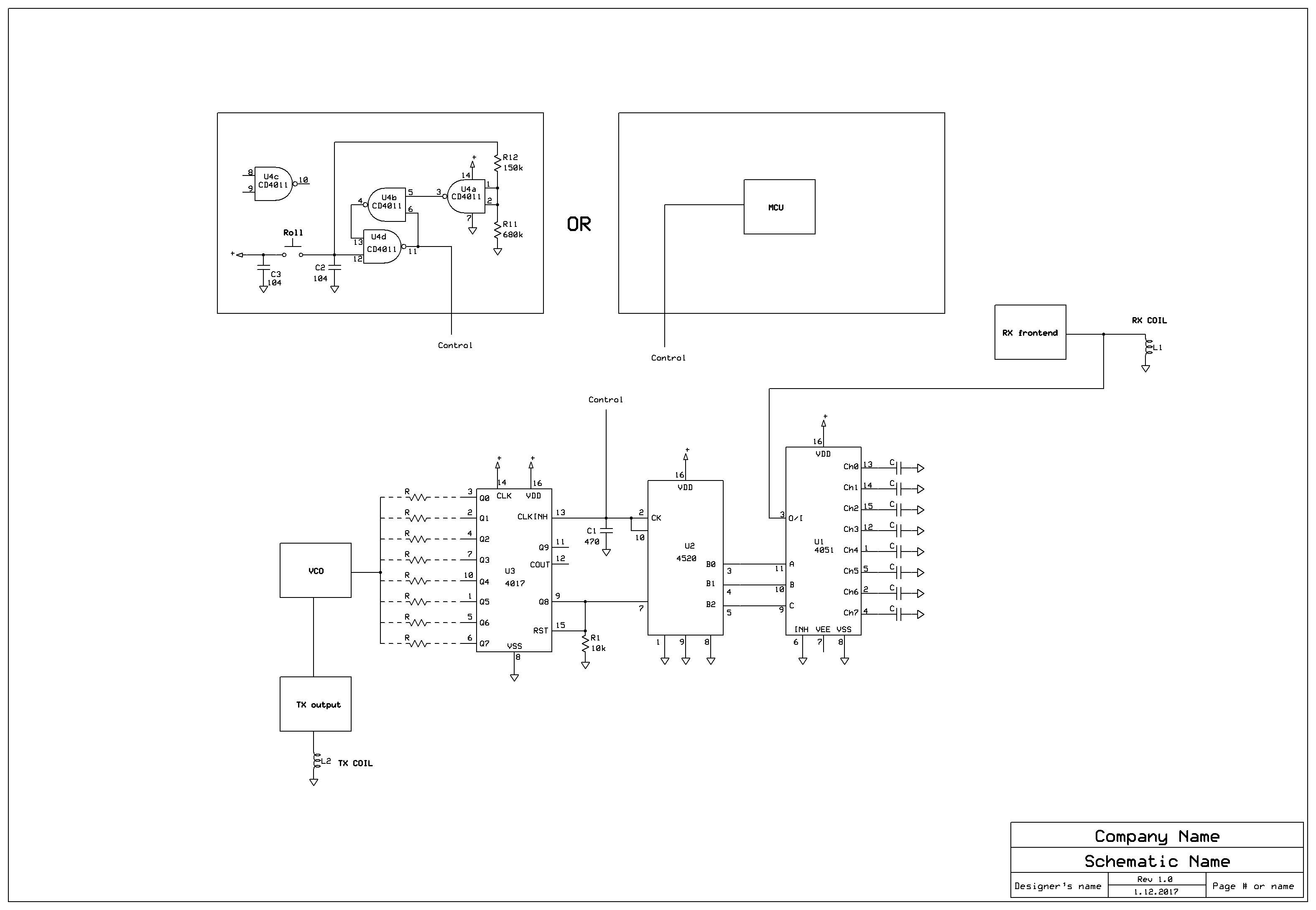

              • #97
                For single freq detectors, a frequency counter is overwhelmingly easier than a spectrum analyzer. I expect his HP has an auto-measure feature, not sure why he doesn't just use that.
                A voltage-mode magnetic field probe will produce an output that is the derivative of the magnetic field being measured, which should be the same waveform as the voltage driving the TX coil. This is what you don't want. What you do want is to measure the actual magnetic field waveform. You can do this with a current-mode probe:
                [ATTACH]44825[/ATTACH]
                The feedback resistor depends on the probe wire resistance but a few hundred ohms up to ~1k is proper. The opamp should have a fair amount of GBW product depending on the highest freq of interest. I tend to shoot for 100kHz or more, so I look for a GBW > 10MHz. You may need a little bit of feedback C for stability, keep it as low as possible. This is a super-simple circuit that heavily depends on the probe design so expect to futz with it a bit.

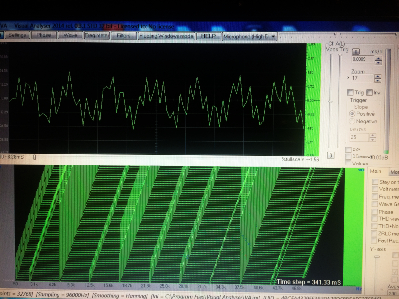

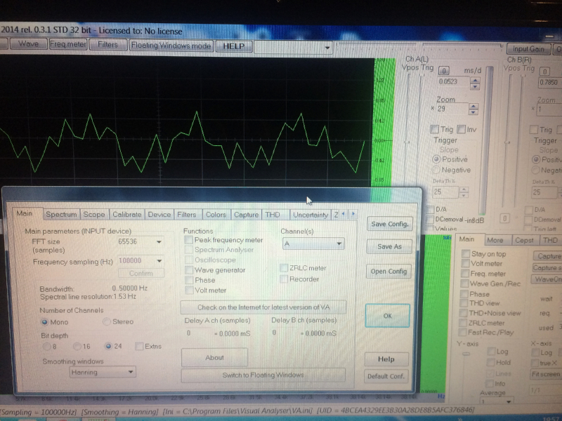

                • #98
                  Thanks Ivconic....Virtual Analizer - I think it's a very good pogram, the microphone input-as a probe-to scan the coil detector I used the headphones ..and it's pretty good it works ... it works well on both oscilloscope and frequency analyzers .. You can adjust them to on the notebook sound card a microphone recorder for the 24 bit-96khz range, and amplify the signal appropriately. You will also have to set the settings in the Visual Analyzer - set-fft -size samples to 500-64000 and frequency sapling to 100000 Hz and Bit depht to 16 or 24 bit. Another setting requires an oscilloscope - Approximately x20 and long sample at 0.3 ms and less, and also in the X-axis and Y axis Main Settings and the On-Of- and Average setings..1-200..

                    Setings ... Click image for larger version
Name:	Januar 1 iphone 5S 2019 087_DxO.jpg

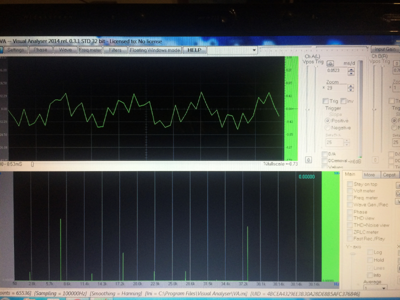

                    • TX Signal program Park 2 Click image for larger version
Name:	Januar 1 iphone 5S 2019 083_DxO.jpg

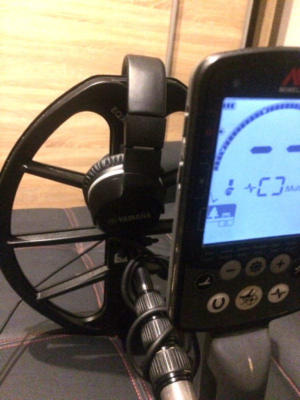

                      • Receiving probe-headphones .. Click image for larger version
Name:	januar 2 iphone5S 2019 004_DxO.jpg
                        • Originally posted by EL NINO View Post
                          TX Signal program Park 2 [ATTACH]44914[/ATTACH]
                          Looks good. Can you put cursor on the FFT peaks and measure the exact frequencies?

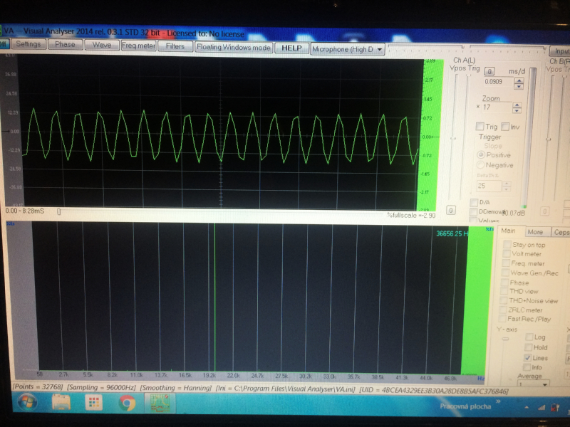

                            • Waltr....Yes, it is good to measure ... some frequencies vary in different programs .. On the osciloscope you can compare the shape of the wavelength of the TX wave amplitude in the programs, for the interest I will state that the amplitude of the program beach1a beach2 is smaller and the overloade is reduced to 1/3 of its initial value. I have also measure each individual frequency 5,10,15,20,40Khz in programs-one about the modified sinusoid ..Nice to dig it up and the top of the sinusoid..
