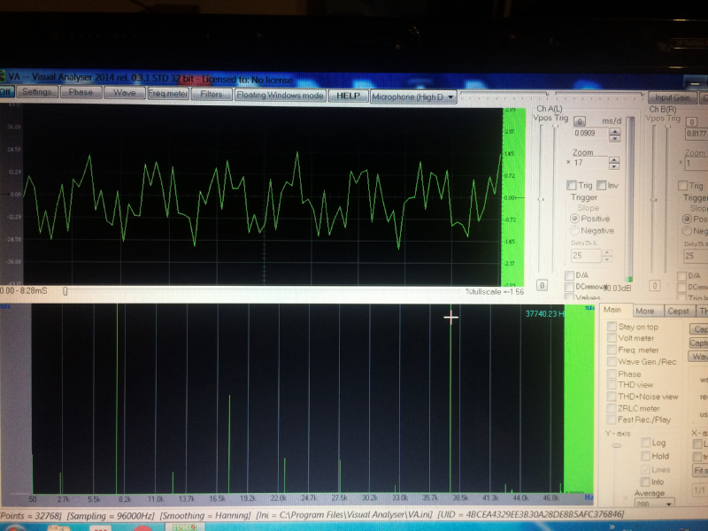

    Looks good. Can you put cursor on the FFT peaks and measure the exact frequencies?
    Yes.. foto Park 2 - whit cursor .... Click image for larger version

    • Now we see how VA is seeing the signal through the headphones used as probe.
      Question is now; what would be the differences if the original RX coil is used as probe instead?

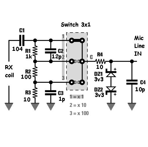

      • We don't want any unpleasant surprises, therefore is better to add this circuit too:

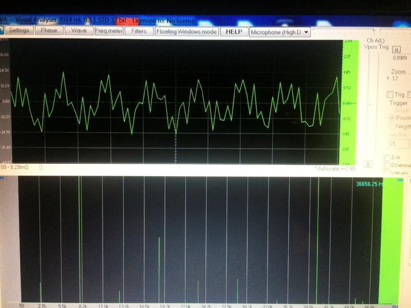

        • El Nino: can you tell us which version firmware you have in your machine?
          Your "gold mode" output is different to what people have seen for Version 1.5 firmware.

            I measured it on firmware 1.7.5, a photo from a gold program working on 1f-20khz, the photo gold program- multi mode frequency should be here: Click image for larger version

              37740Hz is highest freq. What about the exact freq. of the other two?
              Guessing 18870Hz & 6290Hz.
