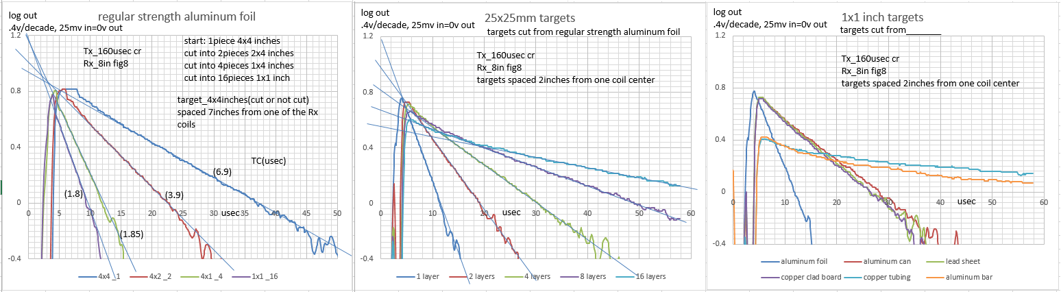

                  An innovative approach would be high speed variable pulse width tx with synchronized electronic damping and comparative sampling. Then one could create a profile of conductive target which would be unique to specific metals or even alloyed metals regardless of its mass. the data can then be extracted and form the basis of target ID.
                  I don't see how but maybe I'm missing something. The 1inch square of aluminum can, copper clad board and lead sheet chart almost the same decay.
                  • #54
                    Is the linear relationship among these three metals constant regardless of tx freq and pulse width. Even small variance in conductivity over a wider range of exposure should produce significantly different decay curves, when combined in totality should create a unique signature for that specific metal, at least with enough variance for DSP to observe.
                    • #55
                      Now we enter into the realm of multi freq. PI
                      • #56
