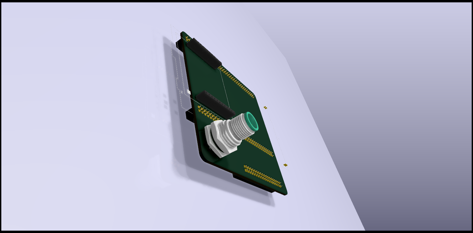

      I was thinking that but if I do something like this..
      100mm x 100mm board.
      I want to enable more people to build it so I have to compromise somewhere.
      it should be portable with nylon bolts holding the sandwich together.
      The reason I wanted an LCD is because I wanted all variables changeable in the field but did not want any wires or pots.
      Using the internal LCD interface on the stm would mean only buying a $10 display.
      And yes I would love to have a look at your code..
      • #63
        Oled screens are pretty good and cheap nowdays ... search for SSD1306 in aliexpress.. 2.42" go for ~30$
        Pretty low power consumption and wide viewing angles.
        • #64
          I dare to disagree with this They eat 50-60mA when they show 1 line and 3 bigger digits. Depend also on contrast, which you need to set up to max in strong daylight. With all pixels on it sucks 200mA !!! Which can not be considered as low...
          • #65
            Yup 50-60mA is just exactly what numbers I had in mind and I call these low... anyways I see the display as a drawback. No useful information will come up on it at all.
            For better consumption - E-Ink: https://www.embeddedartists.com/prod..._27_epaper.php
            • #66
              I could... Display to a android phone it's my go-to move when settings or information is only needed every so often and it's cheap
              I am thinking of just having the LCD sleep untill you tap the screen
              • #67
                I do have an esp32 here maybe paired with the external adc idea one could have a low power MCU pi with Bluetooth and wifi. Dam it why did I not think of that
                • #68
                  There you go, some time & cash saved and it's good UI.
                  • #69
