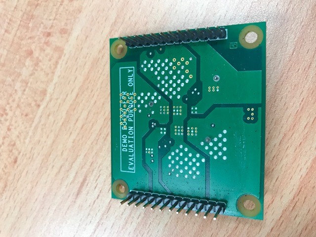

        • #79
          Hi gtdavid,
          Received PWD13F60 evaluation board this morning, looks Ok, bit expensive at $57 delivered but chips themselves are around $7 so not too bad.
          I'll try set up some tests when I get some time and post when done.

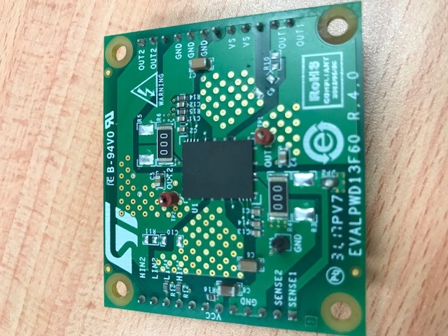

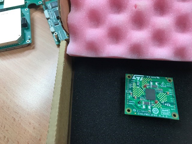

          • #80
            here are some better closeup photos
ID:	351386 Click image for larger version
            .1" headers will make connecting easy.
            cheers
            Mdtoday
            • #81
              That is a bit "OK" isn't it, expect at least a clean board from ST.
              • #82
                Yes, pins were soldered in at odd heights too but hopefully it will work as expected.
                If it does, I would be inclined to make a smaller version of the board but have to check out heat dissipation of this board in actual operation with a coil.
