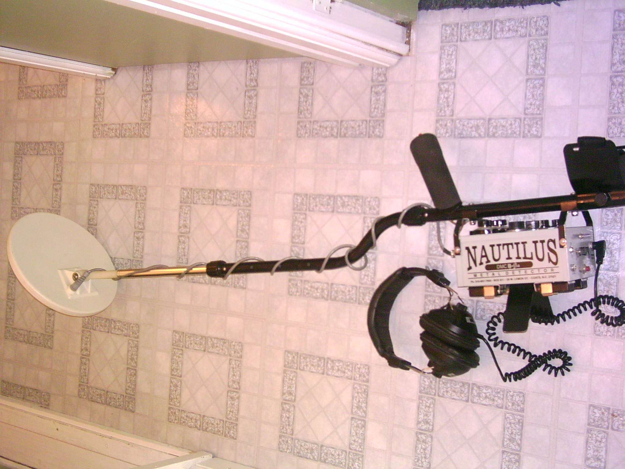

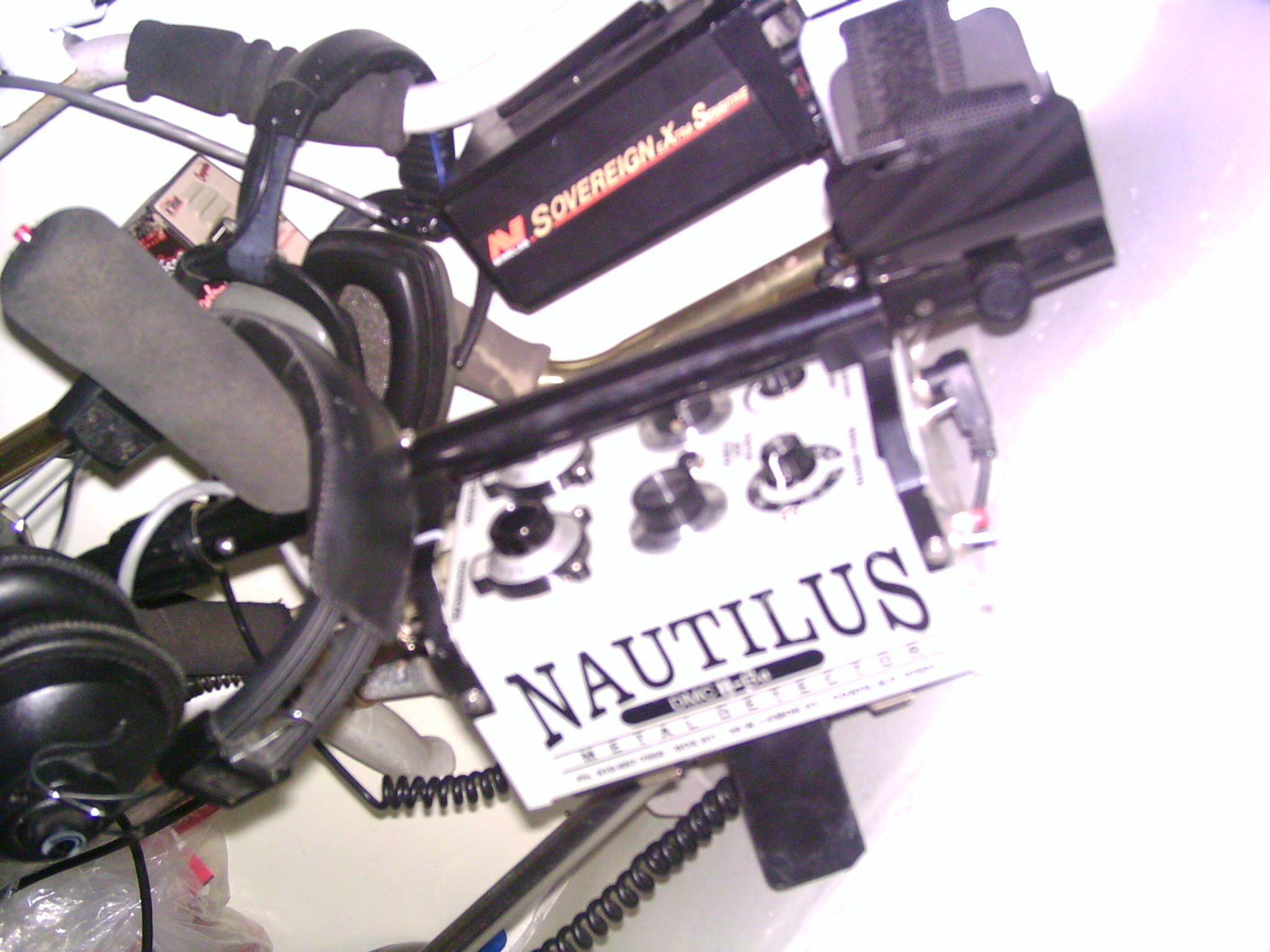

    More pics of the Nautilus 2b

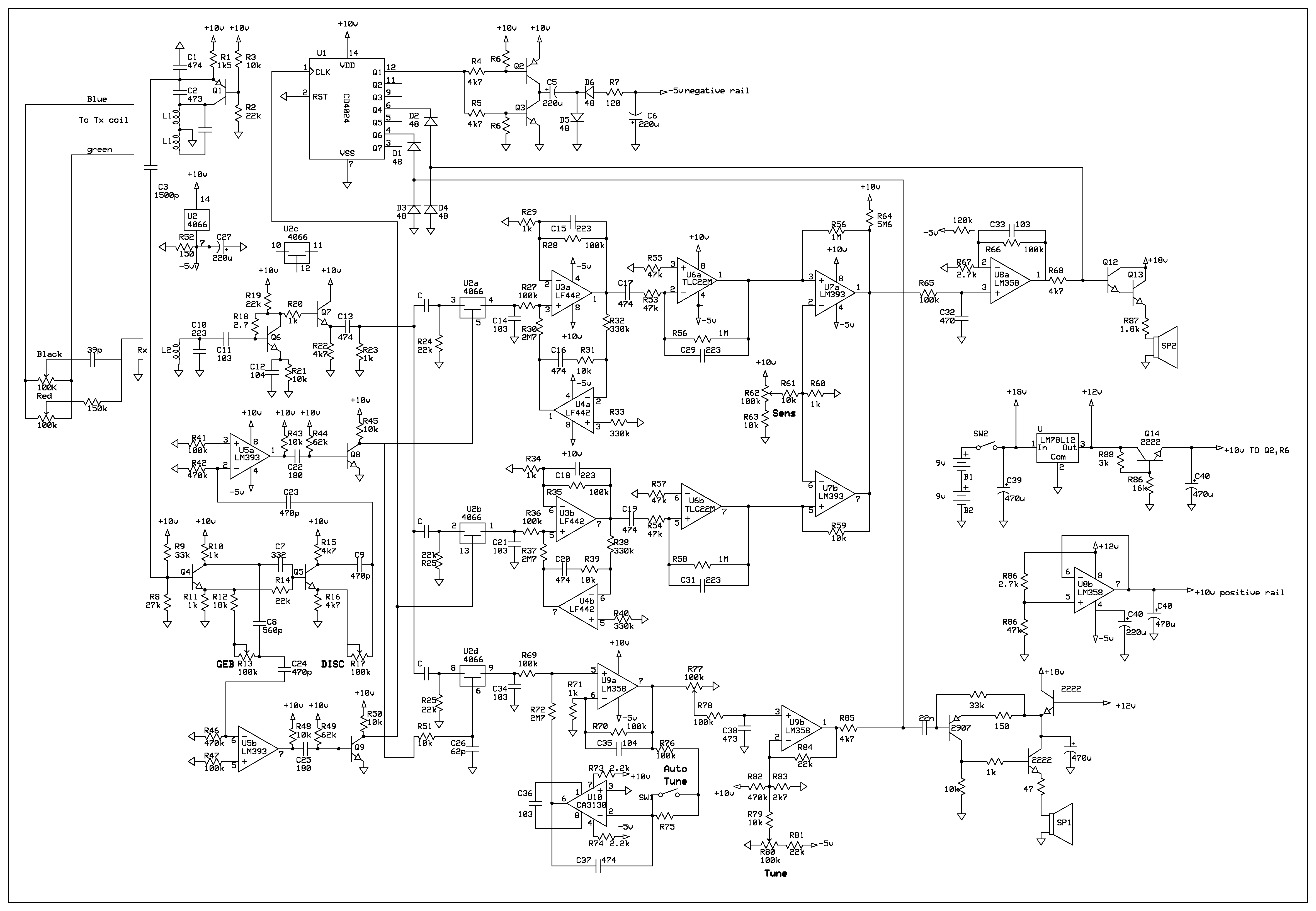

                    Guys, I have completed redraw of schematic of the 2b. Now some expert can do some analysis and give opinion.
                    Will be posting in couple of hours as soon as I finish some house cleaning and reboot the laptop.:dance
                    • #55
                      Schematic DMC-2b. The differences are:
                      The 4024 clock pin 1 connected to different part of circuit.
                      The audio driver circuit for SP1 is different.
                      Coupling caps added to inputs of 4066 switches, 22k resistors connected to ground.
                      TlC22m and 442 replaces 2 LM358 chips.
                      Few component values are different, still need to change them to new values.
                      The nulling circuit.

                        There appears to be two seperate +10V rails, it would be sensible to name the differently, it's not obvious which is which.
                        It's not the most energy efficient design, is it? 18 Volts, linearly regulated down to 10 Volts. [ it's similar to the Fisher F2 / F4, actually ]
                        Do you think the purpose of R52 is to load the -5V rail, to make it closer to -5 Volts, as without it, it would be nearer to -8 Volts ( 10 volts less two diode drops, roughly)

                          TX coil in this connection give encrease of amplitude. it is sure like in Aquasound and maybe reaches same 52V. sorry i do not know a term in english to say how recall this method.

                            Actually, the positive rail is 11 volts on this setup simulation in LTspice.
                            Also the speaker 1 circuit shows pulses with low duty cycle no doubt to save on battery drain. This is the channel that is low continuous hum threshold, so that makes sense to me.
                            I still need to do some work on schema to correct some component labels etc, but the essence is clear for all to see. No big surprise here.
                              Yes, the negative rail would be closer to - 8volts. But
                              that's how the actual circuit is copied from pcb, so maybe it's correct. I just assumed that it was negative 5 volts because the dmc2 schematic was this voltage.
                              I wasn't really paying attention to this.
                              Also, there is no 150R resistor(R52), this is leftover from dmc2 schematic. Pin 7 of 4066 connected to ground on the 2b.
                              Will have to update the schematic.

                                I have not seen a full schematic of the 2b. The DMC2 had a unique two tone audio. In one ear you would hear the disc channel and in the other the all metal channel. The tones came from the 4024 divider.
                                you see just two tone. i see advantages: 1/ first try of use preamp in coil. whites, garrett, tesoro, first texas-fisher still do not want use this trick. but only minelab does. i well know this tipo of transistor preamp, plus the emitter follower. thats really superior was for that time 2/ 52V p-p on TX.
                                in general it is tesoro schematic but with some three 'mods'. want to say every guy with TGSL may moded the schematic to Nautilus but TGSL does not have all-metal part )))
