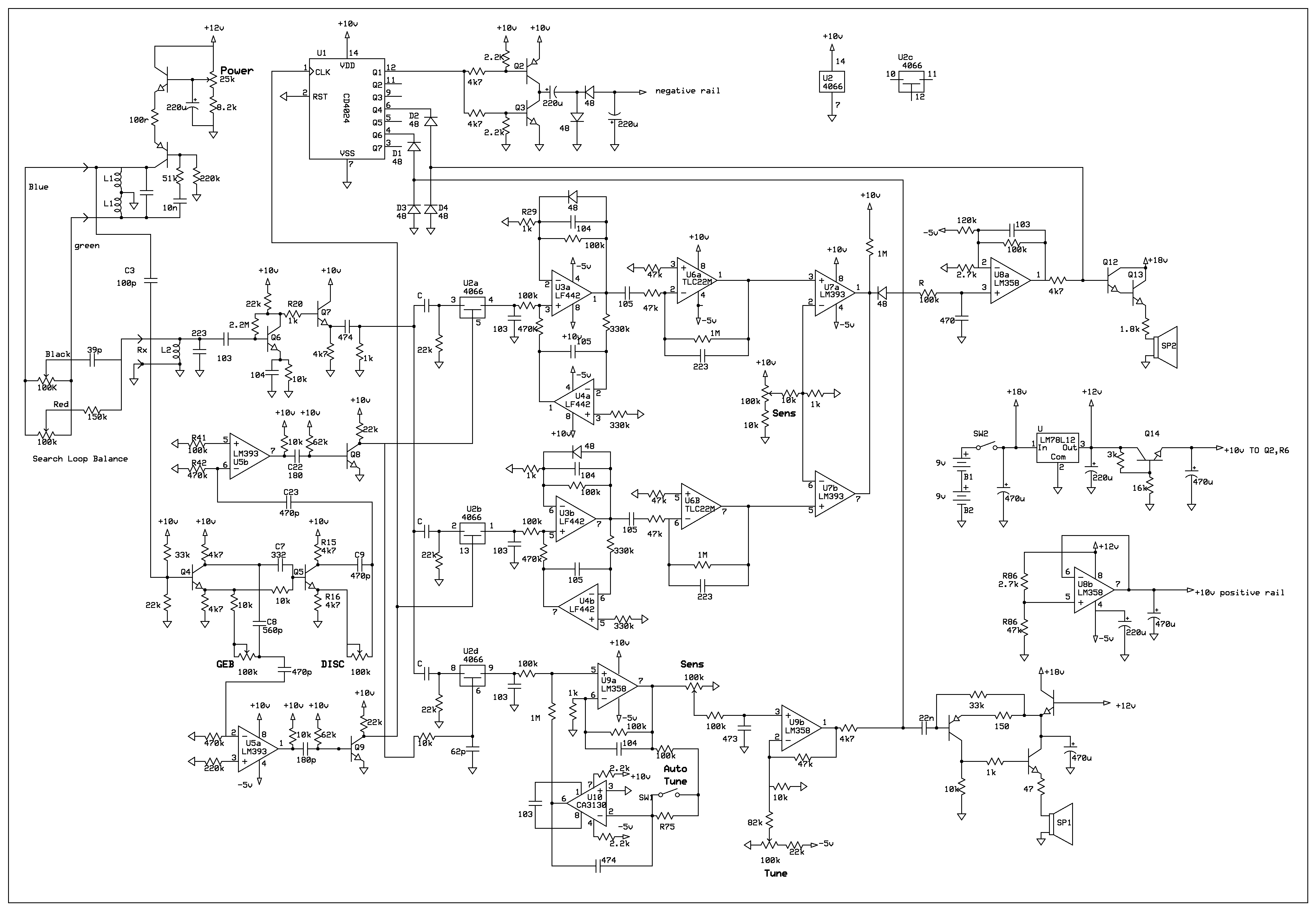

      Aquasound and nautilus 2b share exactly the same oscillator circuit.
      Here is final version of 2b schematic, have a look at TX oscillator.
      All components have now been properly labeled with correct values for 2b.

          A few comments on that circuit:
          You have a cap, C with no value on both the 4066 synch detector inputs.
          U10 opamp has capacitor 103 for stability...is that correct? The usual value is more like 33pF - 100pF
          The output of U9a has a pot of 100K. Is that a preset, and does it have a name, like 'sensitivity' etc?
          Q6 has a feedback resistor of 2K7, I assume?
          The oscillator has a cap across the TX coil with no value shown.
          U8a has a 120K resistor near it, not connected.
          • #65
            Skippy, thanks for putting your eyes on schematic. Mine are a bit weary at the moment.
            Dont know values of caps to input gates of 4066. Could you suggest a value?
            U10 cap shown as .01 on DMC2 schematic, so I used this value.
            Pot at output of U9 is the second Sensitivity control. This device has two as you pointed out.
            Q6 feedback resistor is 2.2M.
            Tx oscillator cap is 15nF(14KHZ, 8.4mH coil) but I leave this blank for now.
            Also there are no feedback resistors on U7.
            I made the corrections.

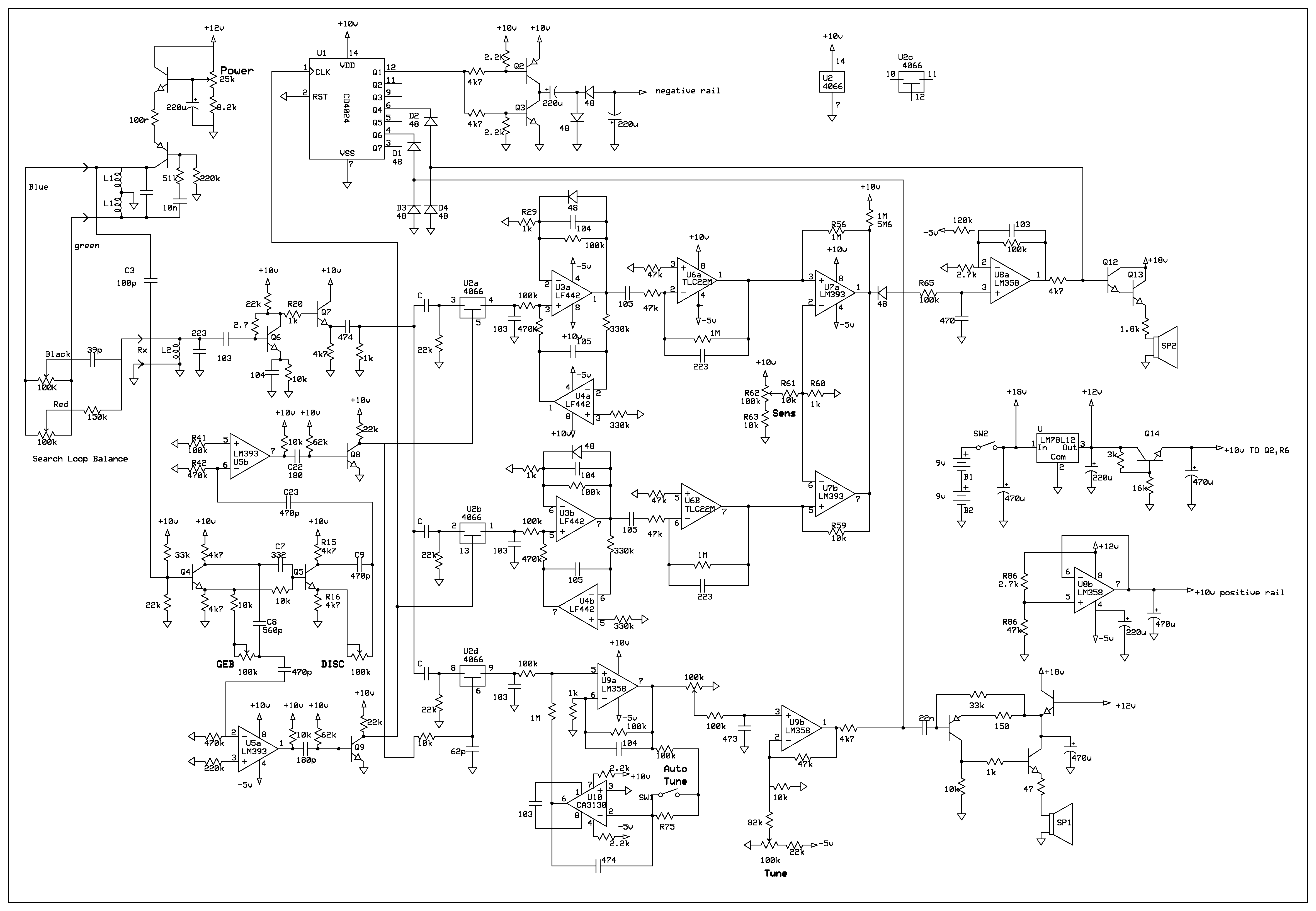

            • #66
              Here is the updated pcb trace.

                  The Autotune switch has a resistor near it, with no value.
                  Is U8 still the LM358 part? You said you changed some of them. Gotta say I don't like the idea of a crappy low-power opamp as the main +10V regulator.
                  You still have the confusion of the two different +10V supplies. Could the one that powers the -ve voltage generator switches be renamed " +10V_AUX " or something, you choose.
                  Unused analogue switch U2c should have all 3 pins grounded, I think. The control pin MUST be grounded, I can't see why not all 3 connections.
                  The TX oscillator has a '100r' resistor, presumably it's 100R ?
                  I don't know about the synch detector 'C' caps - someone with more TGSL etc experience woild have a better idea.

                      The schematic reflects EXACTLY what is on PCB. All opamps are correct and are exactly what is on PCB.
                      100r should be 100R(100 ohms), unused analog switch pins are left floating on actual pcb, but should be grounded I think.
                      I will re- label the +V supply for negative voltage generator.
                      The auto tune switch works in conjunction with a pushbutton switch, the resistor value cannot be seen from pics I have but the wiring diagrams will show all switches etc.
