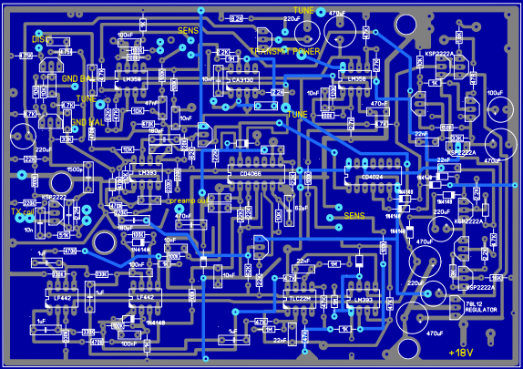

        Here is the layout. I was not bluffing. Took many hours.Summer project?
        a problem you (and of another guys too) give only .lay6 file but use .jpg pic of board like a layer. a lay6 file does not keep layer file
        inside as format. right way is to give lay6 + the jpg in one ZIP. then people will be able to check the layout.
        • #79
          Ok, will do.

            can anybody send me expresspcb on email? i do not want to register email address on their site.

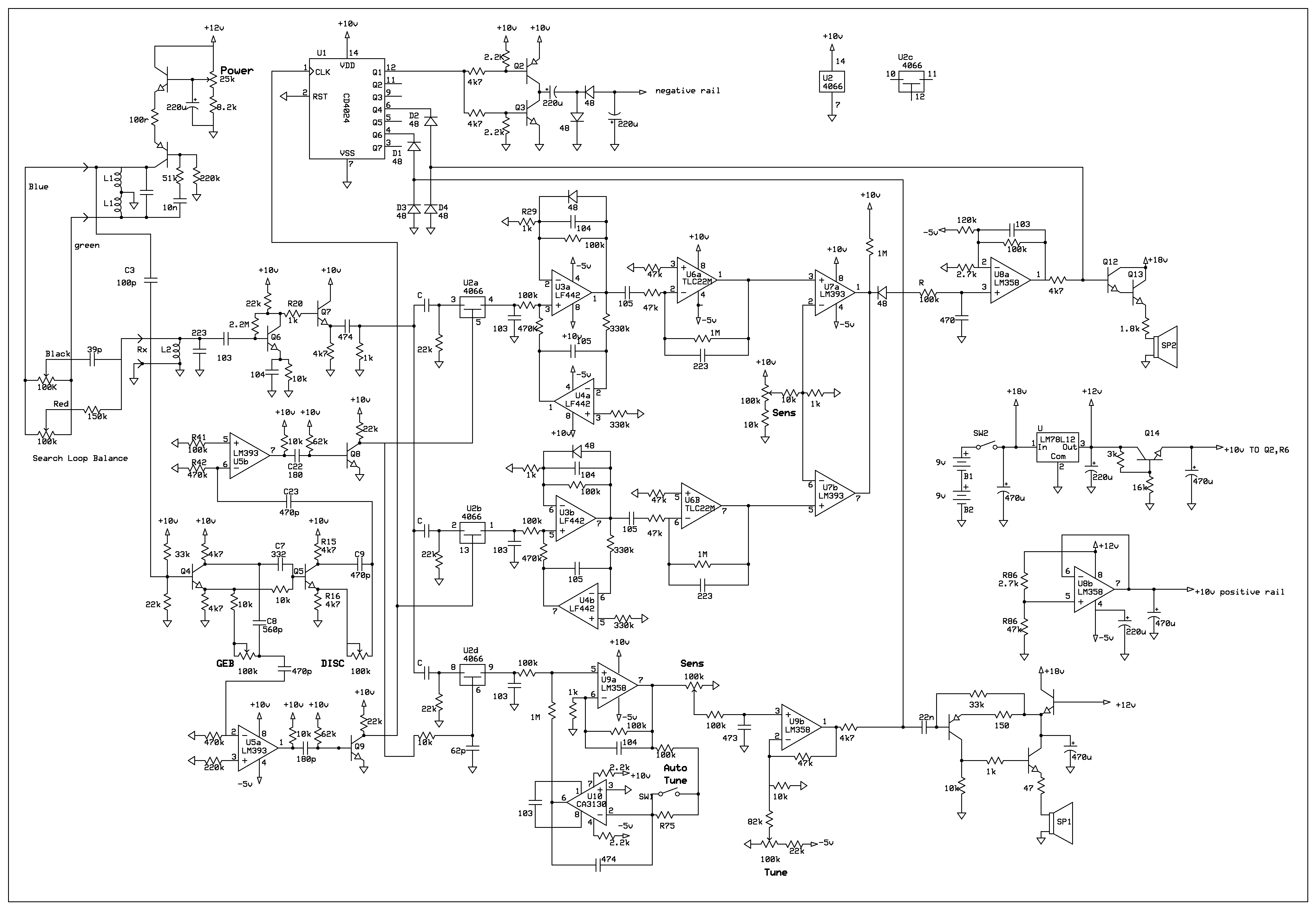

              When guys die, things change, and material disappears from the internet. According to photos of the inside of the coils Nautilus used two wires to move around to get the null of the coil. They wrote messages inside the coil case to let the future person who had to fix an incoming defective coil again what had been done to it to get the coil to null. And the coils insides are fairly "light weight made". I was saying that in a kind way to the memory of Nautilus. Not made very strongly. So out in the field they got bumped and back them came in around 2 or 3 years for repairs. This was observed by reading Nautilus post after post in the past.
              Yes, that link still exists, and AOL let me go visit it. So I was there as well.
              When one is trying to come up with a schematic by reverse engineering, it is difficult to figure them out and come up with a schematic like the factory schematic. So I thank and commend DBanner for what he has done and what he is still trying to come up with... I appreciate it very much DBanner!
                I assume you want the software so that you can run the .SCH file? I do not use Expresspcb nor have it installed in my computer, but if you email me at Pondco at Aol dot com I might be able to email what you would like to have. When I draw out my own schematics I either draw them by hand or use Orcad which I bought and paid for.

                  There's something strange about coil for the 2b that bothers me. I have learnt that concentric coils have what is referred to as a bucking coil. So now anytime I see a concentric coil setup, I immediately think bucking coil.
                  Yet I cannot see this in pics of 2b coil. What I see are some wires for balancing, but there is only two wires and a center tap coming from tx coil connected to small pcb. The bucking coil is supposed to be part of the tx coil, but I see no other wires connected to tx coil on small pcb.
                  This puzzles me.
                  Yes, I noticed this as well. One can take the photos, have them enlarged and printed out on large sheets of paper, then put them on a light table, and put a new sheet of blank paper on top, and begin tracing lines and after you have done this one can see things in a better light. I have done it myself in the past when reverse engineering a electronic unit. The answer is they moved the coil wires around in position, which is why they wrote on the case what they did. Strange to do it that way, but it is how they did it.

                  • #84
                    Very interesting information there sir. Thanks for posting. Well those fine wires which loop around and are stuck down, are positioned and stuck when coil is being fine balanced. This is part of manufacture process of coil. These wires are part of bucking coil. An extra piece is left swinging before attaching the end to small pcb. Then when final balancing of coil is being done, the little piece of extra wire is moved around until null is achieved. Then it is glued down in that position.
                    This is what I learned from various thread and documents as to construction of concentric coil.
                    So I think that the 2b is normal concentric coil(with bucking coil) and should be relatively easy to reproduce the original coil.

                        The schematic and layout file
                          Look in [email protected]
                          • #88
                            Ok, I will send.
                            • #89
                              I can't upload to you Gmail address, it says "blocked for security reasons"
                              I sent it as a JPEG file so you will have to rename it to .EXE
                              It can't be sent as .exe or .zip for whatever reason.
                              It is free software, so I hope I didn't break any rules.
                              • #90
                                DB
                                got it. thank you. installed.
