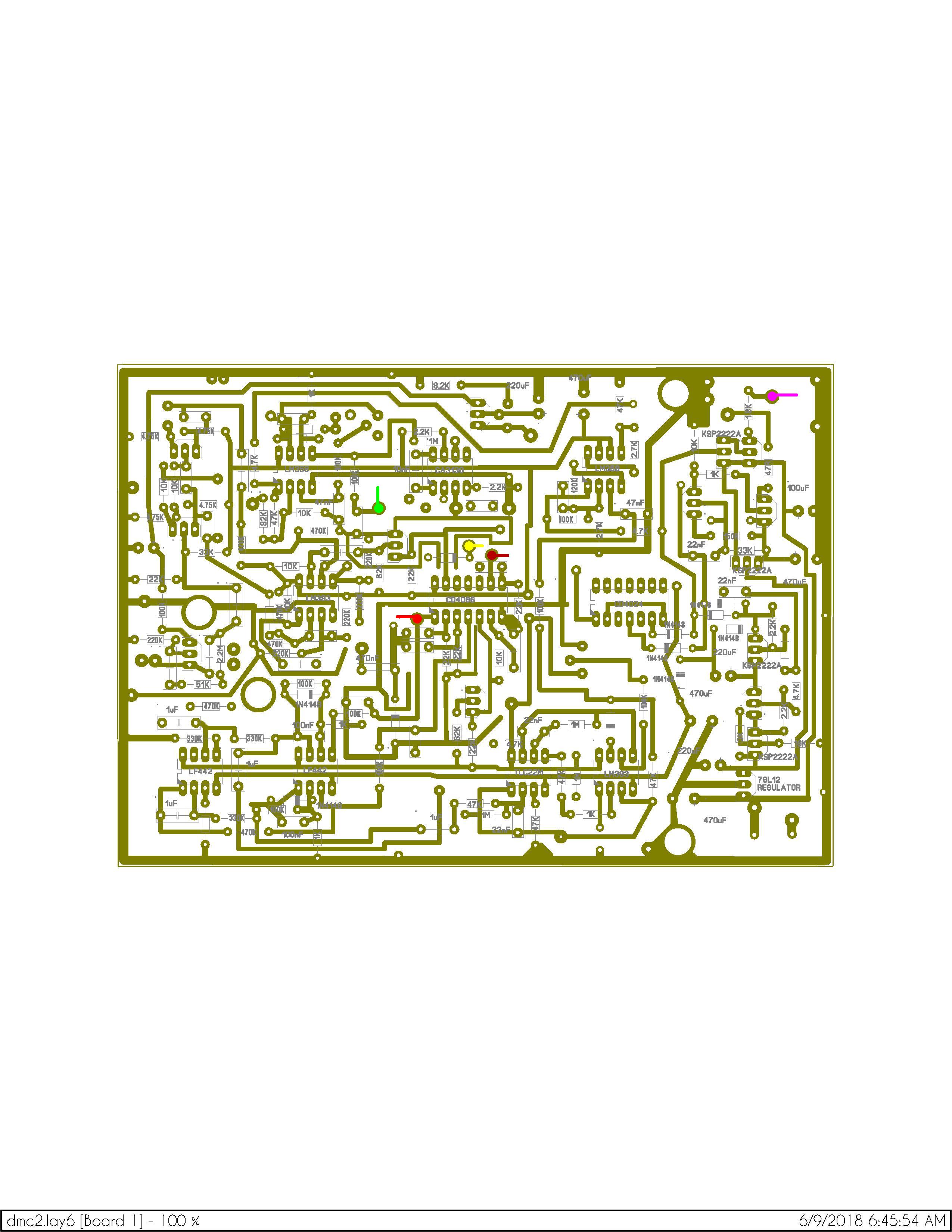

          Coming attractions
          Layout for AT3 beachunter
          Layout for gold bug 1
          Layout for aquasound

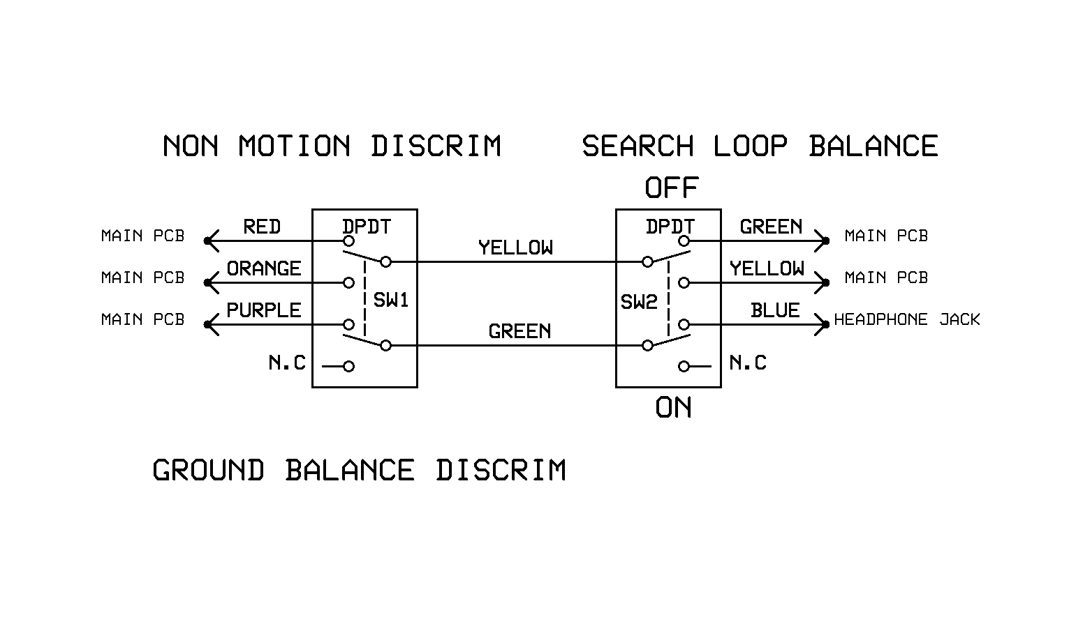

                        I solved last part of puzzle for this device. The wiring of the swiches( Search Loop Balance Switch and Non-motion disc./ ground balance disc.)
                        Later on I will post complete wiring diagram for all switches and pots on a single image. But for now here is the wiring for the switches. The color dots correspond to the wires on switches.
                        you can find the .sch file here also.

                            • KT, I put schematic in .sch for you. check in zip above.
                              • oops. thanks.
                                check schematic for netlist errors gives 'Duplicate use of C'.
