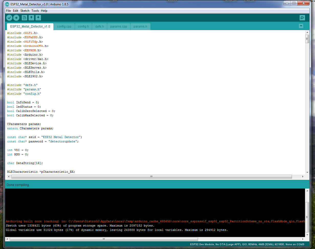

      Ok, i got somewhere... to deep mist.
      Here is the error log:
      Arduino: 1.8.5 (Windows 7), Board: "ESP32 Dev Module, Default, QIO, 80MHz, 4MB (32Mb), 921600, None"
      C:\Users\userIC\Documents\Arduino\libraries\ESP32_ BLE_Arduino\src\BLEClient.cpp: In member function 'bool BLEClient::connect(BLEAddress)':
      C:\Users\userIC\Documents\Arduino\libraries\ESP32_ BLE_Arduino\src\BLEClient.cpp:97:2: error: invalid conversion from 'int' to 'esp_ble_addr_type_t' [-fpermissive]
      C:\Users\userIC\Documents\Arduino\libraries\ESP32_ BLE_Arduino\src\BLEClient.cpp:97:2: error: too few arguments to function 'esp_err_t esp_ble_gattc_open(esp_gatt_if_t, uint8_t*, esp_ble_addr_type_t, bool)'
      In file included from C:\Users\userIC\Documents\Arduino\libraries\ESP32_ BLE_Arduino\src\BLEClient.cpp:13:0:
      C:\Users\userIC\Documents\Arduino\hardware\espress if\esp32/tools/sdk/include/bluedroid/esp_gattc_api.h:294:11: note: declared here
      esp_err_t esp_ble_gattc_open(esp_gatt_if_t gattc_if, esp_bd_addr_t remote_bda, esp_ble_addr_type_t remote_addr_type, bool is_direct);
      Multiple libraries were found for "BLEDevice.h"
      Used: C:\Users\userIC\Documents\Arduino\libraries\ESP32_ BLE_Arduino
      Not used: C:\Users\userIC\Documents\Arduino\hardware\espress if\esp32\libraries\BLE
      Multiple libraries were found for "WiFi.h"
      Used: C:\Users\userIC\Documents\Arduino\hardware\espress if\esp32\libraries\WiFi
      Not used: C:\Program Files (x86)\Arduino\libraries\WiFi
      exit status 1
      Error compiling for board ESP32 Dev Module.
      This report would have more information with
      "Show verbose output during compilation"
      option enabled in File -> Preferences.
        Ok, i finally give up.
        I have other important things to do.
        Thanks anyway.
        Cheers!
          Delete C:\Users\userIC\Documents\Arduino\libraries\ESP32_ BLE_Arduino directory and coppy https://github.com/nkolban/ESP32_BLE...ive/master.zip to C:\Users\userIC\Documents\Arduino\hardware\espress if\esp32\libraries\
            Yes those are leftovers from yesterday attempts. I completely disregarded that!
            On second look at log file (after i posted that i give up); i realized what was the problem!
            Thank You very much for your patience with me! How can i not respect that!
            This time it is compiling with no problems.
            This small torture will be very beneficial for other members too, hopefully.
            It is actually very easy and straightforward when someone is willing to explain and help.
            Thanks again!

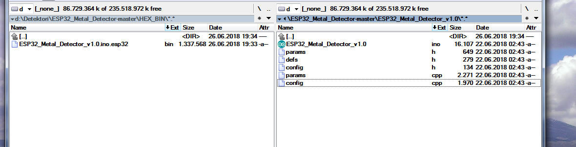

            Screenshots:
