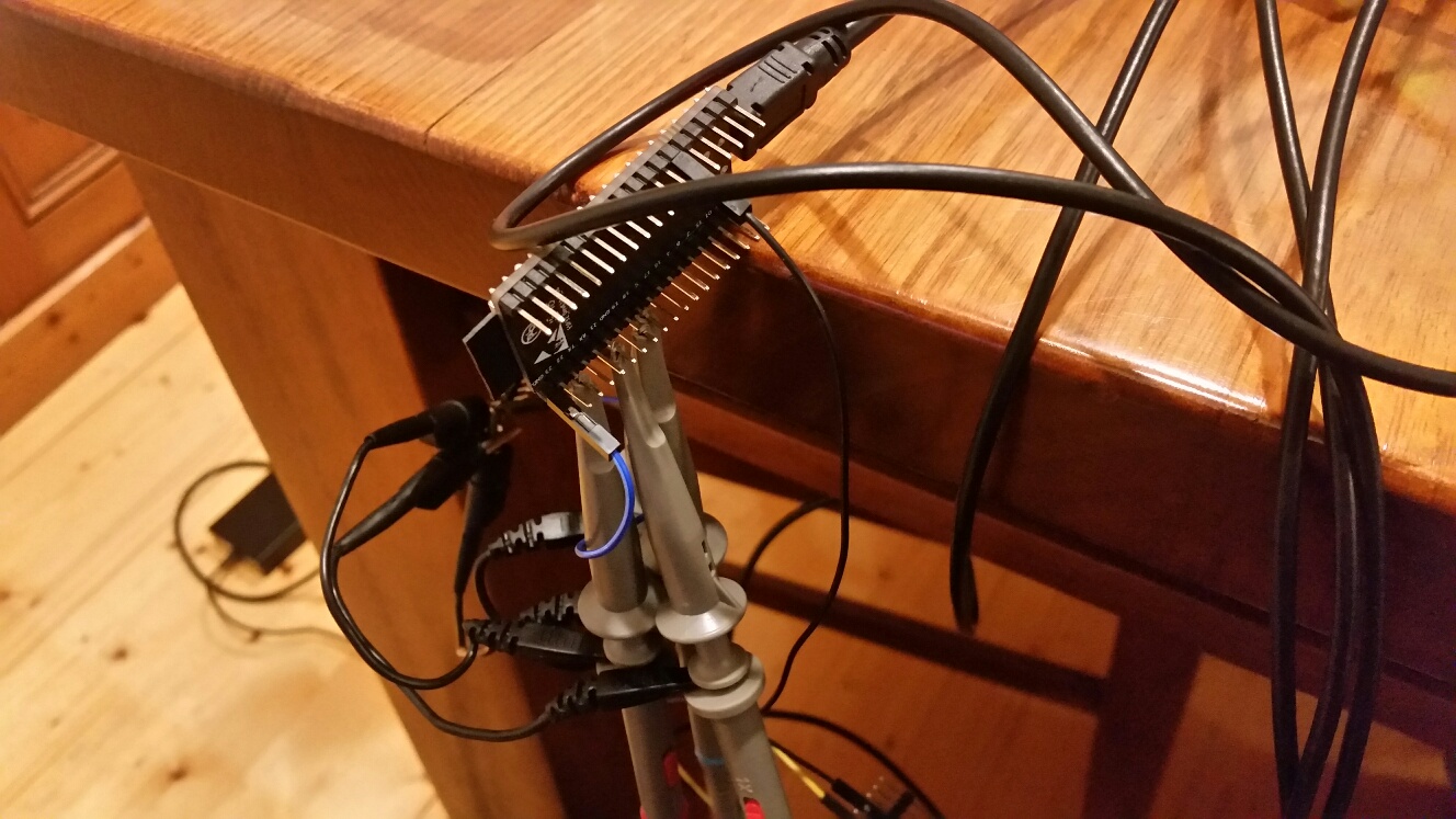

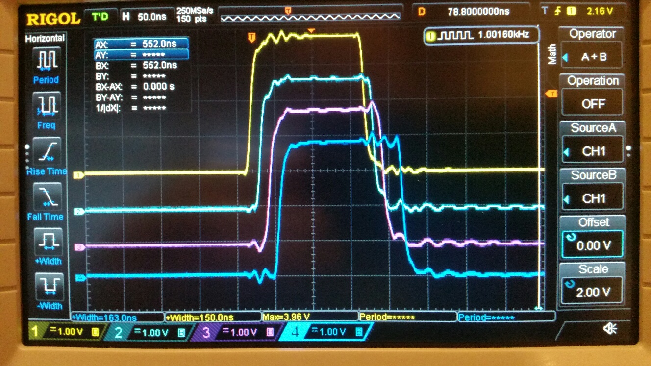

                                Phased pulses on ESP32
                                ... hmmm I was told by an 'expert' that we could not phase the pulses on the LED PWM controllers .... NOT TRUE.
                                bit of TLC and RTFM reveals we can generated pulses with no CPU overheads on upto 16 outputs with upto 4 clock references and 15 nanosecond resolution for Phase and Duty cycle.
                                Pix shows the result of Duty cycle = 10 clock periods, Phase offset by 1 count for 4 outputs on the "testbed" LOL
                                ESP32 PI controller lives
