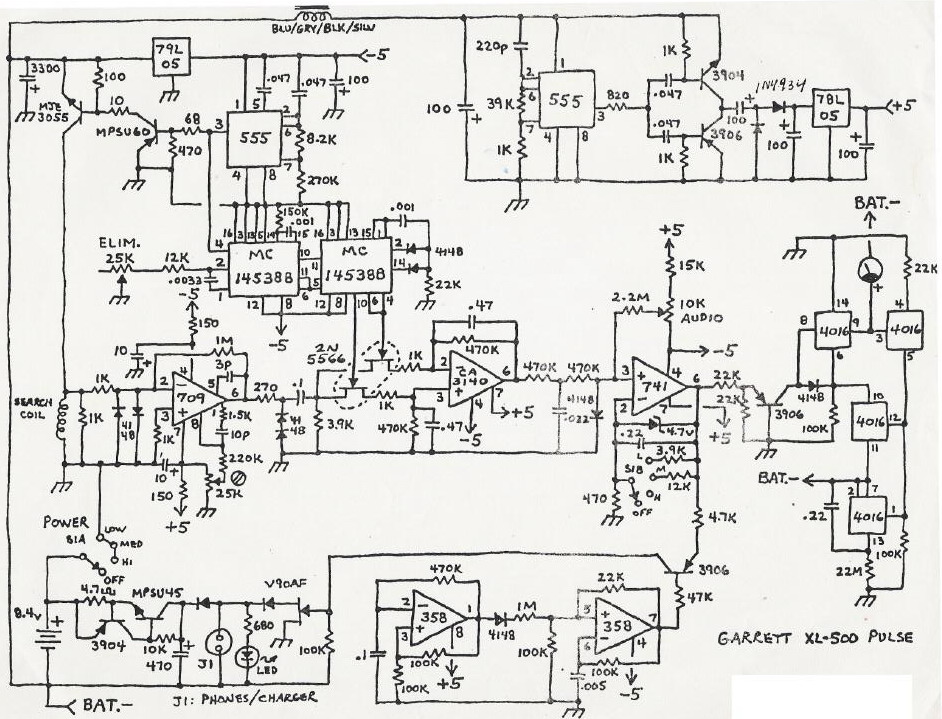

                  I see here also on Garrett pulse machine
                    Yes, those JFETs driven from the mc145388 to +5V or -5V.
                      They get an Signal from the mc, they need no gate Driver.

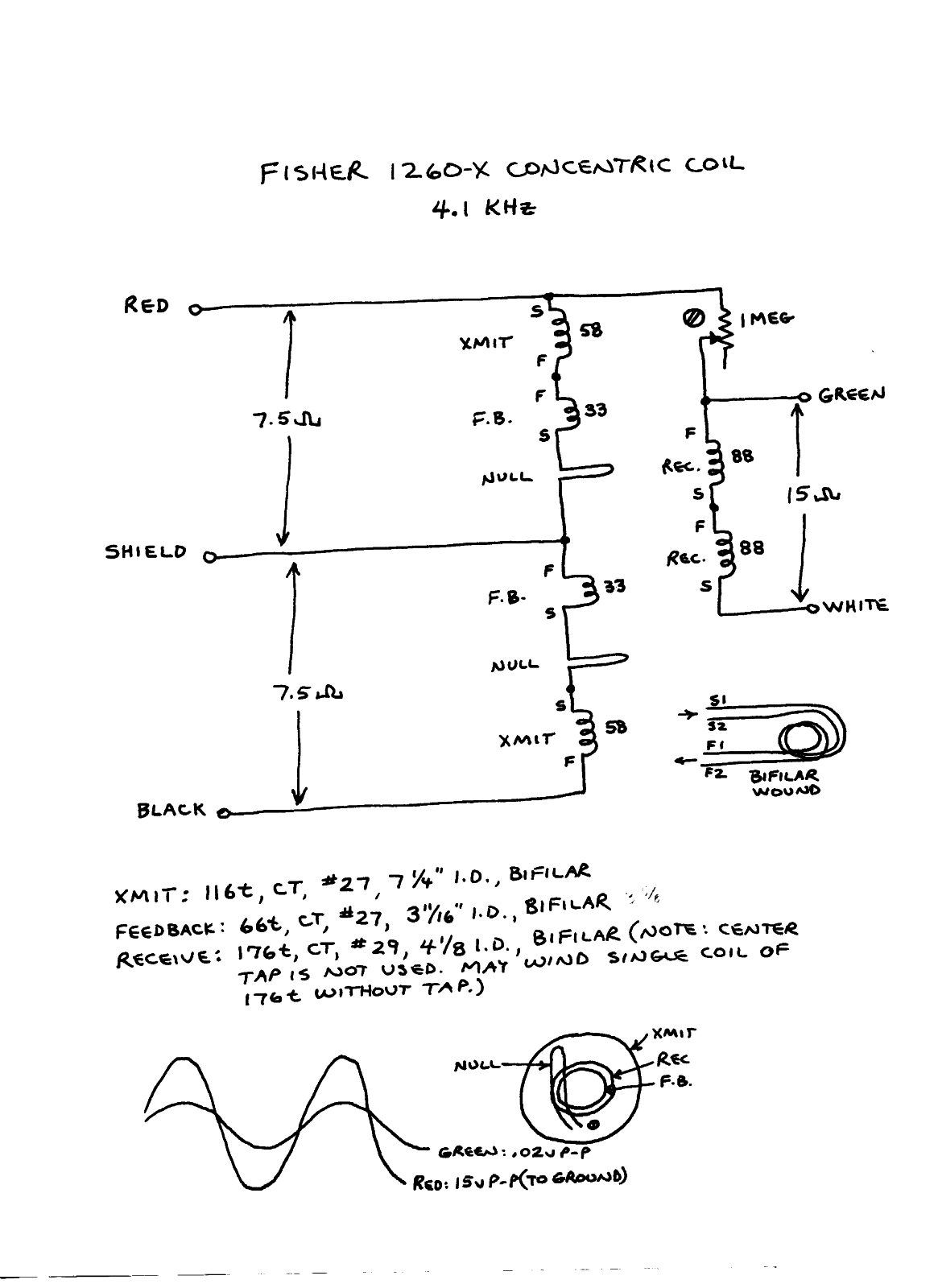

                            I figured out how dmc2b coil is made. It is bifilar coil same as 1260x design. Ha ha! Easy peasy. Clue was the two fine balance loops on the 2b coil photos. The center tapped TX coil needs a feedback coil for each half plus the little extra loop for final balance. Just like the 1260x coil
