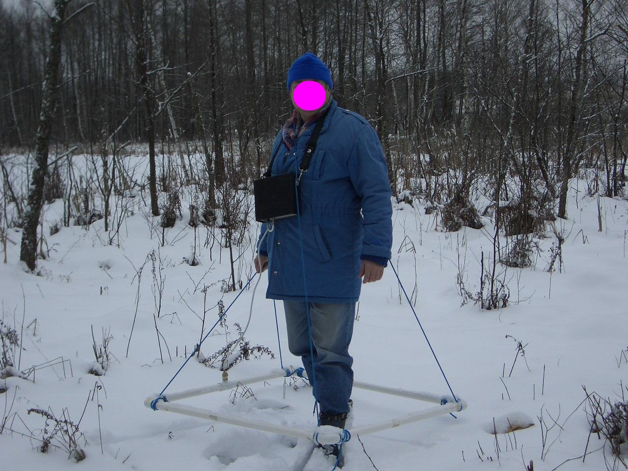

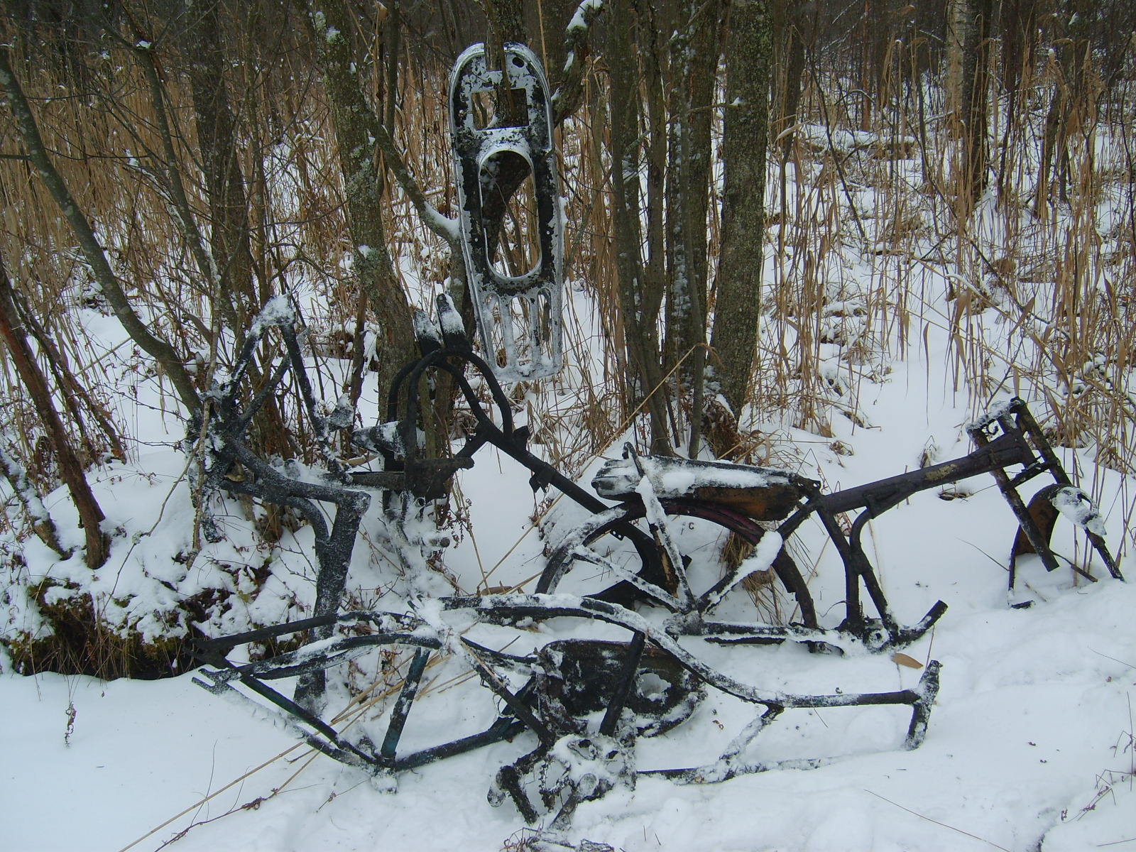

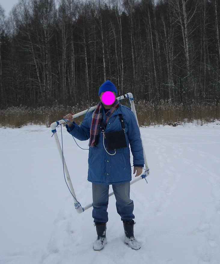

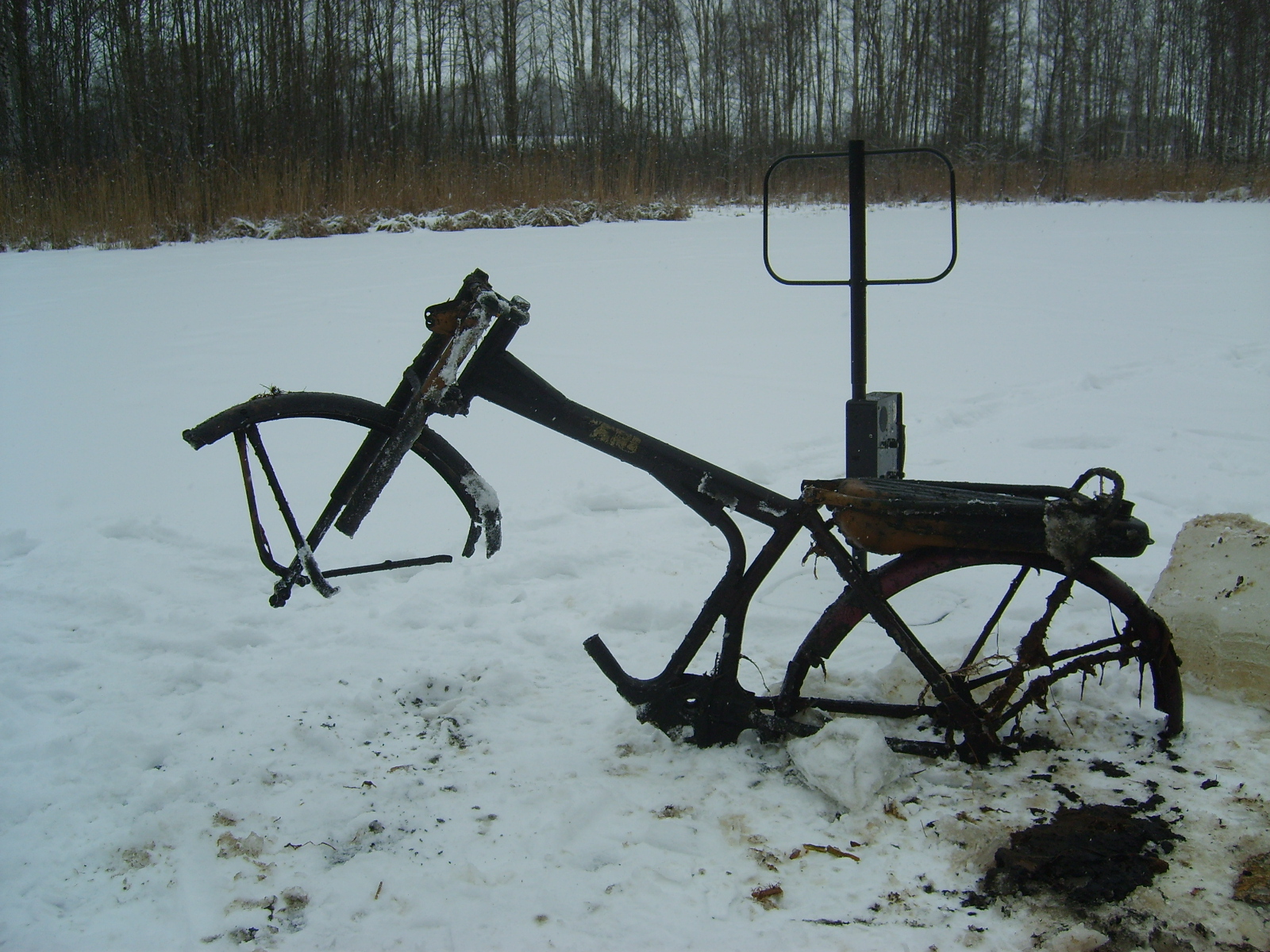

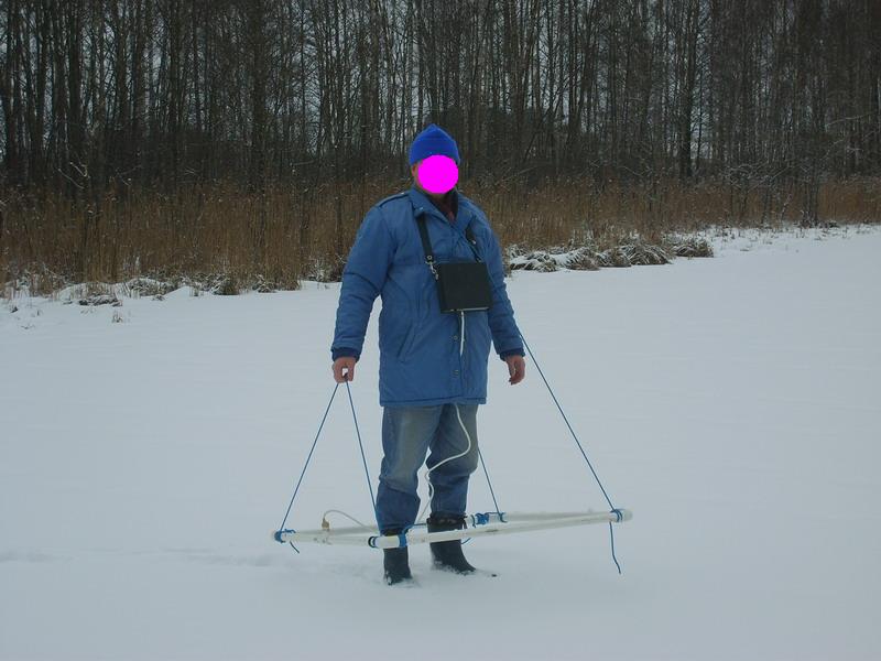

Kt315Originally posted by kt315 View Postmine coil 1mx1m was esp-ly projected for seach in winter time and in summer time on boat drilling (you know this small resine fishers pumping boats).
write if you need more winter pics.

Aha, was you walking on ice and searching on the bottom?
If so, what was the maximal depth of water that you were able to get signals?
I live in the northern part of Sweden and we have frozen lakes and rivers at winter.
So it would be a good option on searching at bottoms. Interesting certainly. If my assumptions are right there is.

Another question that rises: Is it possible to do searches at the bottom of lakes in the winter, and do so by walking on the ice. With let us say a deep seeking PI. Or would it just penetrate the ice and one or two meters more (depending on how good your detector is). I.E how would it function with a deep seeker on a frozen lake? What depth could one expect to reach?
