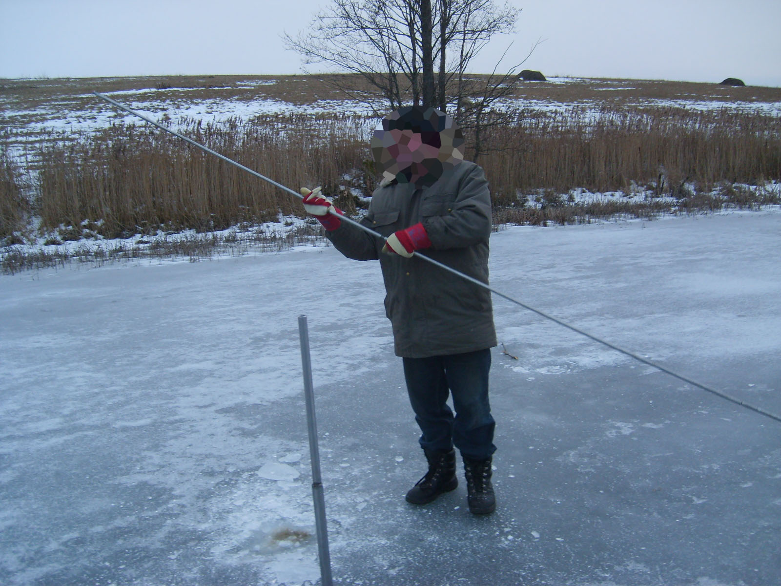

How to improve my Surf PI 1.2 for a mission like this: Underwater search for iron/steel solely
    seen this pic you may present the depth. this probe is main instrument for lift up. it can be with hook and pin on its end changing.
      It's a fake.
      Just one of KT315's little jokes.
