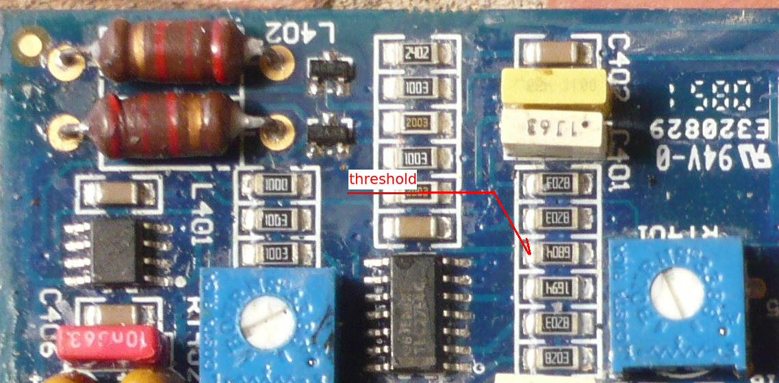

                  Here's a picture of the spot where we can measure the output voltage of the threshold pot
