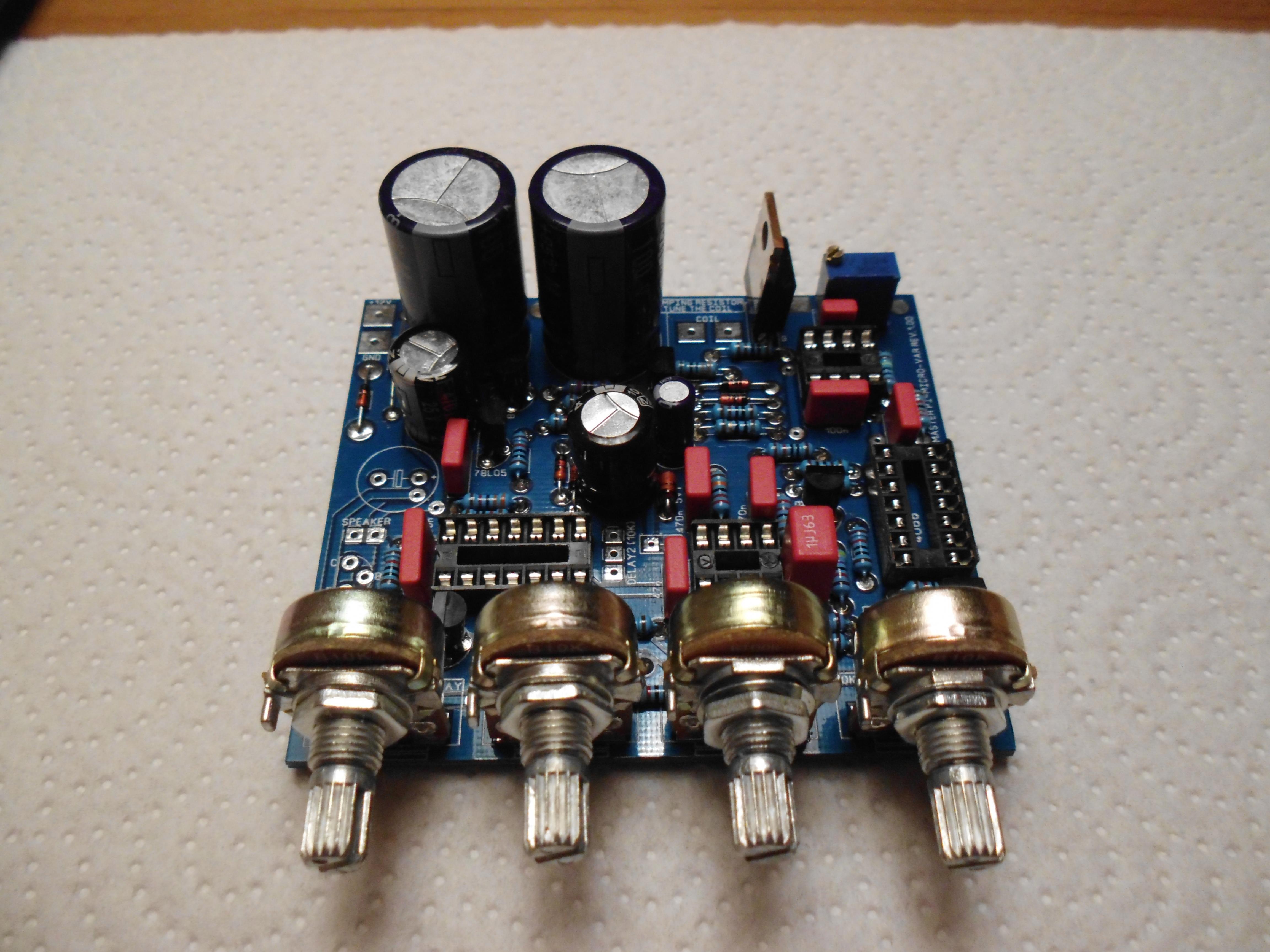

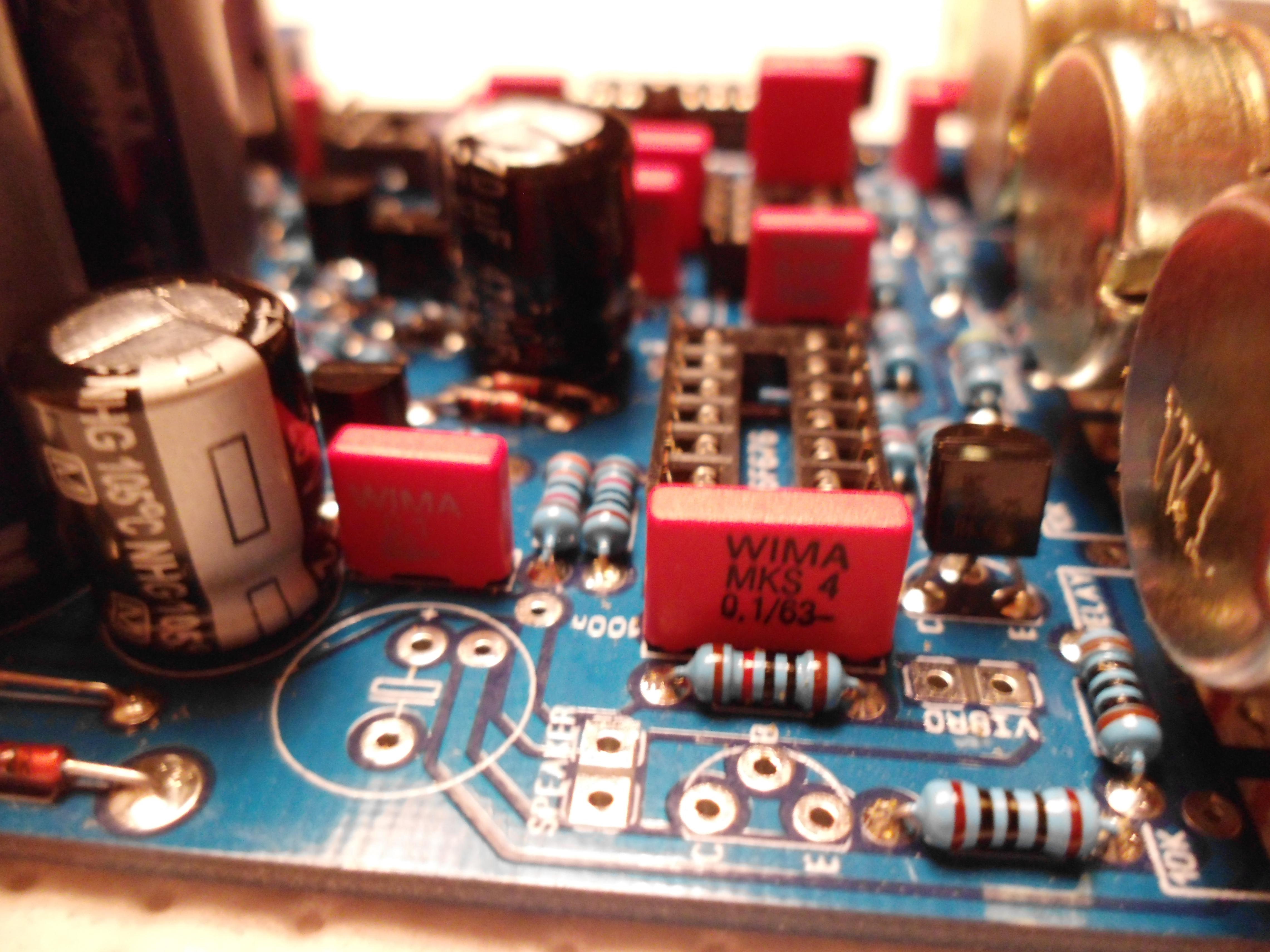

          I finished my board and tried it with the 676.hex file.
          I can hear an error sound when i connect power. I have no clue how i could tune the board.
          Maybe my power source is faulty because the voltage drops to 5 V when i connect the board.
          I have adjusted maximum current to 0,1A and voltage is at 12 Volts.
          • #50
            I tried the other hex file and i got a steady sound with it.
            One problem was my power source. It drops to 3-5 Volts when i connect something.
            I decided to use a 12 Battery and i got the same sound when i disconnected the battery. I think it is the low battery sound.
            +5 Testpoint is 5,9V
            -5 Testpoint is 1,6V
            I used my Baracuda coil (330uH).
            After a few tries the steady sound disappeared.
            • #51

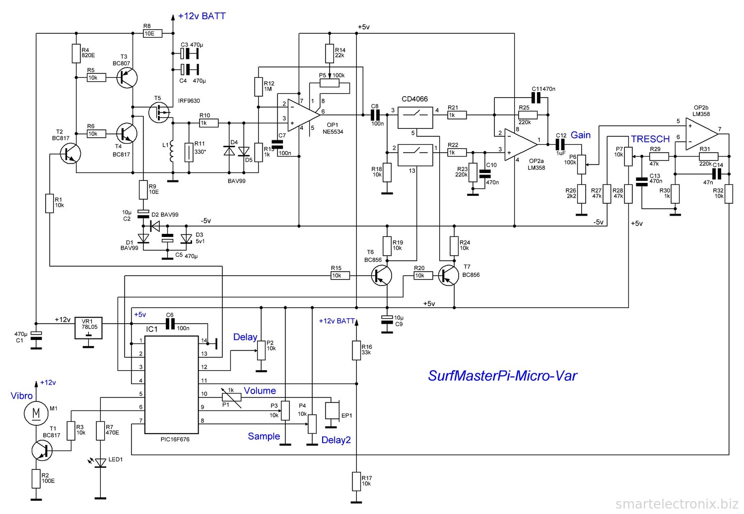

                  Schematic is here: Click image for larger version
                  I dont have a led at the board and no vibro motor.
                  I think i also need to adjust the trimmer but i dont know which pin and which voltage.
                  Was it PIN6 ?
                  I dont want to remove something now because i damaged my baracuda when i desolderd the mosfet.
                  I think the main problem is the negative voltage. Can you tell me where it is generated?
                  I can hear the clear sound of the microcontroller when i connect the battery and when i disconnect it.
                  I maybe accidently connected plus and minus (battery connector) at the board when i tried to measure minus voltage.
                  The steady sound disappered after that. I also had one probe at plus and one at the minus voltage testpoint.

                    Check D1,D2,D3,C2,C5 for proper orientation. Here is where-5v is derived, with pulse from pic. Maybe pic not programmed proper. No pulse from pic, then cannot generate invert voltage -5v.

                        The trim is for samples, nothing to do with -5v supply. I suspect your pic isn't programmed. Maybe Chinese programmer have little problem with some pic chips. Do some googling of China pickit and your chip to see what others have to say.
