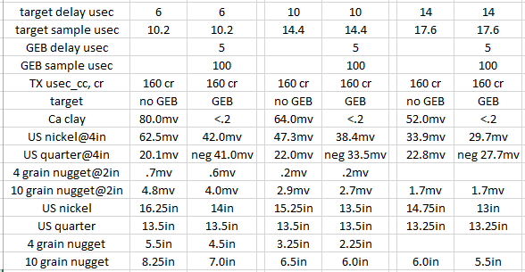

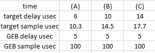

      Don't know about GPX4500. This is what I use. First delay is adjustable(6-20usec), first sample(target sample adjustable, used as ground balance adjustment), second delay(short 4 to 5usec), second sample(GB sample, fixed at about 100usec), EF sample time(second-first sample time)I take it just before Tx on. GEB timing.png shows settings to balance ground when changing first delay. Tx time, constant current or constant rate and probably others effect ground slope so changing either one could effect first sample time needed to balance ground.

            1) You say you adjust target sample width. How much (approximately in %) do you usually change it from the values stated in PNG file to reach GB in California? I will try with your method soon when the whether let me.

              The numbers in the PNG file are what was required to balance California ground. Ground from the back yard balances very close to if not the same settings. I'll try to answer some of your other questions later, need to do some yard work.

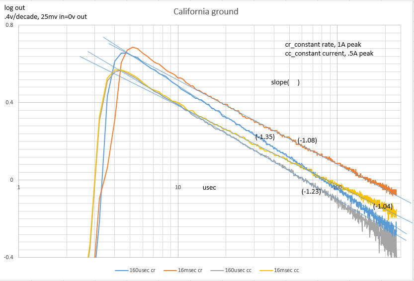

                    Couple charts I posted in other threads. TRT_21, example of ground slope changing with Tx on time with constant current Tx vs constant rate Tx, each would require a different balance setting to cancel ground signal. target delay_1, some data taken awhile back showing detection distance and integrator out volts with some different targets. GEB on causes distance loss because noise increases when the 100usec GEB sample is added. I use a(Rx, two 8inch round connected figure eight)(Tx surrounds Rx)reduces noise and ground signal. Don't think it would have different timings vs mono coil. I did bury a target in back yard 10inches deep to see if integrator out voltage was the same as air with GEB on adjusted to cancel ground signal. Little or no difference.
