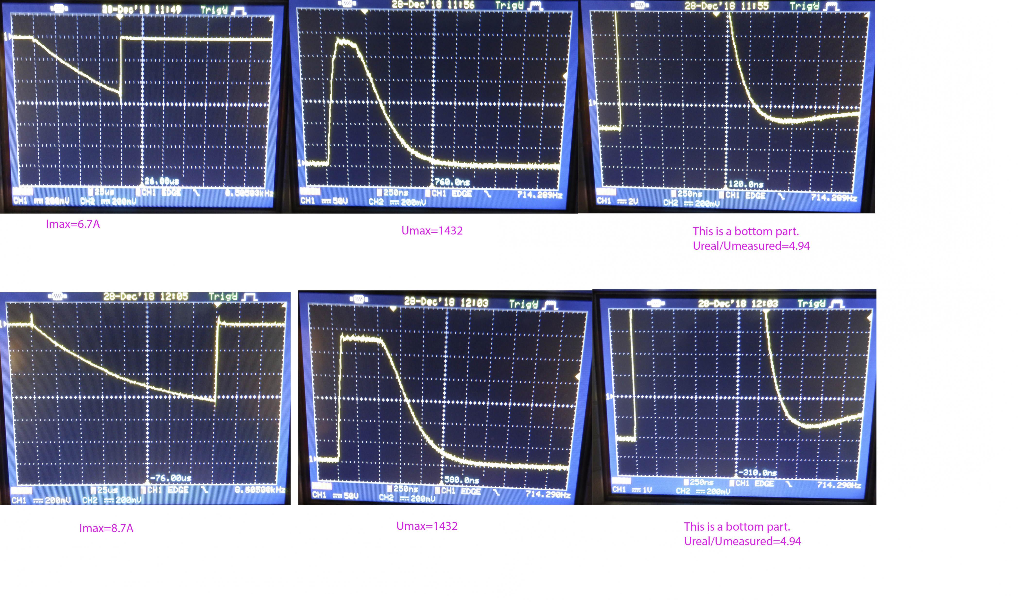

            So your TX charge voltage would be around 16V, to achieve 7A in 100us and 26V to achieve 18A in 200us.
            At 18A, the damping resistor would have to be about 55 Ohm to keep the Flyback under 1000V, unless there is heavy avalanche discharge.
            This seems to be a very unusual PI TX which would explain the unusual behavior. We would love to get more information about it.

                With Rdamp at 450 Ohm and 18A peak current, the Flyback would be around 10,000V. There must be something else that is different.
                Anything above the Mosfet voltage would be dumped through the mosfet avalanche diode. The current that is dumped through the avalanche diode does nothing to excite the target.

                  Forget tx voltages for a minute, can we see the coil current waveform? Current is king!

                    Below are my waveforms.
Name:	100us vs 200us.jpg
                    From the left to the right: Coil TX current, Flyback voltage, magnified bottom part of a flyback voltage. Ground contact of oscilloscope attached to Coil_VCC=15.5 V.
                    (R_d_coil=415 ohms. Coil current was measure across 0.3/4=0.075 ohm resistor. Coil voltage - along part of R_d_coil which is 84 ohms (415/84=4.95) )
